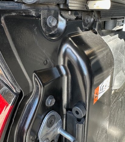

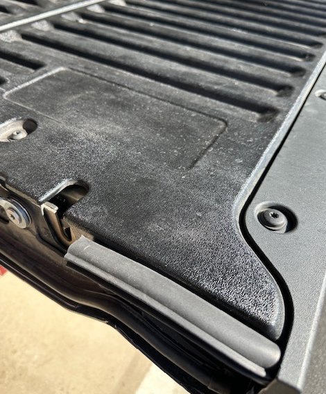

    I let the truck sit with the tailgate closed overnight and in the morning I could open/close (power) with no problems. Finished up sealing the sides and no problems with power closing. I didn't install it per the included directions. First I removed the tailgate so I could do the bottom seal with one piece. The instructions called for using separate 2" pieces on the left and right ends that looked kludgy.
    I didn't put the seal on the sides above the rubber stop bump because the way the show it, again it looks weird.
    The kit comes with a small strip of wide seal and a longer strip of narrower seal. The instructions call for using a cut piece of the narrow seal on the top of the tailgate. I used a cut piece of the wide seal there instead and that appears to seal that area making the need for the seal above the rubber stop unnecessary.
