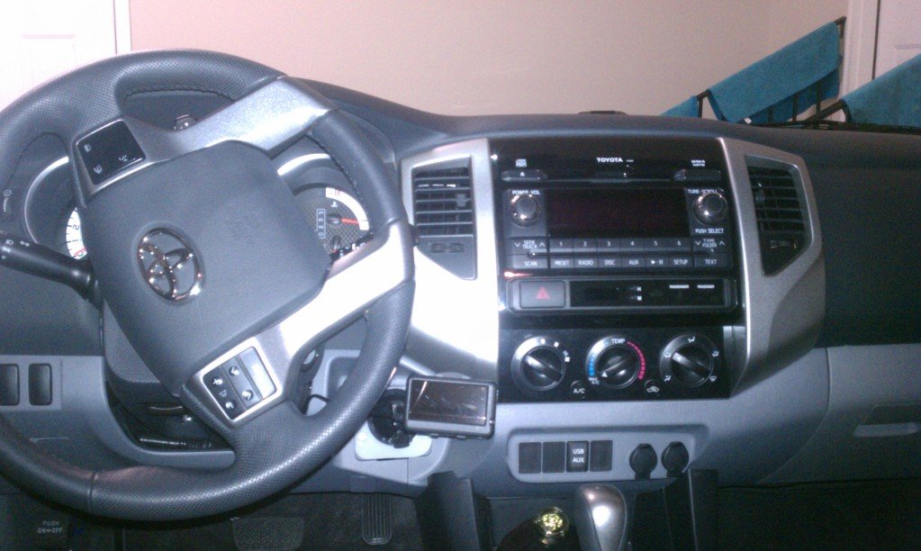

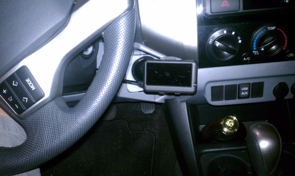

    Okay, so I figured out a good spot for the mount that didn't require the suction cup. It's out of the way and you can get to all of the buttons. It's also completely reversible, which is important to me because if I get tired of this one day, I don't want holes to remain in my dash when I remove it. It's simply a small piece of sheet metal bent at the correct angle and stuck to the dash with some 3M automotive double sided tape. I painted the home made bracket with some flat black paint and you don't even notice it. Check it out:

    And it almost hides those hideous Oakleys from view at the same time! LOL just messin

    Yeah those are my super cool surfer dude sunglasses (sarcastic). I know, I get enough crap from my old lady!!!

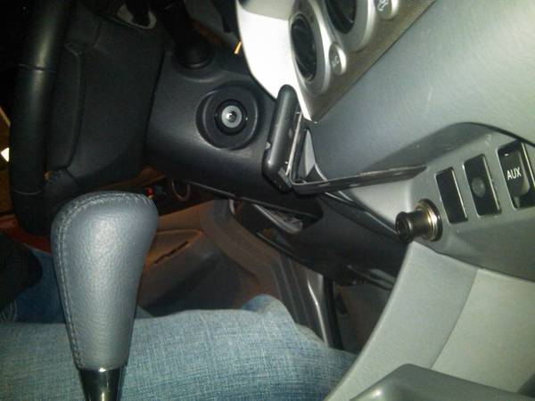

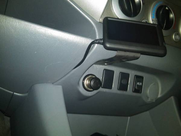

    Here is mine!

    Looks like a bottle of liquor in front of your cup holder!

    so thiiiiiiiis is what the 2012 look like inside... hmm:D:eek:

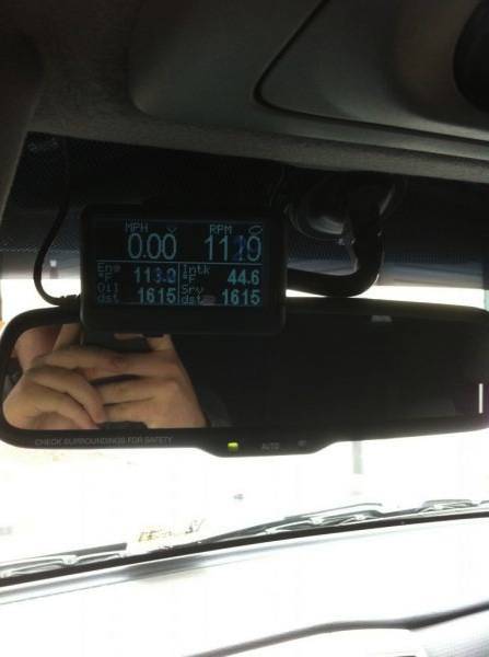

    I tried the bicycle reflector mount and it wasn't going to work with my mirror stem.
    Instead, I used a 1/2" U-bolt, 6 flat washers, 4 1/4-20 nuts, a few star washers, and a piece of 2" steel corner brace.
    Velcro-stuck the basic bracket to that.

    i like that one^^^^^

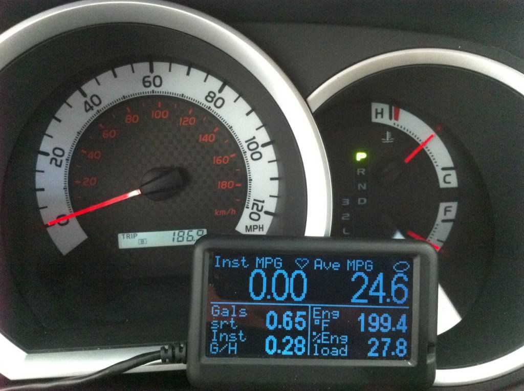

    Best Position for my use....

    Simple yet not elegant. Doesn't cover anything important and not out of the way to look at.
