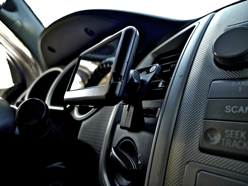

    Here is one mounted to the vent

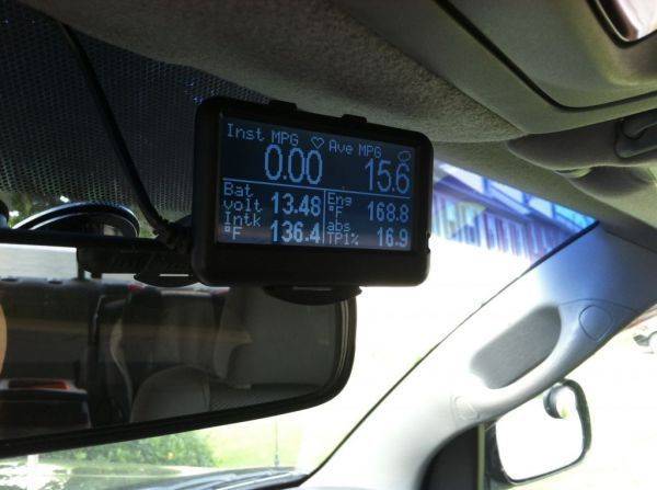

    Where I have mine. I suggest buying the swivel mount instead of the suction mount if you decide to place it here.

    I mounted mine about the rear view mirror and find it to be the perfect location.

    If you do decide to get one (if you don't already have one) there is just enough wire to run from where it is mounted, under the headliner, down the "A" pillar, and right to the OBDII port. I don't recommend the suction mount they sell. Not saying it's bad but I've personally never had really good luck with suction mounts and it is pretty big. I like the small size of the swivel mount and it works perfectly in that location.

    Took maybe 15 mins tops. 2 bolts on your A pillar and the cable runs right down to the port.

    Exactly where I mounted mine as well. Ran the cord inside the lip of the head liner, to the A-pillar (after I took off the cover, of course), and then down through the dash to the port. Looks VERY clean this way, IMO. Also used the swivel mount with adhesive base. Highly recommend this approach.
