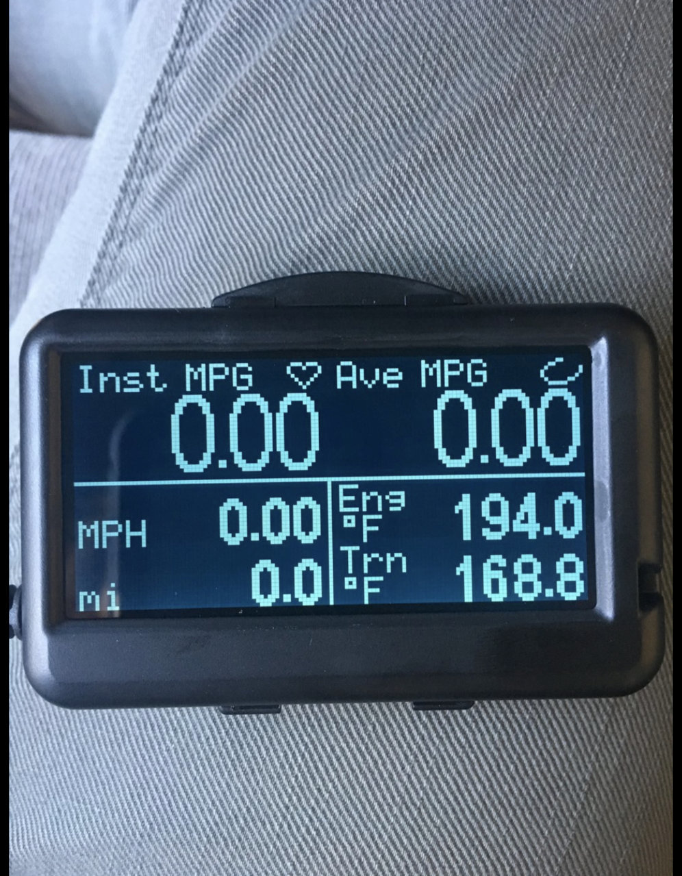

    I know you have a 2002 but my 2004 shows trans temp on my Ultragauge, just had to input a special code that I found through searching the forums here.

    check out this thread and you get all the info you need
    https://www.tacomaworld.com/threads/gen-1-2004-tacoma-ultragauge-mx-transmission-temperature.581841/
    I have it working on my 02 double cab with factory tow package.
