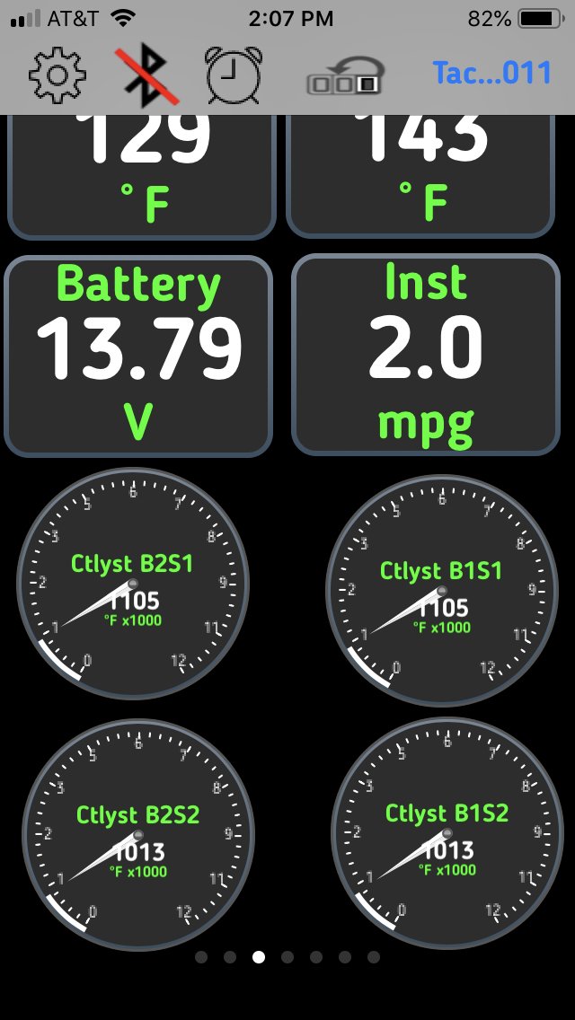

    Can anyone verify that UltraGauge Blue can be used to monitor transmission tempature on a 2013 Tacoma when doing a transmission service.

    Thanks for your quick response. Top of phone blocking the temp. labels. I'm guessing one is for the transmission.

    Yea I did a screen shot as I was running into work.
    I have it set up that Left is pan right is converter. Sorry.

    Thanks again, which gauge do you monitor for oil temp when checking transmission oil level?

    Mine is AT temp 1 on a tech stream
    Which would be the pan.

    You have to connect tc and te1 and do the secret handshake.
    So You can't really use it to moniter the temp and check fluid.
    Your check temp is 97° to 115°
