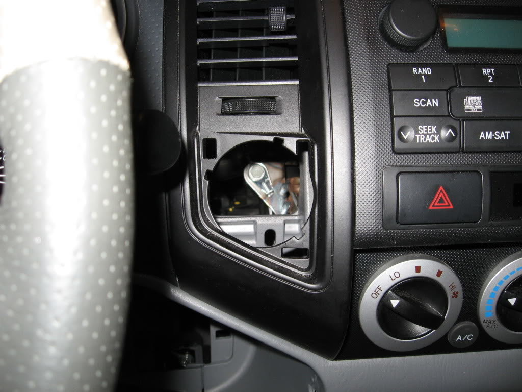

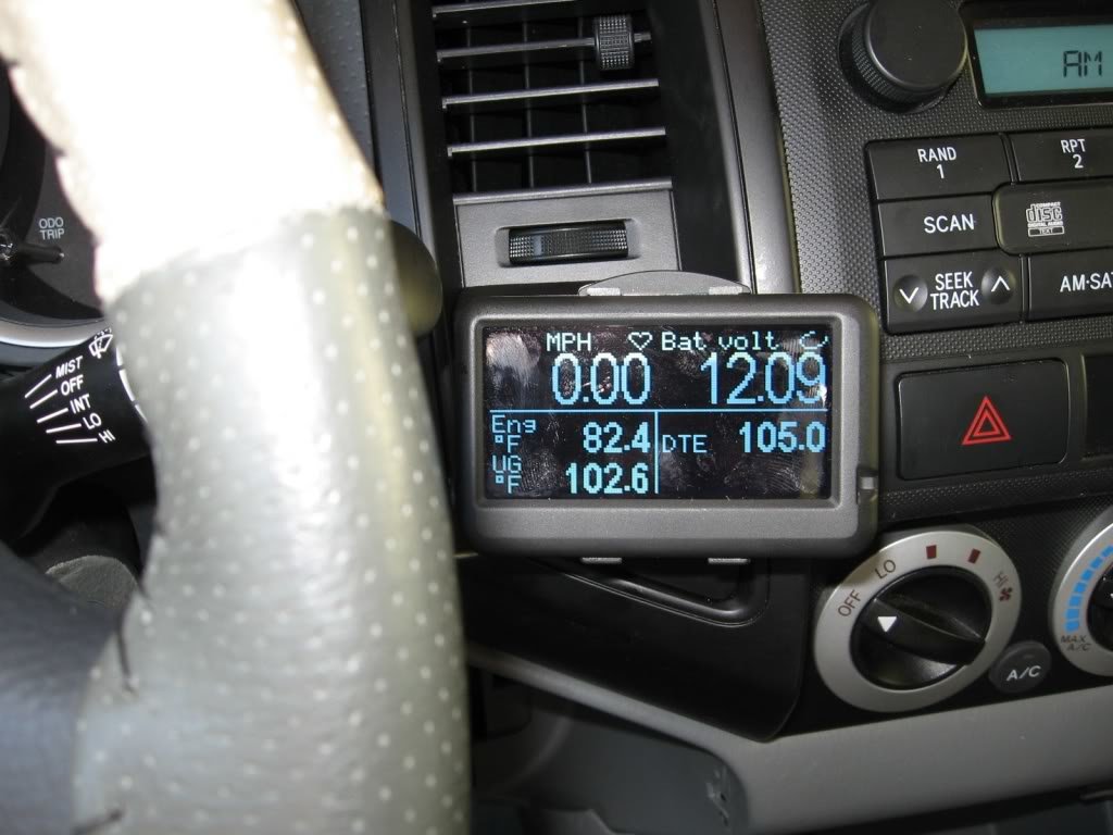

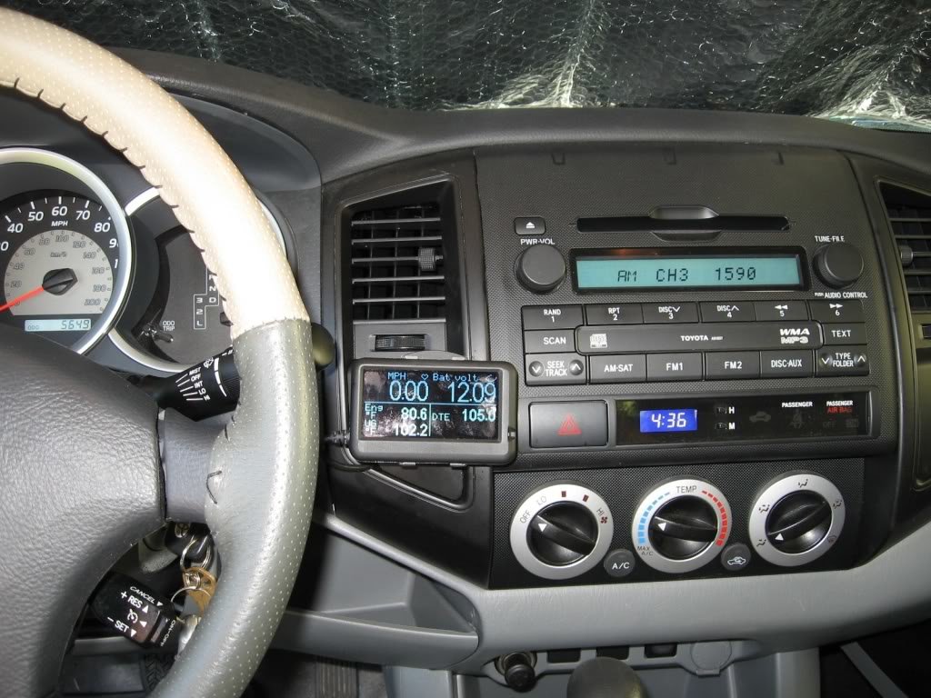

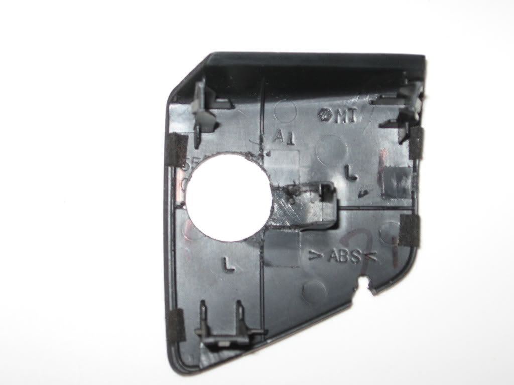

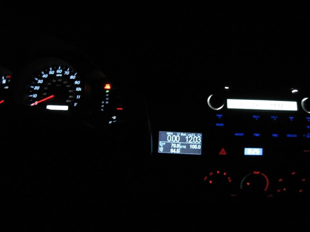

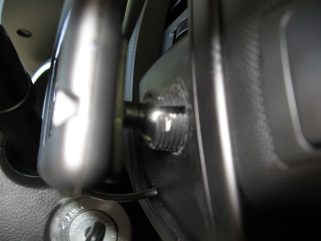

    This is a variation of Cubantaco's mount on p41 post #808. I used the cover below the vent to the left of the radio.
    I have a 2010 Regular Cab, so nothing is behind this cover and lots of room to fish the OBD II connector.
    The cover is easy to remove. I could remove it by pressing up and pulling out without any tools.
    I cut the stalk as Cubantaco did. The length does not matter because there is plenty of room
    behind the cover. I drilled a 7/8" hole with a holesaw into the cover near the top right so
    I could have a little more room from the wiper stalk. The hole was drilled from the backside right over the part number of
    the cover (55524-04020 L).I removed any protrusions on the backside of the cover with a small pair of dykes. I then drilled
    a 5/32" hole on the bottom of the cover for the cable and cut a relief with the dykes.
    I could not get the mount tight enought with the ring and still have play with the ball mount to adjust the Ultragauge,
    so I did not use the ring. I glued the mount to the cover plate from the backside.
