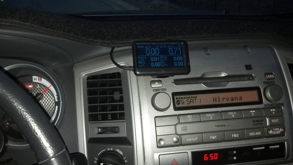

    It arrived very quickly.
    I ended up using velcro, the factory mount stuck out to far.

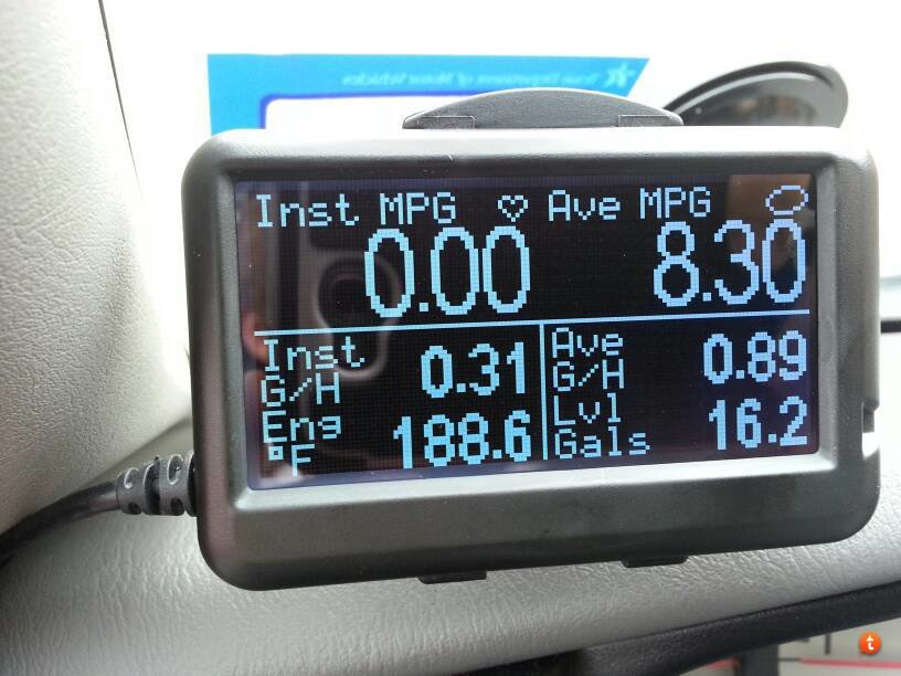

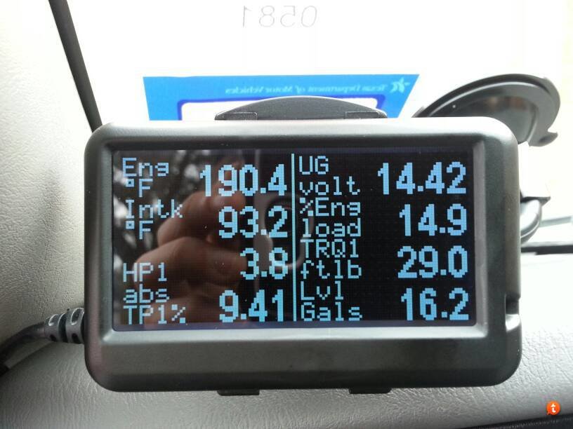

    Think I have my pages of gauges pretty much set up. Might add one more page if I get some good ideas from here. The first page is for normal driving, second is more geared to off-road. Didn't see any options for oil pressure/temp or transmission temperature, but oh well. Plenty of other options!
