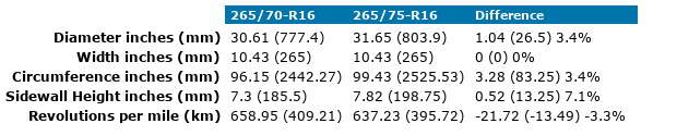

    I have tried over and over to calibrate my distance.. and for the life of me I can't get it calibrated right...I have used GPS..google.. everything and either I get 24mpg or 16 mpg..i used the tire calculator and for this :[​IMG]
    then lets say my distance is 3.8 miles ( per GPS) i multiplied using the percentage of circumference as stated before and i get a wicked number i know i didn't travel.. what am i doing wrong..

    on a side note : when I have done my MPG calculations by distance divided by gallons used I was around 17.4mpg but since my tire is larger now.. that isn't correct?

    Close to a freeway onramp, stop in a safe place and zero your cars trip monitor.
    Go into the menu and reset the trip gauges (MENU>gauge Menu>zero all trip) then exit the menu back to main gauge page.
    Drive onto the freeway and go as fast as you can without getting ticket past one or two exits (at least 3 miles).
    Exit the freeway and find the first parking spot you can.
    Go back into the menu (MENU>Vehicle setup>calibration>calibrate distance).
    look at your cars trip monitor and times it buy your tire size difference.
    Let's say that is says 3.86, times this number by your tire size difference (3.86x1.034=3.99) and enter it into the distance spot in the ultra gauge (up and down keys to change values and menu to save)
    Hope this helps :)
