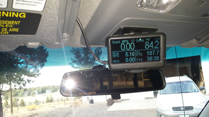

    Obviously I am no great photographer, but here is where I put mine. Took me longer to think about placement than it did installing it. I was able to route the cable to the left of the OBD port, above the kick panel, up the A-pillar and above the visor. The cable just tucked behind the weather strip and moldings and isn't visible. Now I just need to figure out the settings.
    This was done using the horizontal mounting bracket. I can still use the sunglass bin without any problems.
