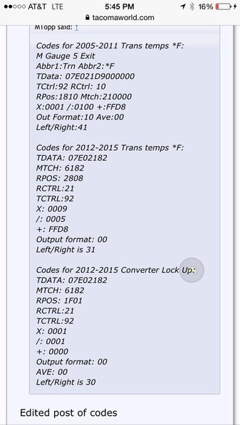

    Got mine yesterday and programmed it today. The programming was fairly straightforward. I'm now seeing tranny temp. This is great, as I want to keep an eye on it as I tow our popup! I am getting err. on the torque converter lockup status. Anyone have a fix, or can point me to the posts that address it? Thanks! Love the UG.
    Have instantaneous mpg, coolant temp, avg. mpg, batt voltage, tranny temp, and torque lockup on display.

    It's a never ending $100-$200 a week thing & still going.
    Here are the program codes.

    Thanks Bogginator! Kept digging and found them in post 378 of the UG Tranmission Temp thread.
