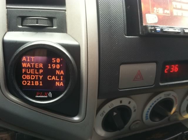

    bought a brand new ultraguage. and now my screen looks like this. it wont let me flip through to different screen settings no matter what i press. and it keeps restarting constantly, only to return to this screen... it doesn't even beep when buttons are pressed.

    There is a bug in the UltraGauge EM 1.2 which will result in a garbled display when the current page is changed. Typically this happens when changing the page to page 6 or 7. Once garbled, UltraGauge will then reboot after ~16 seconds. At this point UltraGauge will continue to reboot every ~16 seconds.
    To restore UltraGauge, please follow the procedure below.
    The bug is caused by unassigning a gauge. For example, if RPM is assigned to zone 1, and this assignment is removed by changing the zone for RPM to blank, the display will become garbled next time the page is changed.
    Avoid this issue by not individually unassigning gauges.
    Please note that it is not necessary to first unassign a zone before assigning a new gauge to that zone.
    For example, If Zone 1 is set to RPM, but you would like zone 1 assigned to MPH, simply assign MPH to zone 1. This will automatically unassign RPM, without issue.
    If you would like to leave zones unassigned to make the display less populated with gauges, considering changing the gauge display format to display 4 gauges instead of 6.
    If you must unassign a gauge, the "Unassign All Gauges" command can be used. This will unassign all gauges on all pages and then new page/zone/gauge assignments can be made.
    MENU --> Gauge/Page Menu .. --> Select Gauge/Page --> Unassign All Gauges
    Restoring a garbled display:
    1. Unplug UltraGauge
    2. Set the ignition to the RUN position
    3. Press and hold the MENU key.
    4. Plug in UltraGauge.
    5. Wait 5 seconds, Release the MENU key. The MENU system will start.
    6. Select UltraGauge Setup.. --> Restore ALL Defaults.
    You will then be prompted to confirm. Once confirmed UltraGauge will reboot and begin Scanning for the interface and protocol used. Once found UltraGauge will begin Gauge discovery.

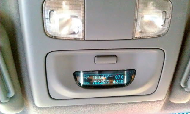

    Never had an issue with my UG but good to know the re-boot procedure. I no longer have the UG in the truck switched gauges.
    The UG gauge before the switch:
    New Gauge:

    What exactly is that you did there?

    Thanks. Nice product, but @ $249 it's also hell-of-a expensive. :eek:

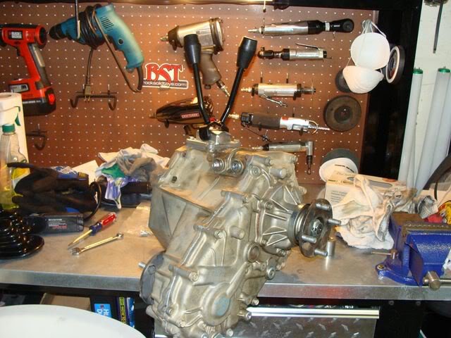

    You can shift the transfer case manually with the twin stick. You still need something for the front diff though.

    Something like this, I presume:

    Yes, but his looks a lot nice. He also didn't use a FJ case.
