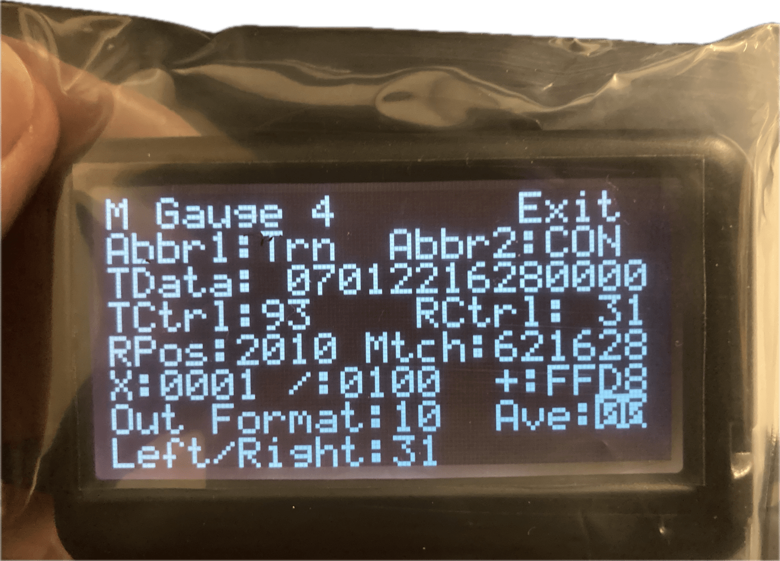

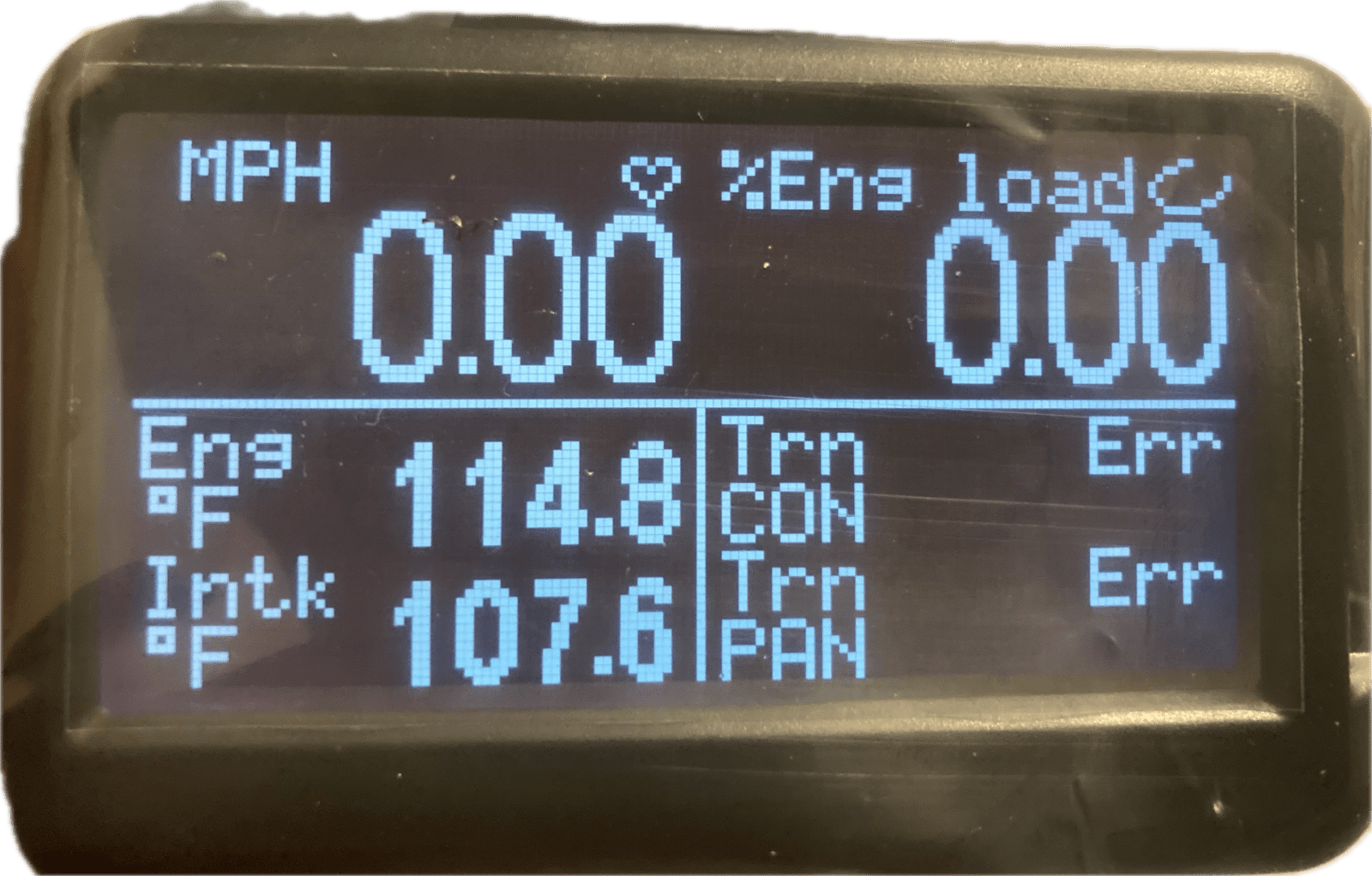

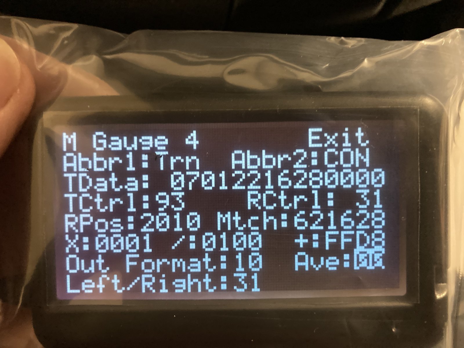

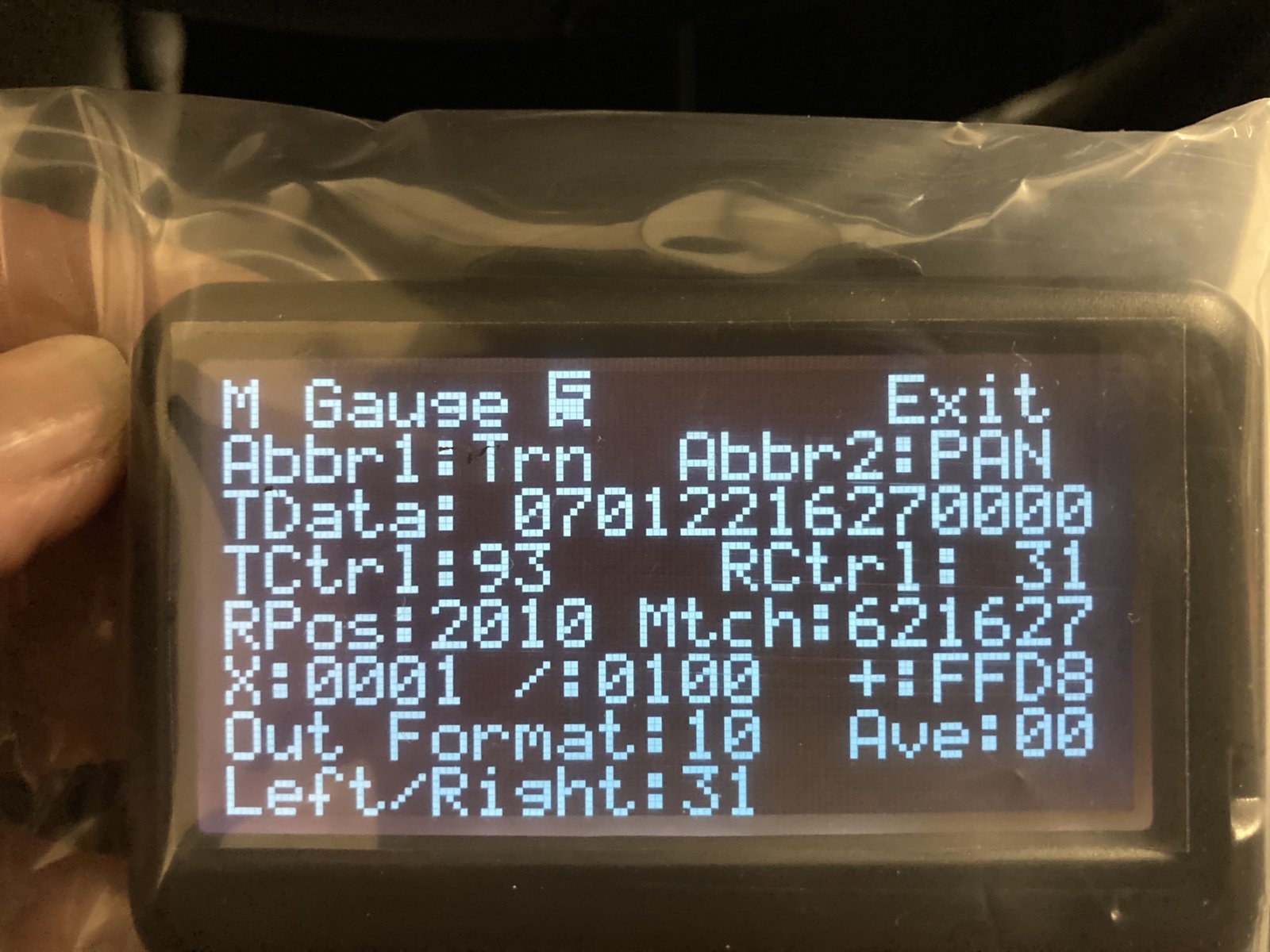

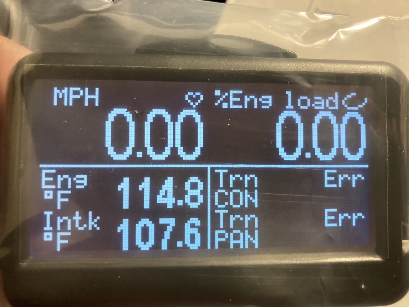

    Hello gents. I just purchased my third tacoma, a 2023 SR 2.7 4x4 AT, and am trying to set up an ultra-gauge for the first time.
    The ultragauge is an MX v1.4. My troubles regard transmission pan and torque converter readings. I’ve perused both the manual and mx supplemental manual for Mgauge features but am at a loss. I’m still seeing “Err” for both readings.
    I have input the following:
    Thoughts?

    2
    False alarm!
    I reread the thread and used @ancient11 's wisdom from post #54 to get it working.
    If you have a 3rd Gen 2.7L, try the 2nd gen codes.
