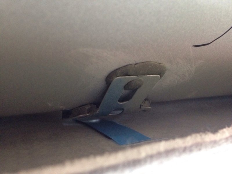

    This spot worked out pretty good for me. I used an old thin piece of metal and drilled a small hole on one side and used some of that steel putty stuff and stuck it to the spot behind the temp gauge. I'll try and get some pics of how I did it tomorrow while at work.

    Found a bracket that came with an old cheap HID kit. Just bent it to shape and roughed up the paint with sandpaper. Mixed up a small amount of steel weld putty and let it dry. I had to bore the small hole out enough to fit the small screw through. But worked out great! No movement or vibes.
