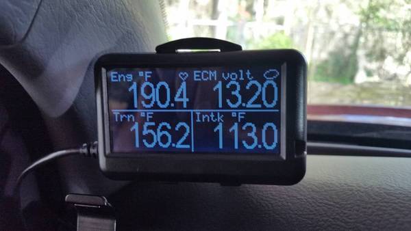

    Finally got it working....for some reason I had it as Mgauge 2 instead of "5". Appreciate all the work the OP and others invested in this project.[​IMG]

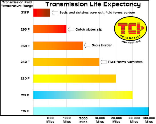

    Day 1 driving with Mx 1.3 w/Trans Temp.
    Vehicle start 10am: Coolant temp and trans temp were at same temp, 64deg inside garage.
    First task was towing a ~3000 boat & trailer 25 miles. Downhill the Trans temp stayed in the 140 deg range. Once onto mostly flat terrain the trans temperature jumped to 155 - 170deg. Starting from a stop, the temp would immediately pop up to 180deg until the vehicle was back at cruising speed. temp would drop back down to 170deg or below.
    Dropped off boat and trailer and then drove 12 miles on flat same roads. Transmission temp would hover at 140-150deg.
    Now that I am watching the transmission temp, it is useful to understand the numbers. I found this chart useful, it was posted on TW in the towing section under 'what are you towing'
    Here is the link to article original: http://www.tciauto.com/tc/trans-life-expectancy/
