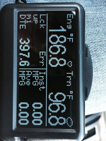

    Got mine in and mostly setup. I had to reprogram for the '12+ version. Does anyone know how to program the tq converter lockup to work?

    So here's what I observed:
    Trans:
    150-180 seems to be normal operating range in cooler (30-40 deg) weather when towing. It did hit 190 once on a long gradual incline but then dropped back off. Even towing 21-2200 lbs, 4th is 20 degrees cooler than overdrive.
    Engine:
    190-194 is where coolant temp stays regardless of any factors.
    Mileage:
    Instant mpg shows that when towing, 4th is significantly better than overdrive for all situations except downhill. I stayed pretty consistently at 70 and played with watching what happened going from 4th to overdrive. Trans temps go up immediately and mileage goes down.
    Overall, I am very happy I bought this thing. It is totally worth the $100 I spent to be able to monitor trans temp. DTE feature is nice to have as well. The avg mpg feature is not super accurate, but it's pretty close. I've been using the windshield mount and it works great, but I am going to mount mine with Velcro on the hazard switch I think. I like that spot, it's not on my windshield and is easy to reach. Thanks for posting this tool. Without TW, I wouldn't have found or considered it otherwise.

    the question is... what temps are you looking at.
    There are 2 temp probes in the trans... you want to monitor the PAN temps... not the torque converter output temps as the latter is artificially inflated due to how the torque converter works and position of the temp probe.

    I don't know which it monitors, but I would be willing to bet simply based on how quickly the temp changes that it is the converter probe. But...if it is the hotter of the two and is still no warmer that 190, I'll take it.

    I was literally watching the instant mpg function. Pretty neat stuff.

    I still haven't gotten mine do display that one. It is one of the gauges I put on the first page but I get the error message. I'll have to dig around and see if I can find the right code for it.
