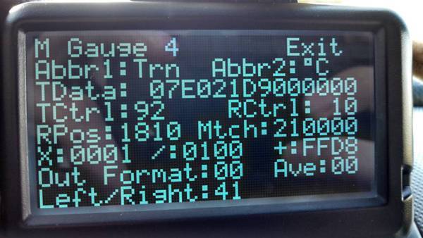

    My Mgauges from my 2005..not tested to see if functioning..trans *F is..

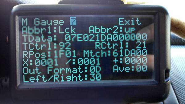

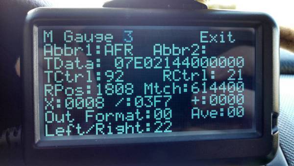

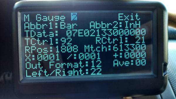

    Posted up TWer's

    The Output format for the 2012-2015 Trans Temp *F needs to be 10 not 00. At least I needed to change it to get it to convert to *F. I'm assuming it was reading *C because it never went over 77*. I made that one change in the code and it instantly read in *F.
