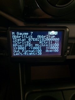

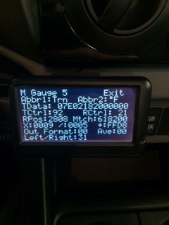

    I'm programming the codes based off of the data I see posted here in this thread. Specifically, I am using the following for trans temp :
    Codes for 2012-2015 Trans temps *F:
    TDATA: 07E02182
    MTCH: 6182
    RPOS: 2808
    RCTRL:21
    TCTRL:92
    X: 0009
    /: 0005
    +: FFD8
    Output format: 00
    Left/Right is 31
    This gives me a readout of about 119 when starting up the truck.
    Pic of mgauge programming display :

    119*f when starting the truck is way to tall. Trans pan temps should be pretty much at ambient / water temps right at start up.

    That looks about right. My starting temps hover around 120 - 130 degrees
    I've never seem my temps below 120, even at start up

    Then the UG is reading temps wrong. After sitting over night the engine temp / trans fluid pan and torque converter fluid output temp should all be nearly identical and close to ambient.

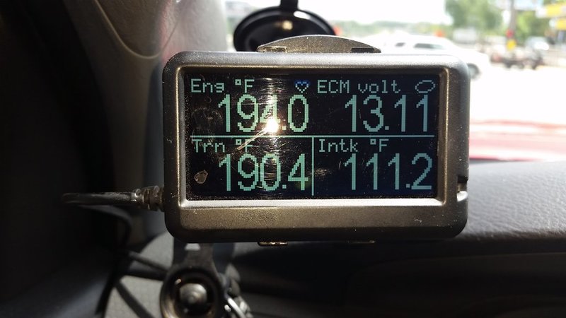

    It can also get a lot hotter than 160.....and the 190 shown above happened with a tranny cooler

    Concur. I just took a 5 hour trip. I wasn't hauling anything. Outside temp was HOT (in the mid to high 90s). Intake temp was reading over 100 on the highway. Transmission temp was between 170 and 180 most of the way. Reached a high of 186.
    I'll be hauling a small trailer on the way back. I'm expecting to see some higher temps.
