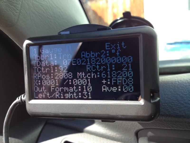

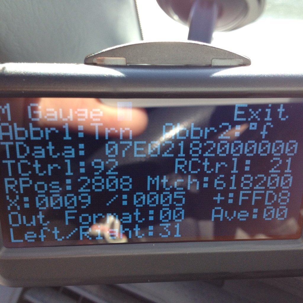

    Yep, temp is F. I have the output Format in the parameters set at 10. And yes I went through the whole vehicle setup. I thought it was low also, but it is all highway, it is only in low 40's here and still raining. When I pulled off to go to Starbucks before work, it does creep up to 135-144.
    the only thing I changed was the X:0009 /:0005. +:FFD8 to this X:0001 /:0001 +:FFD8.

    Yea, I am pretty confident that these parameters are the correct ones, as with the first set I tried, the trans temp was way too high. I feel with these parameters now, the Trans temp is more like consistent with everyone else is seeing.
    Thx for all the feed back
