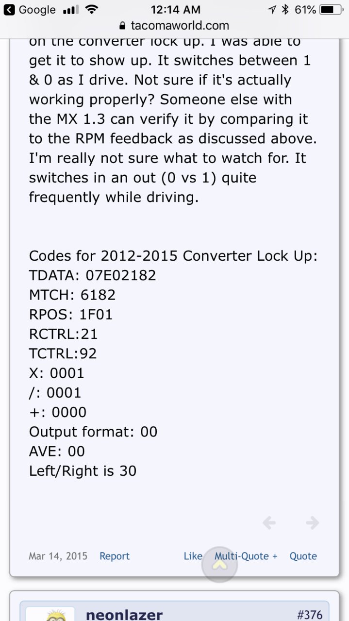

    Anyone know the code for the torque converter lock up/unlock(3rd gen) to display on the UltraGauge MXv1.3? I’ve searched and only found it for 2015 and prior. I tried that code and it still shows “err”?

  12. May 19, 2018 at 7:19 PM
    #612
    jpereira2
    jpereira2 Well-Known Member
    Dec 20, 2013
    #118928
    6,362
    Jason
    Massachusetts
    2013 double cab trd off road
    Bilstein 6112 4th notch Bilstein 5160 rear Camburg ball joint UCAs Old man emu dakar leafs 265/75R16 Cooper ST Maxx Crux stereo a/v interface UltraGauge ARE fiberglass cap Wet okole seat covers Retro fit source Led fog lights Superbrightled pods in rear bumper Superbrightled light bar in grill Rock blokz mud flaps SOS Rock Sliders RCI Skid Plates (to be painted and mounted)
    Can you send me the info for that one lol I need it

  15. May 20, 2018 at 2:32 PM
    #615
    jpereira2
    Dec 20, 2013
    #118928
    6,362
    Jason
    Massachusetts
    Thank you sir!
    DoorDing and YotaMan[QUOTED] like this.
  16. May 20, 2018 at 5:42 PM
    #616
    nasaengr
    nasaengr Well-Known Member
    Nov 6, 2012
    #90609
    193
    Red15 DC OR
    Converter lockup info is worthless. All it means is that the trans is in an odd number gear (1,3,5). I found that sitting still at a red light, with the trans in 1st, lockup says "1". Impossible. I do not monitor this anymore.
