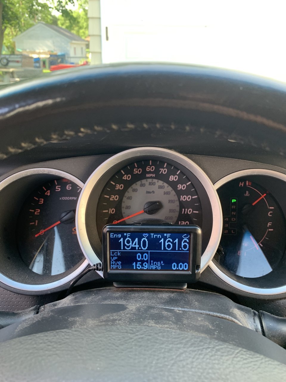

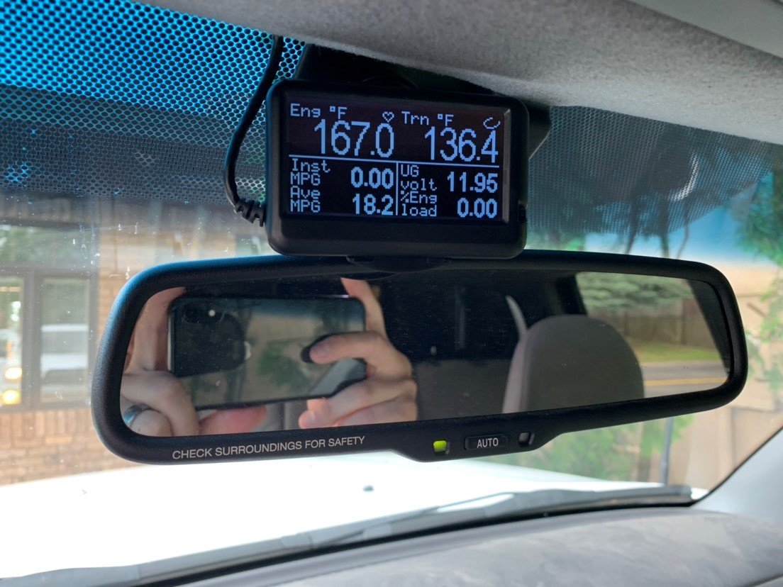

  20. Jun 28, 2019 at 5:50 AM
    #640
    nemesis17592
    nemesis17592 Well-Known Member
    Apr 28, 2017
    #217568
    181
    Nate
    Comstock Park, MI
    2010 Tacoma DC LB SR5 4x4
    I got mine Mounted the way I want it. The lockup gauge works but I have I can only see using it while towing, and I don't often. gauge.jpg
    CITY TACO likes this.
