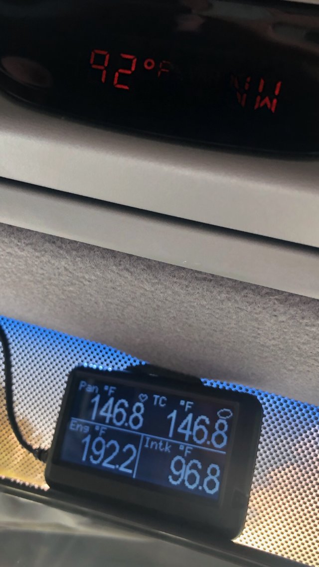

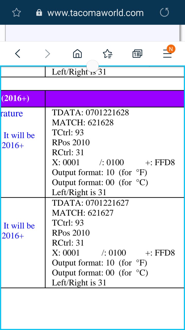

    My ultragauge is 4 or 5 yrs old too and just got trans temp today after previous failed attemps. Used the code posted in this threadScreenshot_2019-06-29-15-31-27.jpg

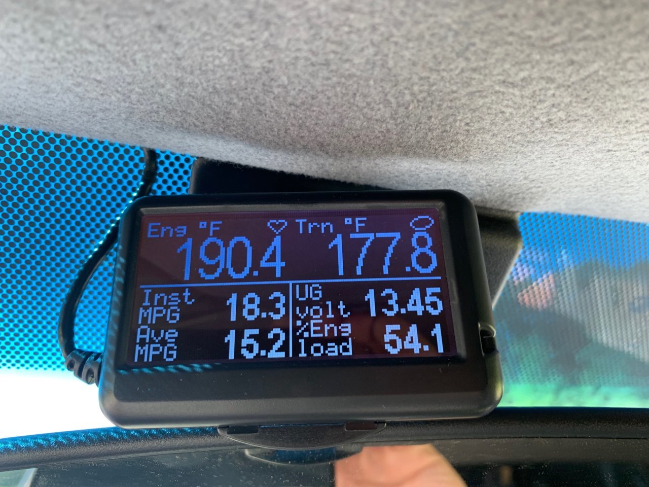

    25E38471-AAE9-46C2-8115-D7C997D06655.jpgThese temps are towing about 4000# on a hot day uphill . Typically lasts about 20 seconds or so depending on the hill before going back down around 180 give or take a few degrees . The codes from the UG site are for the TC I believe which is a little hotter than what the rest of the transmission runs at . There are codes available somewhere to get your pan temp .I have the Hayden aftermarket HP trans cooler installed .

    The Trn temp is the Torque converter . I think the other code will say PAN . Going off memory here ,it’s been a few years since I installed the UG
