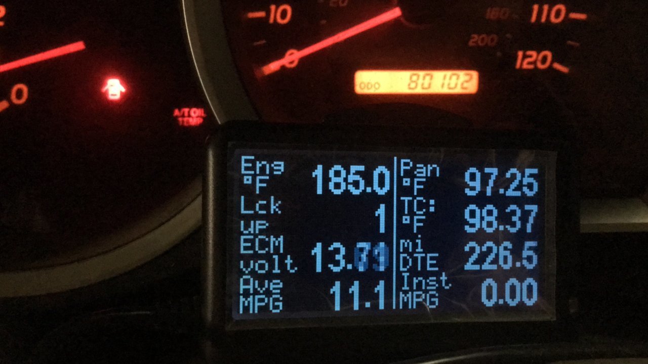

    So which temp is used to make sure the trans is at the proper temp when doing the trans drail/refill? Trans Pan Temp or Trans TC Temp?
  6. Jun 16, 2021 at 11:26 AM
    #686
    07 sport 4x4
    07 sport 4x4 Well-Known Member
    Dec 24, 2010
    #48165
    1,453
    Blake
    Southeast
    2017 Duramax
    Pan. You’ll find that they run really close together though. My 07 would always check at 97-115°F. 0151CF4E-ADFE-4D1D-A078-01ECAF5CA2B0.jpg

  7. Jun 16, 2021 at 12:08 PM
    #687
    boogie3478
    boogie3478 Well-Known Member
    Oct 12, 2014
    #140179
    26,396
    14 TRD Off-Road V6
    All the mods
    Awesome thanks!

    It comes down to fluid breakdown related to temperature. Search out "Gearcruncher" posts on this. Generally speaking 170F is the ideal temp - does not degrade fluid but is hot enough to boil off condensation. Max temps will be seen in the torque converter. You should monitor both. TC temps can easily be 40F higher than the pan when the lugging the motor - which is really easy to do. Shifting to 4th will lock the tyranny at higher speeds prevent the TC from driving temps. I find that if I am on steeps or lugging the engine, choosing a gear that keeps the engine in the 2500 RPM range keeps the TC temp from running away. The pan is a bulk fluid measurement it lags the TC temp.

    Unless you have some hell big added tranny cooler- I think your 100F measurements are very suspect at normal operating conditions. If real, those temps are actually too low and you should look to raise them.

    This was while doing the temp check procedure to check the transmission fluid level. The engine gets up to temp much faster than atf does.
    He asked about pan and tc temps in relation to doing the temp check procedure....

    So to follow up 97-115°F is the correct temp range to check the trans fluid level from the overflow plug?

    Yes. That was the case for my 07.
    I know that the 5th gen 4runners with the A750e/f transmissions check between 104-113°F.

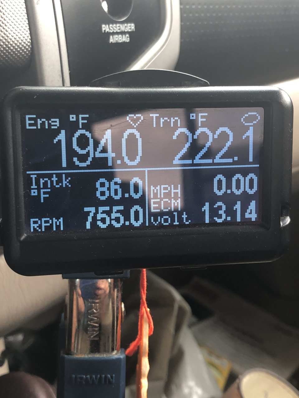

    Towing the camper on flat highway .

    Towing the camper up big mountain . Obviously after I pulled into a gas station.
