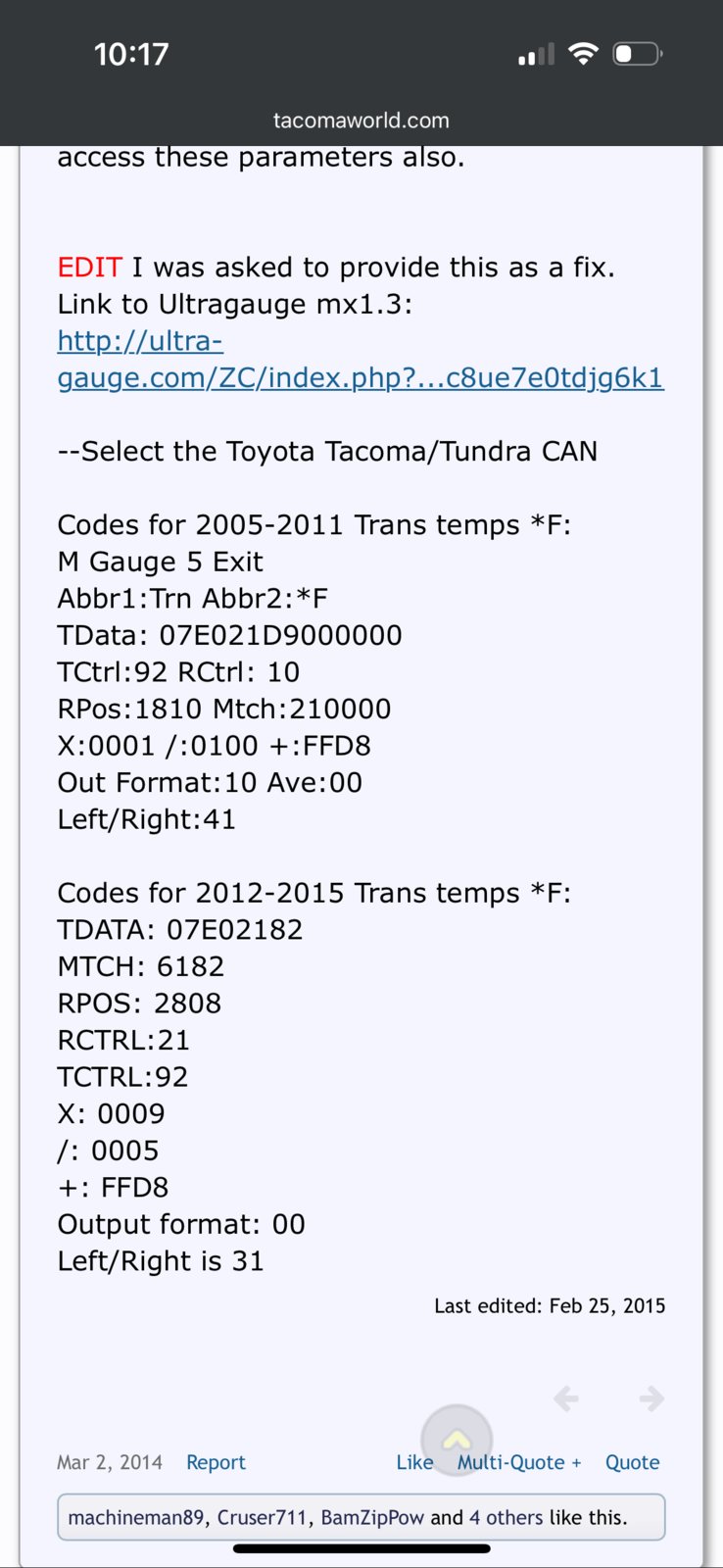

    Having a difficult time figuring out UG. I have a 2010 Tacoma and ordered the mx1.4 which should come pre programmed for trans temp. But I double checked the numbers for m5 and they match the pic below but still getting “error” when it tries to read. Is there something I’m missing?

    I don't know how much the UG models have been updated but in 2020, I used the codes in post #681 for trans and converter on my 2010.

    Sweet I’ll give those a try and hope for the best!
