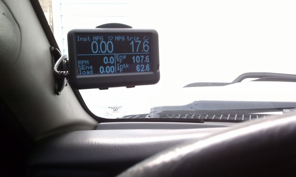

    Heres mine on the A pillar:

    Looks good. How did you feed the UG cable down to the OBD2 port? I wanted to do that but the OBD plug is so large, I couldn't see how to feed it without dismantling the dash.

    I pulled the A-pillar cover off and ran the wire behind it. If you pull the A-pillar cover off, you'd only have to cut a small notch at the front, where it meets the windshield, to run the wire into it and fish the OBD II plug behind the dash or between the dash and the door. Sometimes you just gotta be creative with hiding your wires, you shouldn't have to tear your dash apart, just remove the a-pillar cover.
