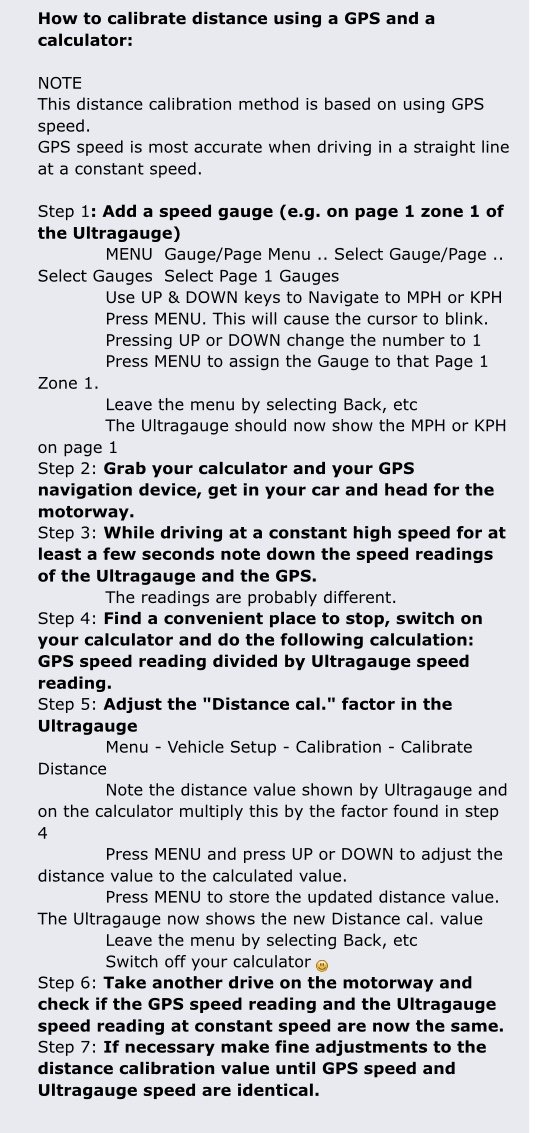

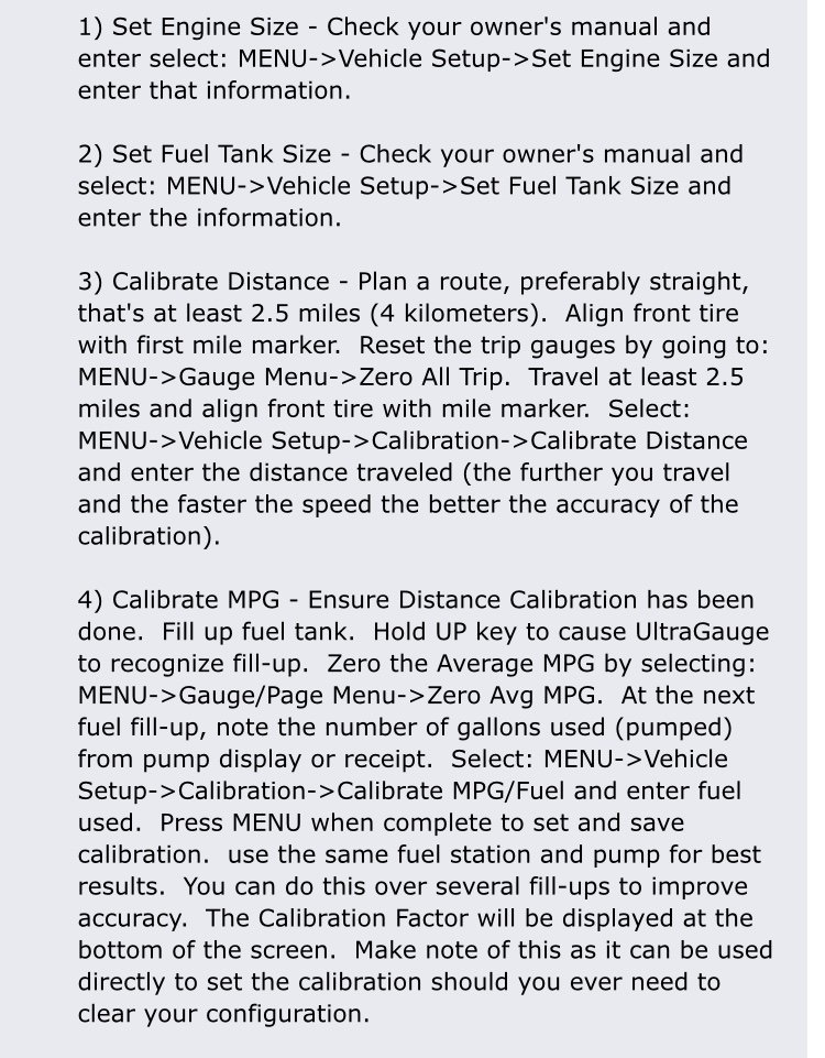

    Also important to note. For mpg readings to be accurate, you will first need to calibrate distance. And then calibrate mpg. Screenshot below are the procedures from ug. I calibrated my distance a different method using gps. See second screen shot for that method.
