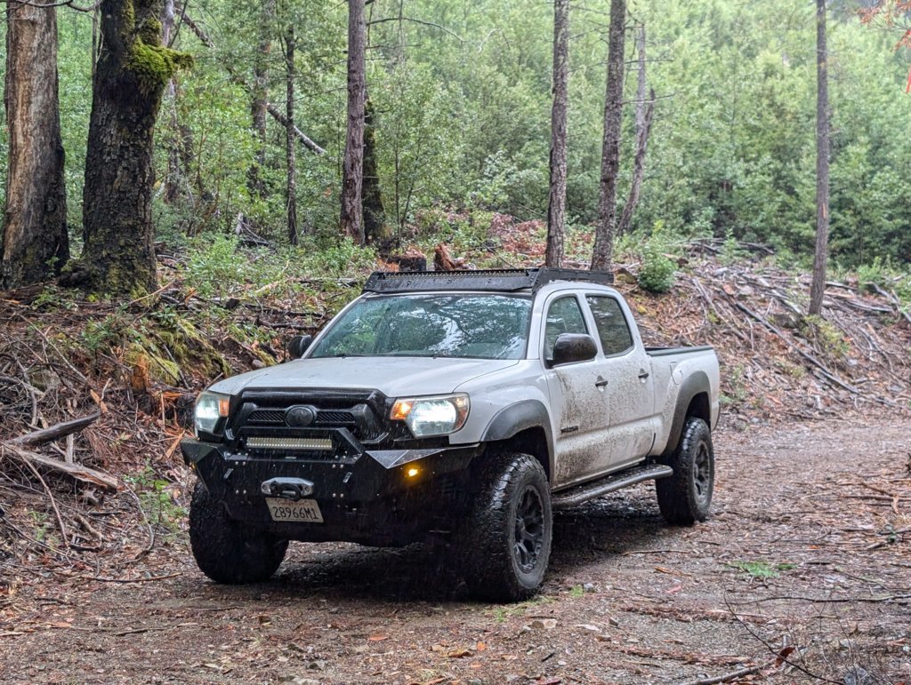

    The mesh pieces on the edges of the bumper where the fogs are located have a metal mounting bracket for a single post fog light. I recently made a lexan piece for my fog lights that replaces the mesh pieces, but it angles mine a bit too much. I have liked the bumper though.

    So no regrets then? For fog lights do you wire the included lights in the same manner? Sorry, I’m new to doing mods and the electrical stuff is what gets me nervous.

    I think it's a great bumper especially for the price. I have a 12k Badlands winch and have used it to pull out two people so far. The lights it comes with will likely not have the same connector as the stock fogs do, but it's just two wires. Lots of good info on here too. I wired in a new harness for my fog lights so I can turn them on and off whenever I want.
