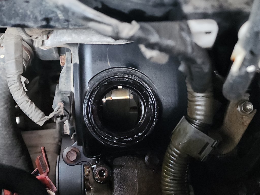

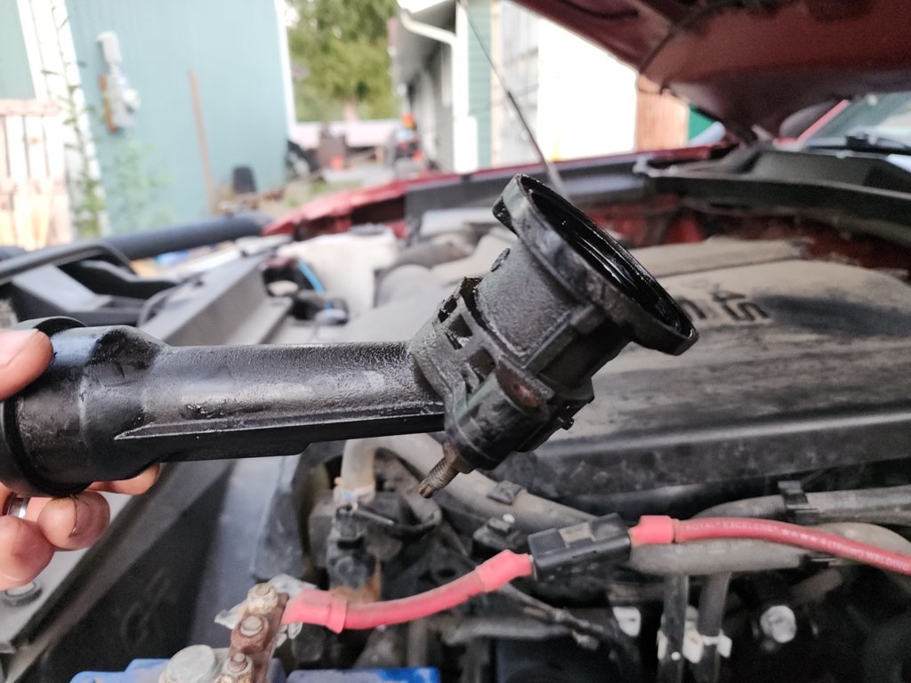

    So, this happened today...I think my battery was loose and knocked my oil filler funnel thingie clean off my engine block! It's currently my work truck and need it running ASAP.
    Has anyone ever dealt with this? Replaceable? JB Weld it back on??

    The oil cap will screw right in.

    ^^^ just put cap back on and use a longer funnel for oil changes from now on. toyota just glued an extension onto an existing valve cover for the tacoma application. dont worry your not the first to break it off

    I think the bigger question is why was your battery bouncing around in there? Fix that before you do anything else IMO.

    Fix the battery tie down and buy a new filler neck after that, easy fixes.
