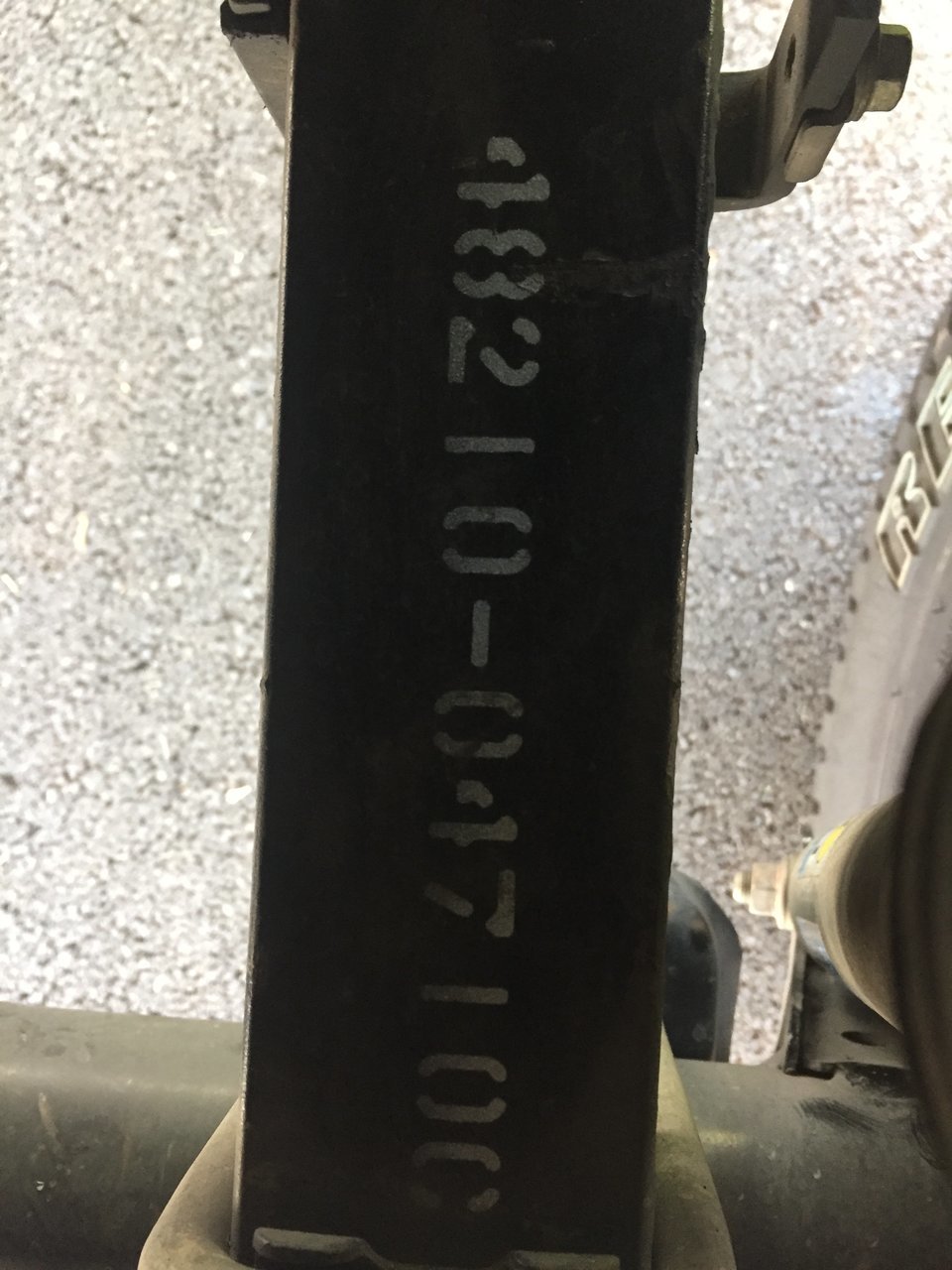

    So a buddy of mine came across a '16 Tacoma Sport, DCSB automatic, stock height that he is baby sitting for a bit. Between dodging incoming missiles/spurious incoming missile alert, I had the opportunity to do some comparisons. His had just been undercoated, and the shocks got some overspray but they appeared to be the green Hitachi ones. I'm guessing that is stock, right? I did some comparison with his front coils, they are more tightly wound/closer spaced coils, and are a dull/matte black color, also seem to be a bit smaller caliber wire than mine so to speak. Mine are more widely spaced between the coils, very glossy powder coating, and slightly thicker wire though I didn't mic it at the time. Maybe next time.
    Also, measuring the top of the bedrail in the back, mine is about 54" from ground height, while his is barely 51" in stock trim. Not sure how I got as much lift in the rear out of a 1 3/8" lift block, but my leaf springs do look to be stock. Are there any particular markings on the stock ones that could tell me if they are indeed stock? They have the same number and configuration of leaves, so they look just like his. I wiped off some dirt and found a "+" sign in white paint, and there was a green dot on one of them. I will try clean off the dirt and photo them and any identifying features, maybe tomorrow. I seriously doubt I have any sort of a body lift on it.

    I have sought to obtain further objective data between my lifted '16 Sport, and a stock '16 Sport and provide it, rather than random subjective opinion. They are both DCSB and are identically loaded. I have found that my leaf springs are indeed stock. They are imprinted with the stock PN under the dirt, after I washed it off. This is the part number for the stock passenger side leaf spring.

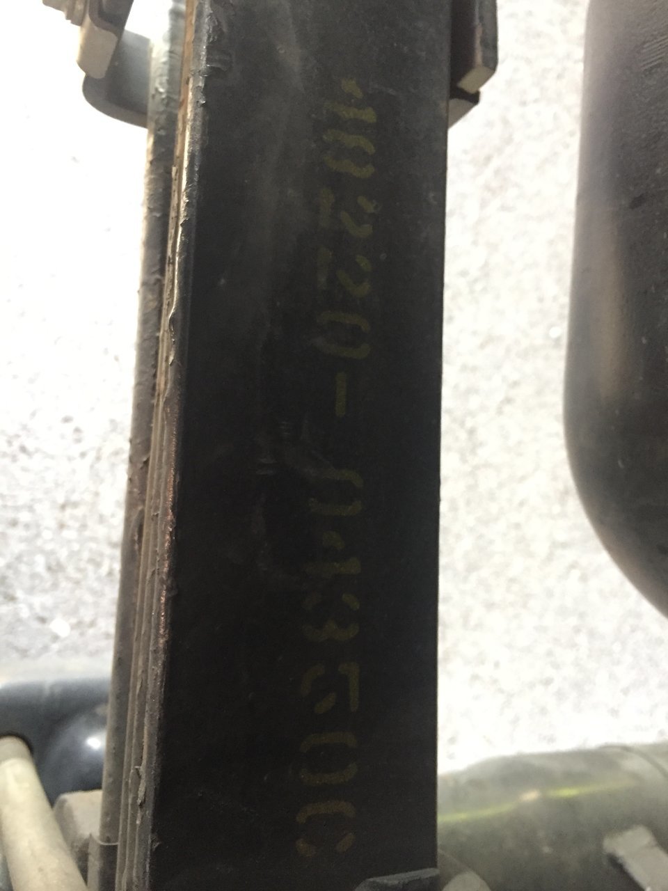

    This is the OEM part number for the stock driver's side leafspring below.

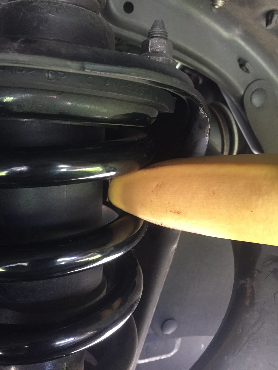

    I have mic'd the diameter of my front coils, and have banana for scale to demonstrate the coil spacing. First photo is of my unknown manufacturer aftermarket front coil, the diameter of the wire is 0.655" The coils are more widely spaced than the OEM, and both of these '16 Sports are "unloaded," so with everything else equal, here is how they sit. The first photo with the shiny coils, is my Tacoma, with the non-OEM, more widely spaced springs.

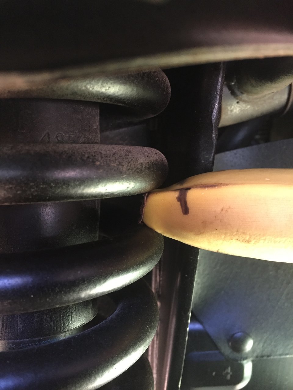

    This (below) is the appearance of the stock '16 Sport front coils, the banana for scale does not insert as far into the coil spacing, and the black line on the banana represents how far the banana went into the coils on my aftermarket spring. On the OEM spring, the wire diameter is 0.703" so it is actually a little thicker than the aftermarket spring of unknown brand on my Sport. And you can see the OEM spacing is much tighter between coils.
