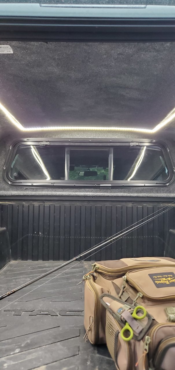

    I just ran an extra wire from the battery along the drivers side frame rail. Added switch's in the bed. 20200604_201444.jpg
