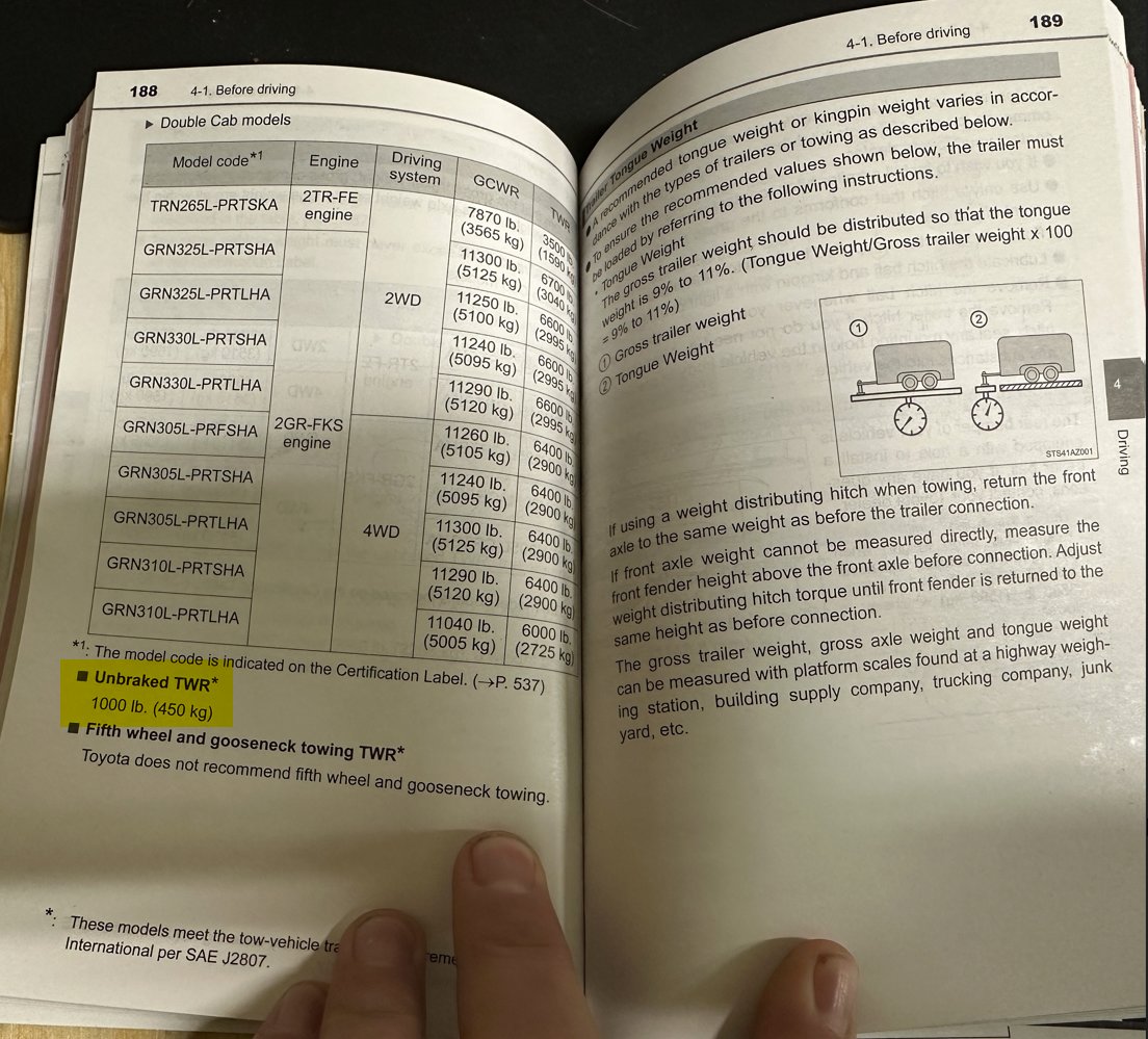

    Stickers do not show Unbraked Trailer Weight Rating. At least mine doesn't. Would you mind snapping a pic of yours?
    Incorrect.
    Incorrect.
    Source...
    @mike rog I have a '21 TRD Sport and the below information is on page 188 of my owner's manual. 1000# unbraked weight confirmed. That is what the book says. Can a Taco handle more safely - that isn't for me to say. I only tow trailers that have brakes and when I do, they are always connected to my brake controller (RedArc Tow Pro Elite). This is a bit of an odd question IMO. You are looking at the Taco's capacity to tow trailers without brakes? Do the trailers you run not have brakes or what? Are you worried about installing a brake controller and don't want to deal with it? I don't mean to be difficult, I just struggle with a full size owner looking to downsize being concerned with a light / compact pickup's unbraked capacity. Regardless, hope this information helps.

    Thanks for the refresher. I've honestly never seen that in the manual before, probably because I'm not towing anything without brakes and never had the need to look for that info. I attempted to respond to OP's question with information that, while true, did not answer the question that was asked. My apologies.
