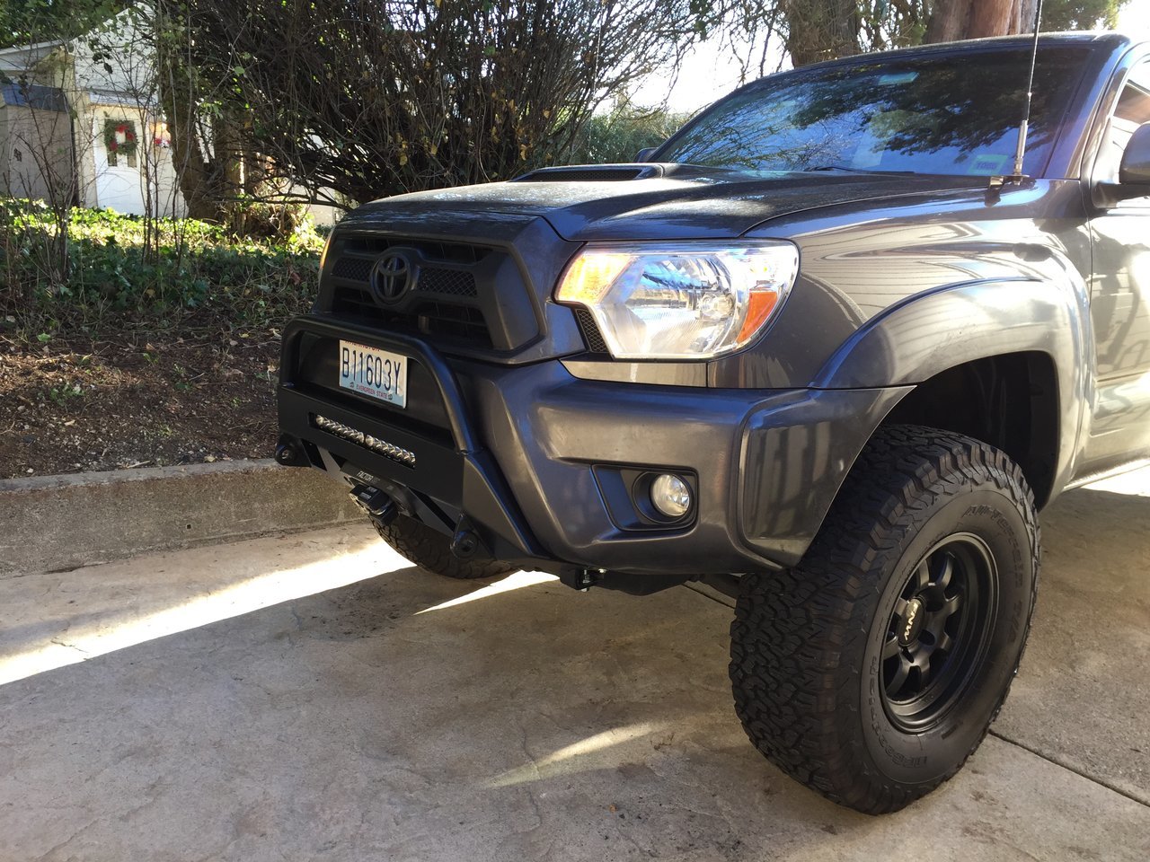

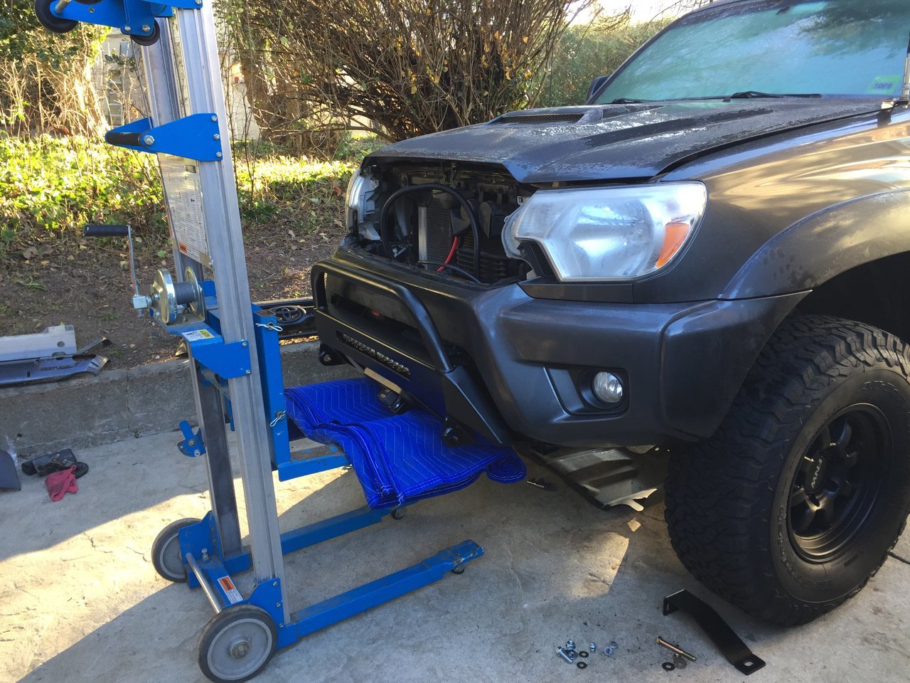

    Installed my C4 Fabrication lo-pro bumper with a Warn 9.5 XPS winch and a Baja Designs

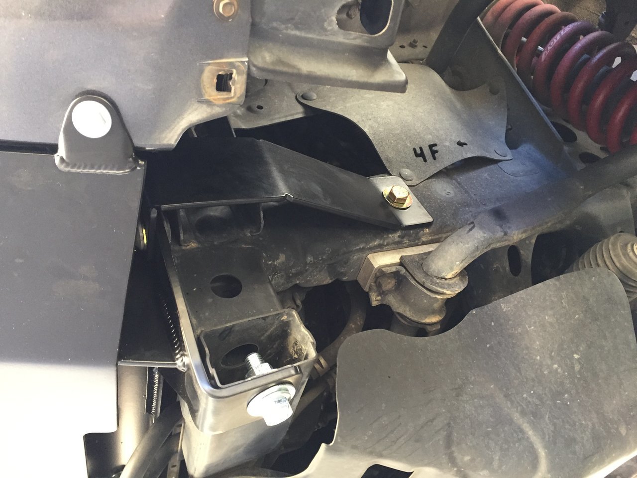

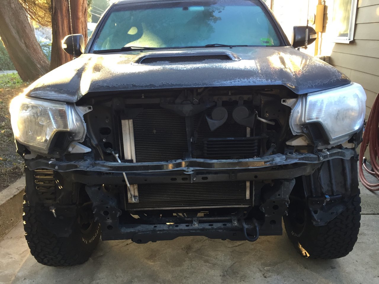

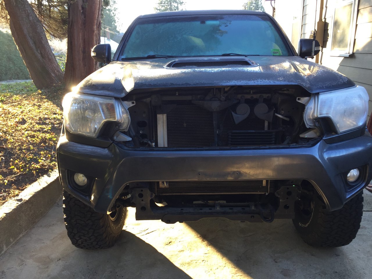

    Installed my C4 Fabrication lo-pro bumper with a Warn 9.5 XPS winch and a Baja Designs S8 20" combo light bar. I also used Relentless Fabrication reinforcement plates.

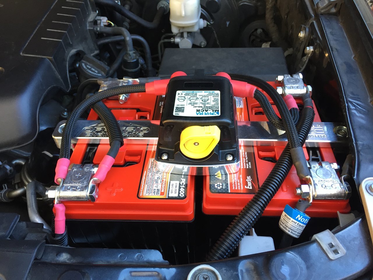

    I installed dual Odessey batteries (35-PC1400) with a Blue Sea relay. I used a battery tray kit from Off-Grid Engineering.

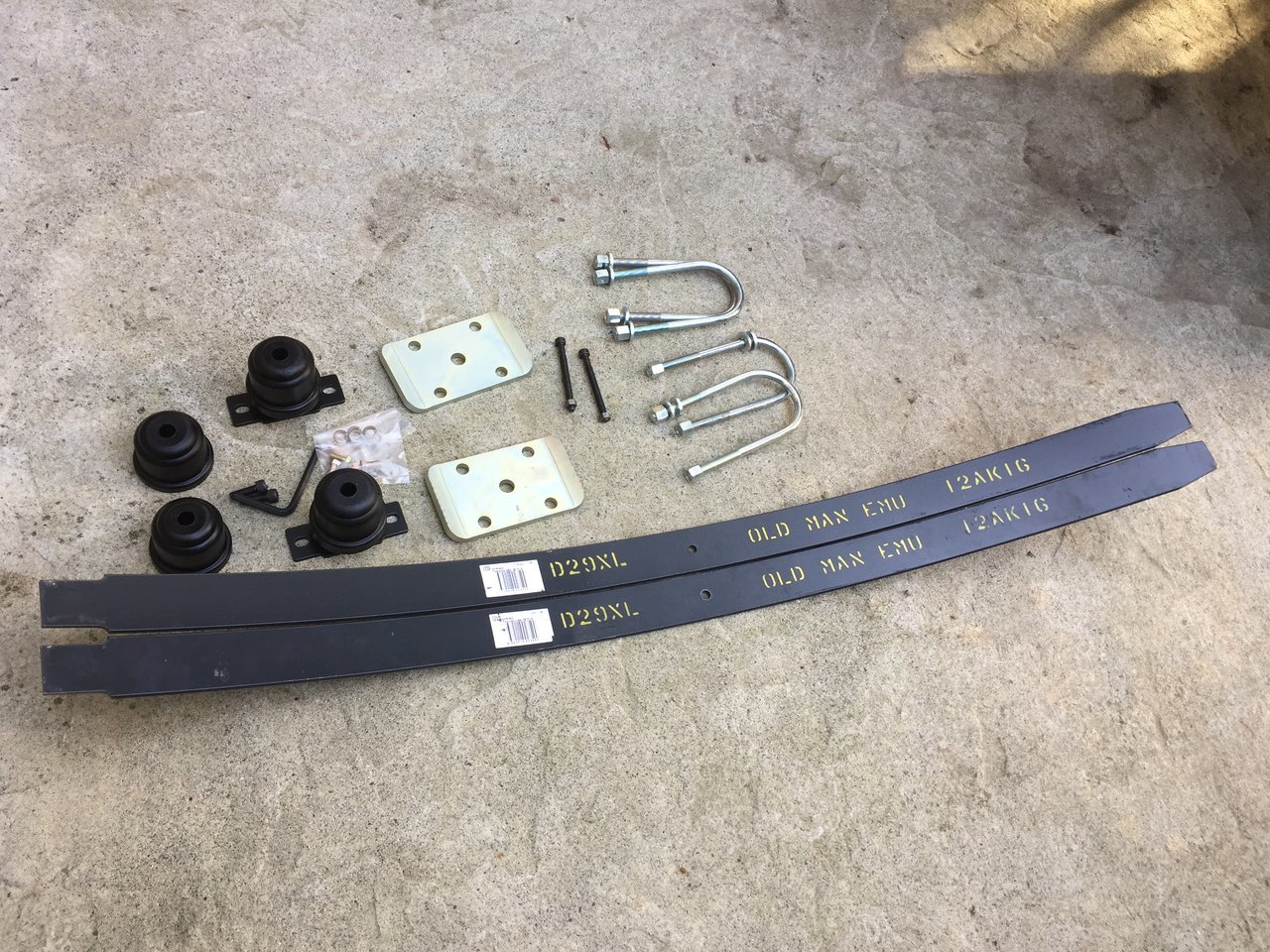

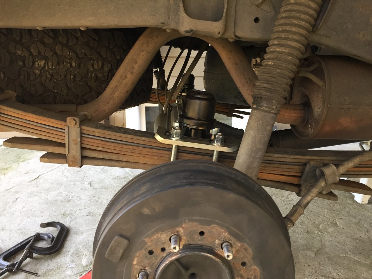

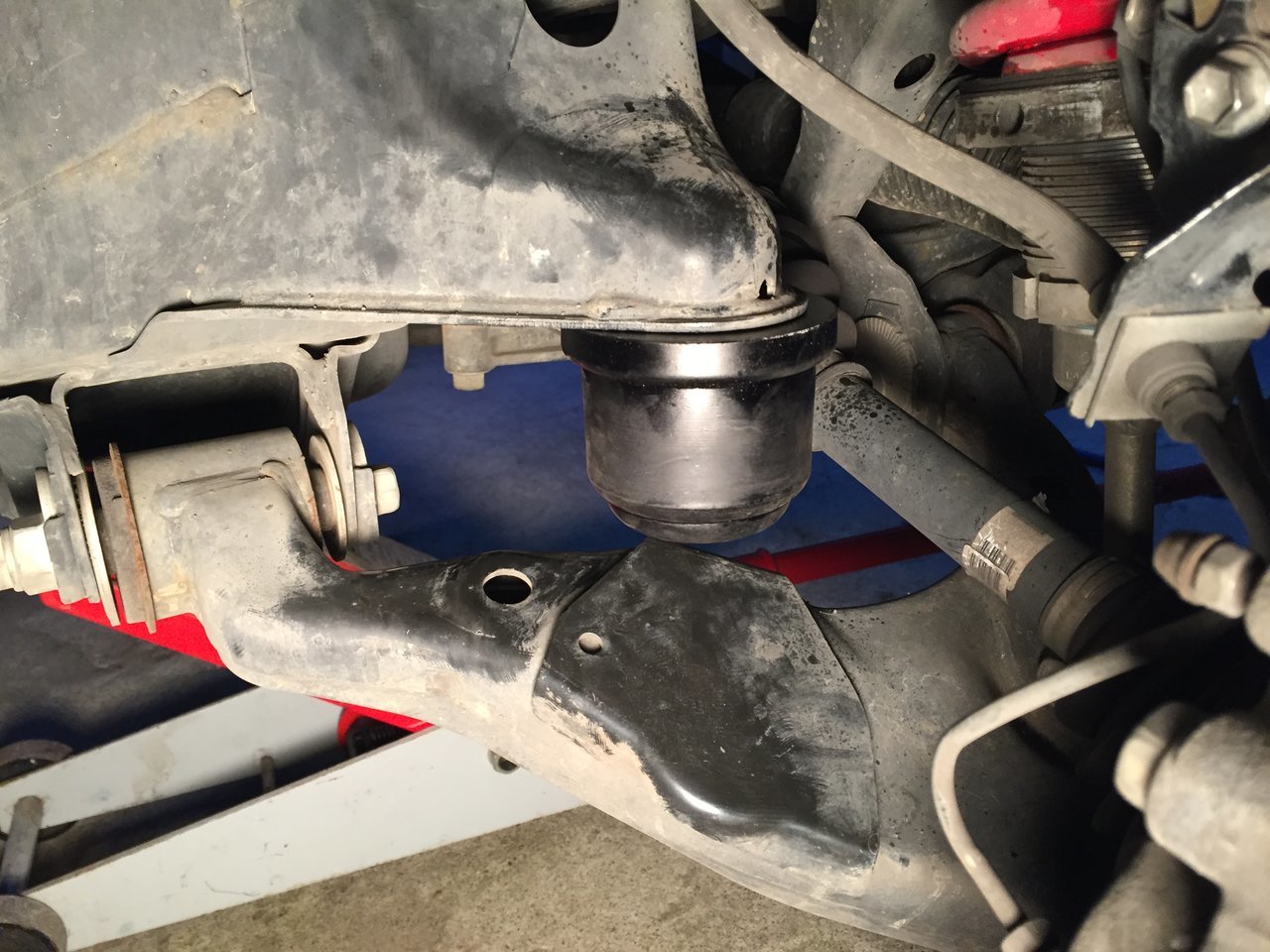

    After 4 years with my lift, I discovered that I lost 1" in the front and 1/2" in the rear. So I installed OME Dakar add-a-leafs D29XL and cranked up my coil-overs. While I was in there, I also installed the u-bolt flip kit that came with my lift kit and also installed Wheelers Super Bumps. I had to drill out and tap holes to mount the rear bumps stops. It was a long day - 7 hours with no lunch break. The drivers side coil-over was a real bitch to crank up. The coil would not slide over the nut and was binding up. It took a lot of extra silicone spray and working the spanner nut back and forth with a cheater pipe on the wrench. In the end I won the battle.

    Hey @yote here's some pics.

    I like it man, subtle yet still provides the capability you're looking for

    Thanks. I didn't feel that I needed the high clearance corners of the bigger bumpers.

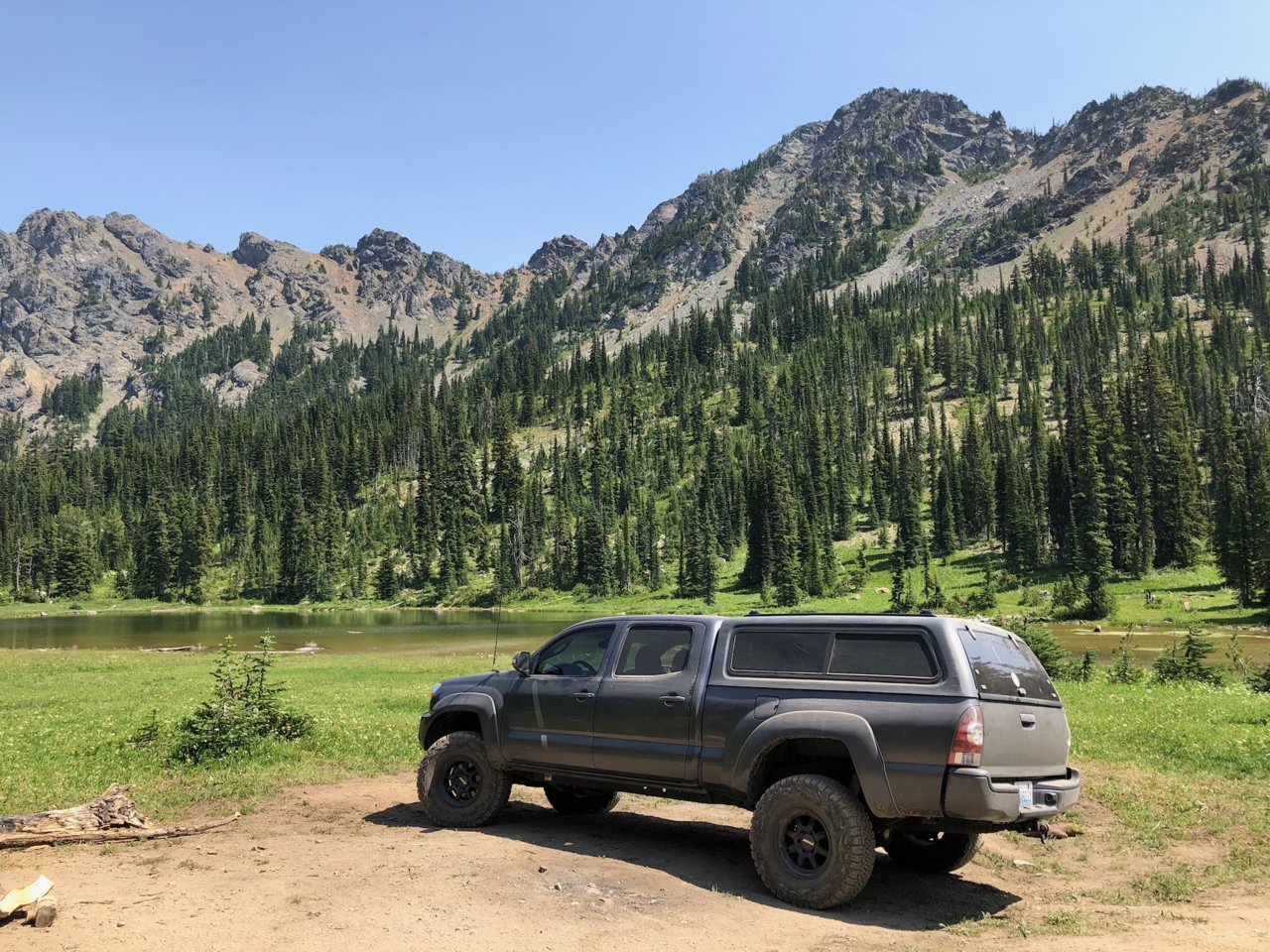

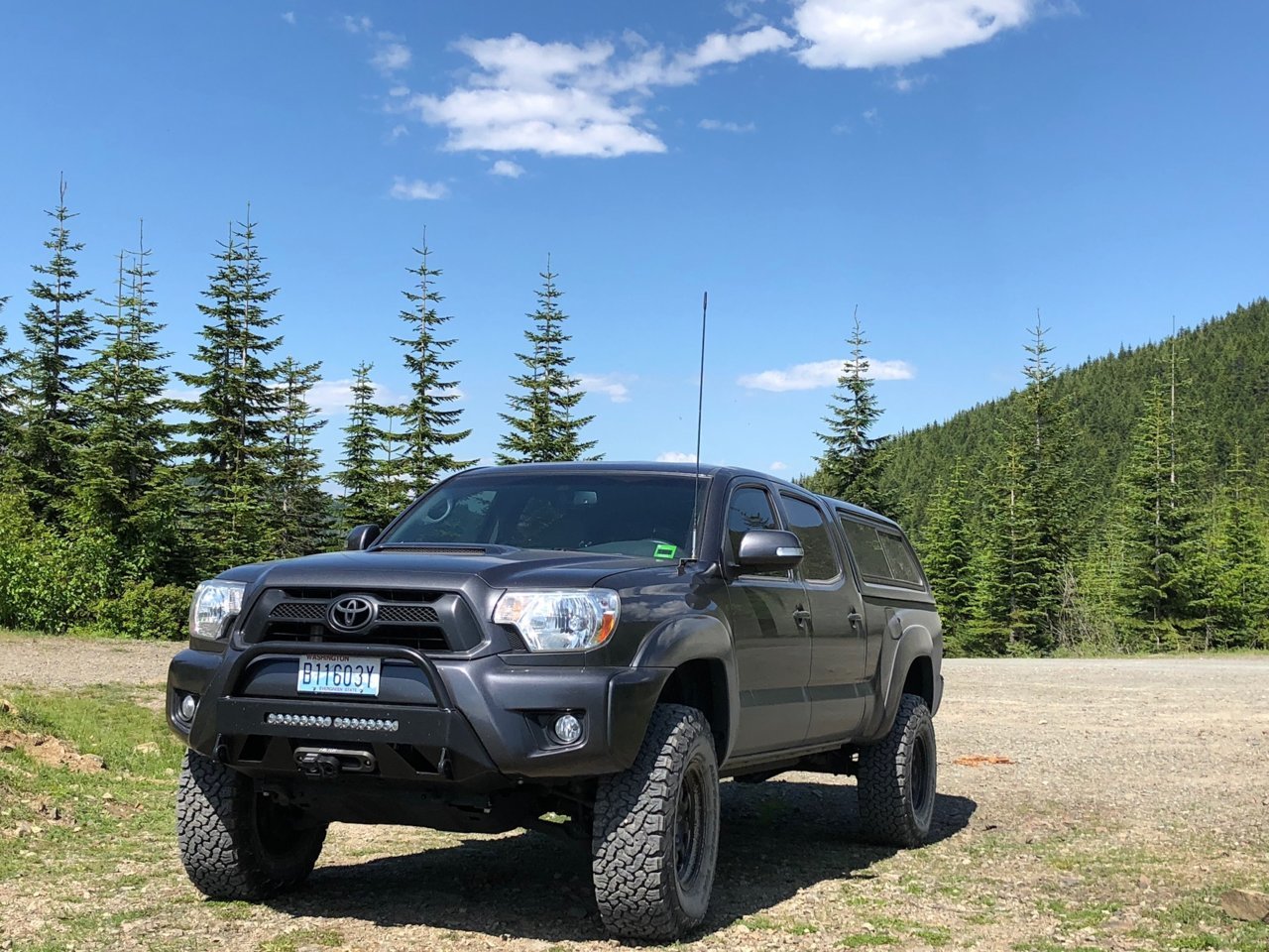

    We went on a few drives last month.
    Stampede Pass from Greenwater to I-90.
    7/5/2018
    Tonga Ridge in Skykomish.
    7/25/2018
    Gallagher Head Lake in Roslyn. Via 4W301 mining trail.
    7/31/2018

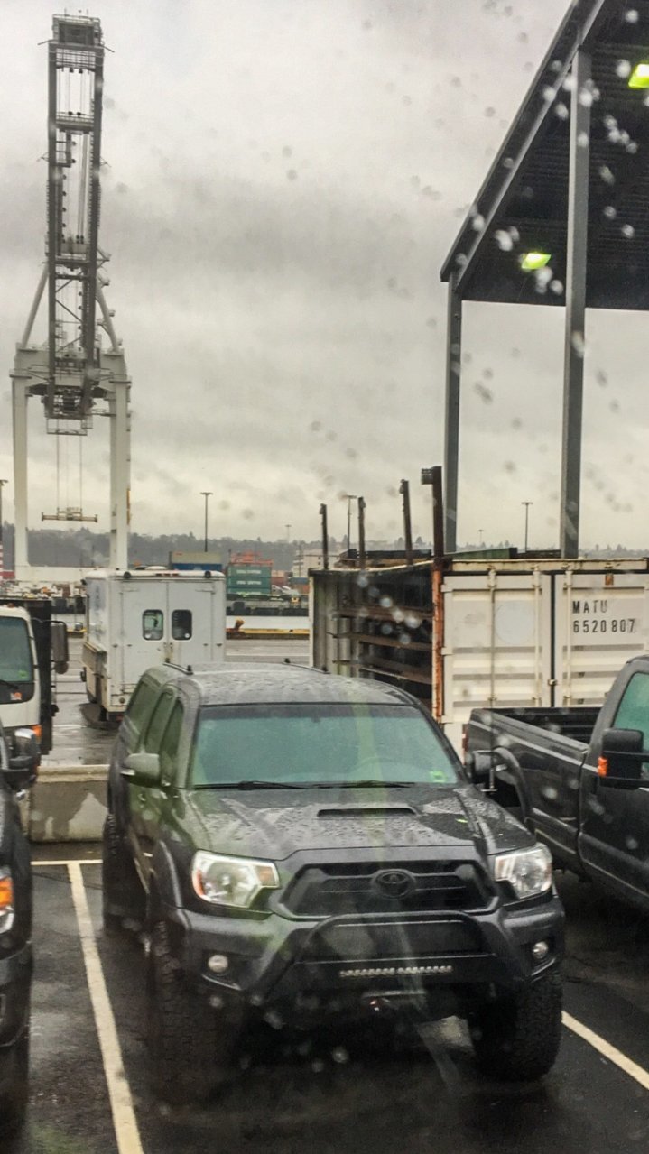

    I spy with my little eye....

    Yep that’s my daily hiding spot - at the Crane Shop. You working at T18?
