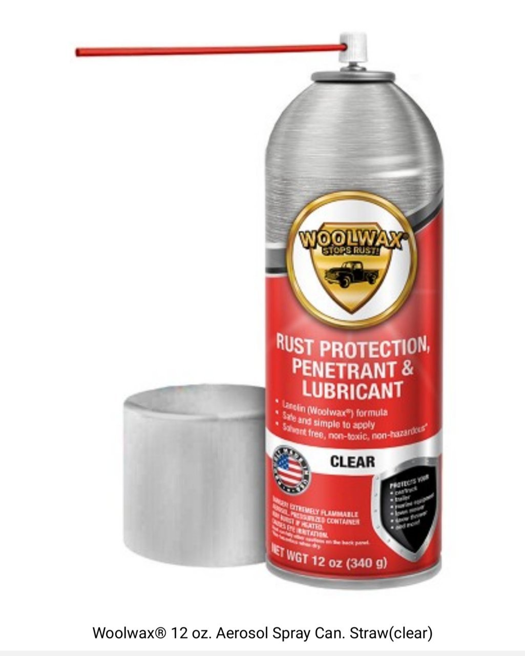

    This stuff works great, as well.
    DAS Taco, Big tall dave and Boghog1 like this.
