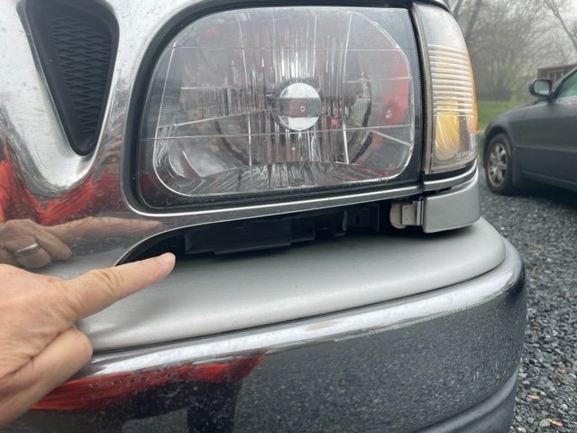

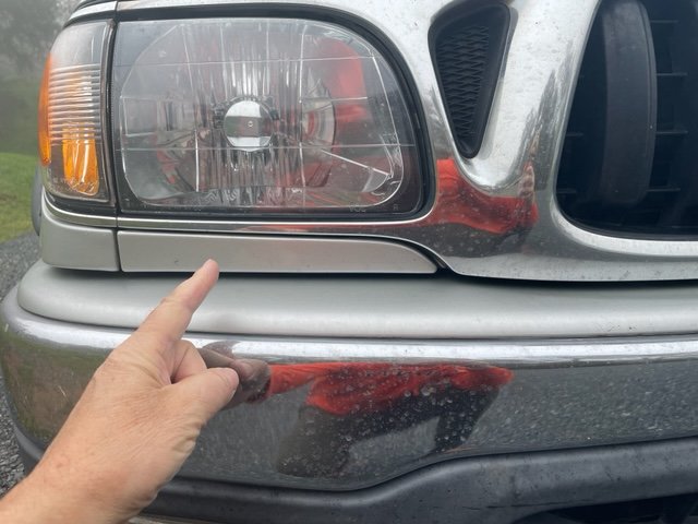

    Dear Tacoma Brothers and Sisters;
    As you see from the photos below, my '01 is missing a small panel under the driver side headlight. Can anyone help with a name/part number for this item? My searches have turned up nothing. If you wish to direct me to a source to buy it, I welcome your wise counsel.

    Wow, thank you! Turns out, this vendor cannot ship to CA but with your help/part number I was able to find it on Amazon and ordered it. I love this web site.

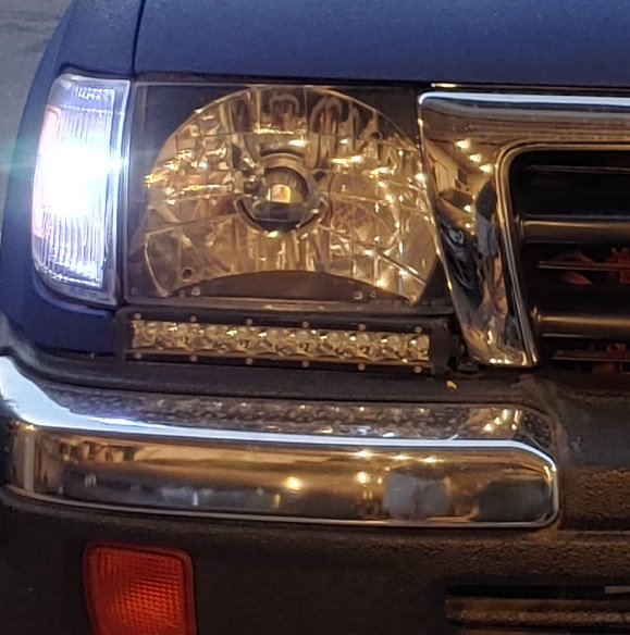

    I actually like this..would come in handy out in the woods!!!
    What size are those?

    I'd have to go measure. Just measure your metal insert lol

    Put a little clear silicone caulking on the new one or it may fall off too. They just don't stay in place so well.

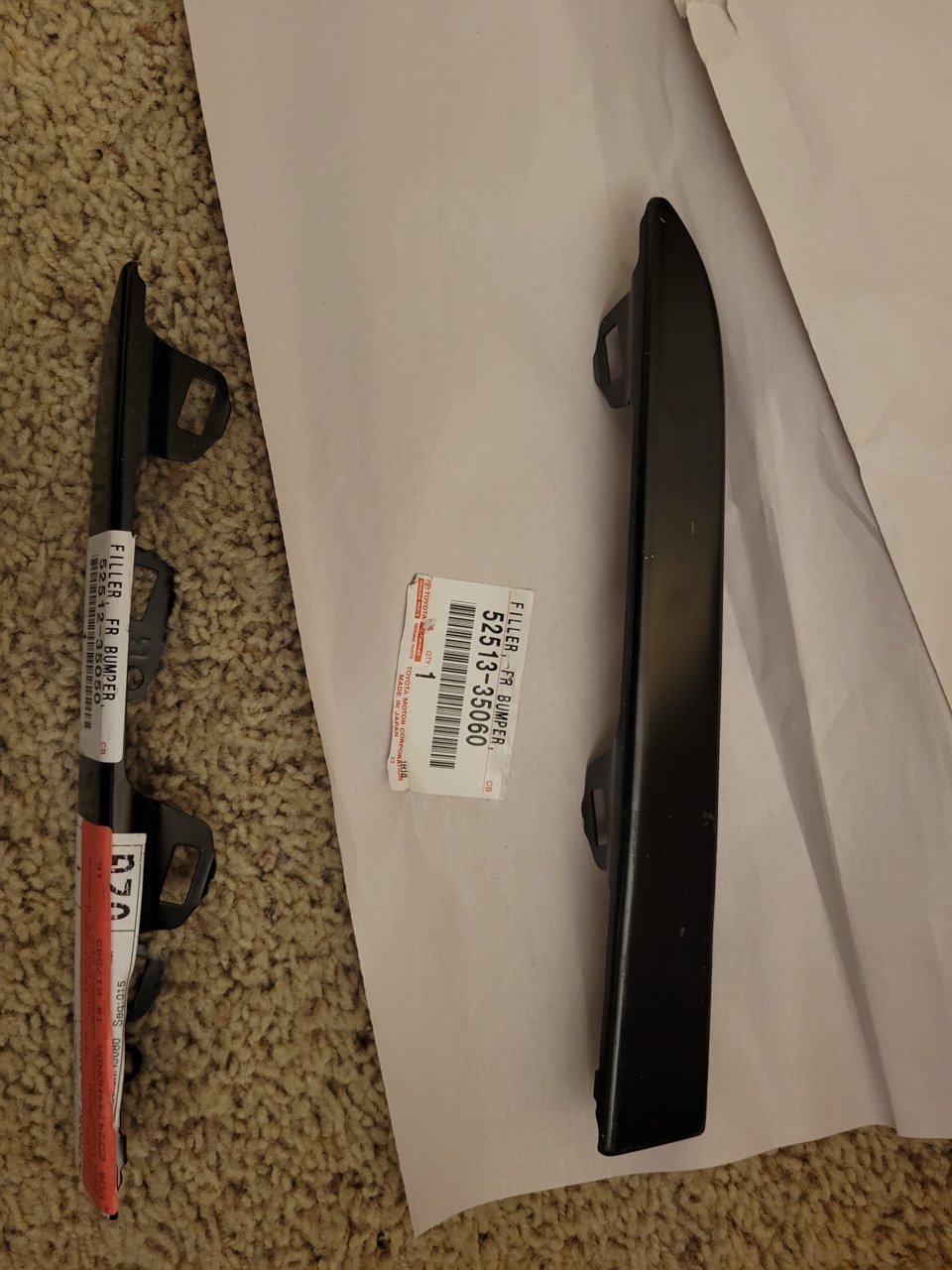

    I recently bought a first gen and both sides were missing. Here are parts #'s.

    Don't forget to order the little clips that hold it in. They don't work well with an aftermarket filler panel, but hold ok with an OEM piece. Mine are glued in because they pop out.
