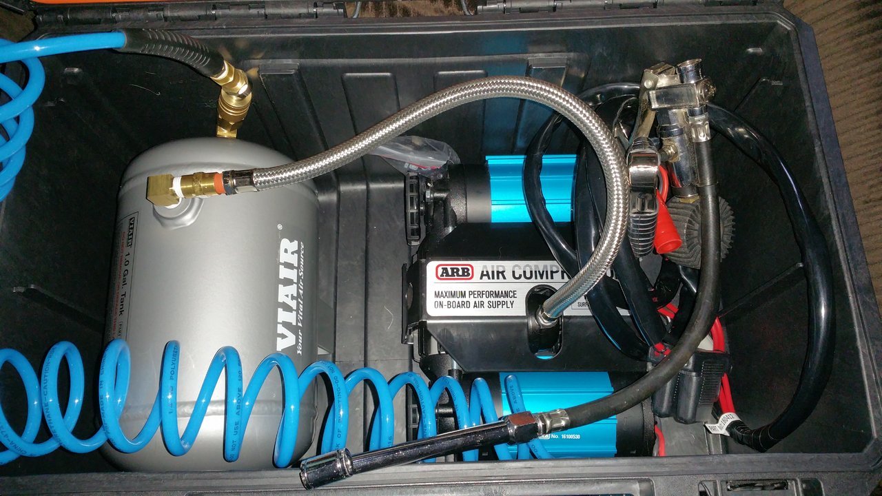

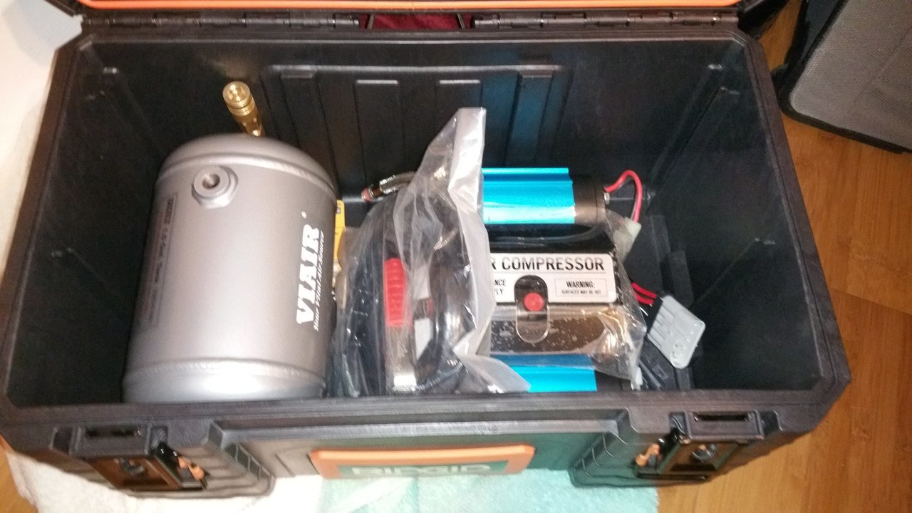

    Just as another option...I wasn't sure how the compressor would hold up with the New England winters and I couldn't decide where to mount it. So I put together my own portable air system.

    I really like you set up! Maybe is a bit costly for me, but it is my "dream" portable auto air compressor set.

    Thanks!! It was a lot cheaper than purchasing the ARB portable unit. With help from a group buy the compressor was a good price. The rest I pieced together, got some great prices on Amazon!
