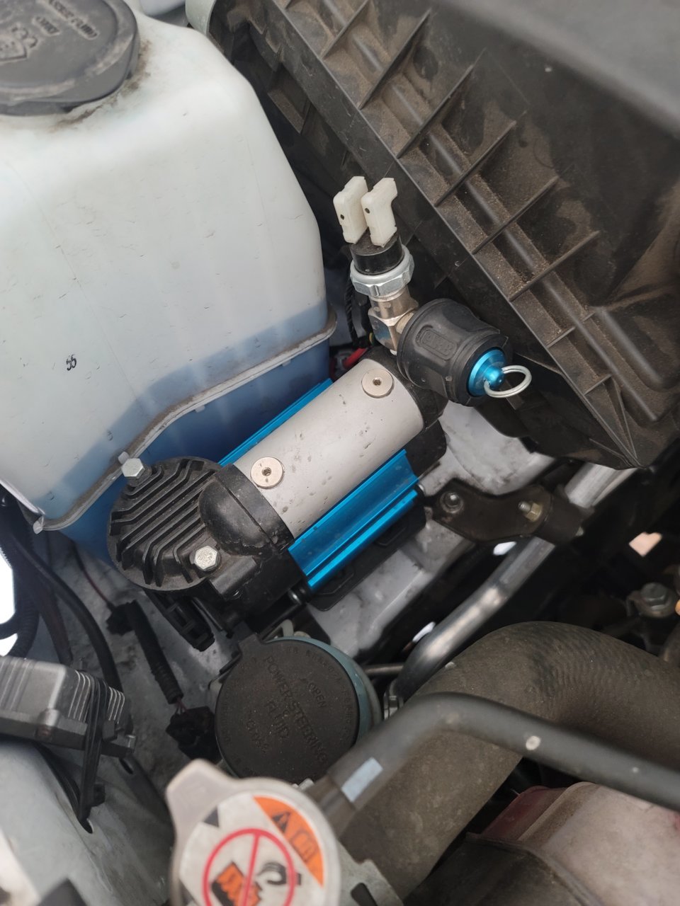

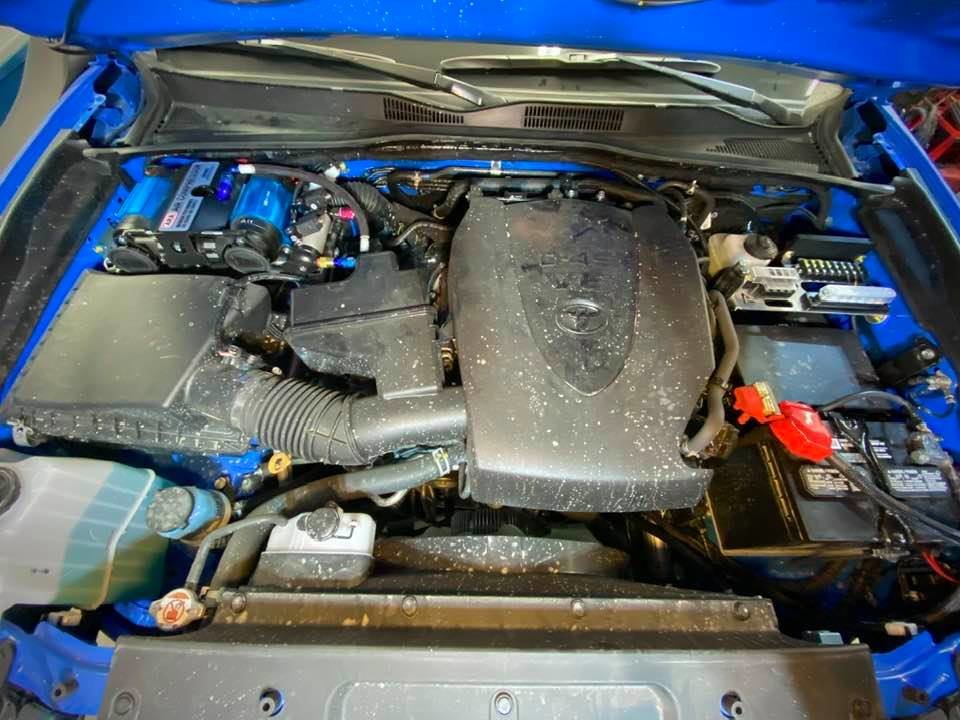

    Has anyone mounted the Slee bracket in an SR5 or Sport that has the ABS plumbing behind the fender on the passenger side?

    some welding required
    yes, the slee bracket avoids all that
    below pictured in my 2020 sport

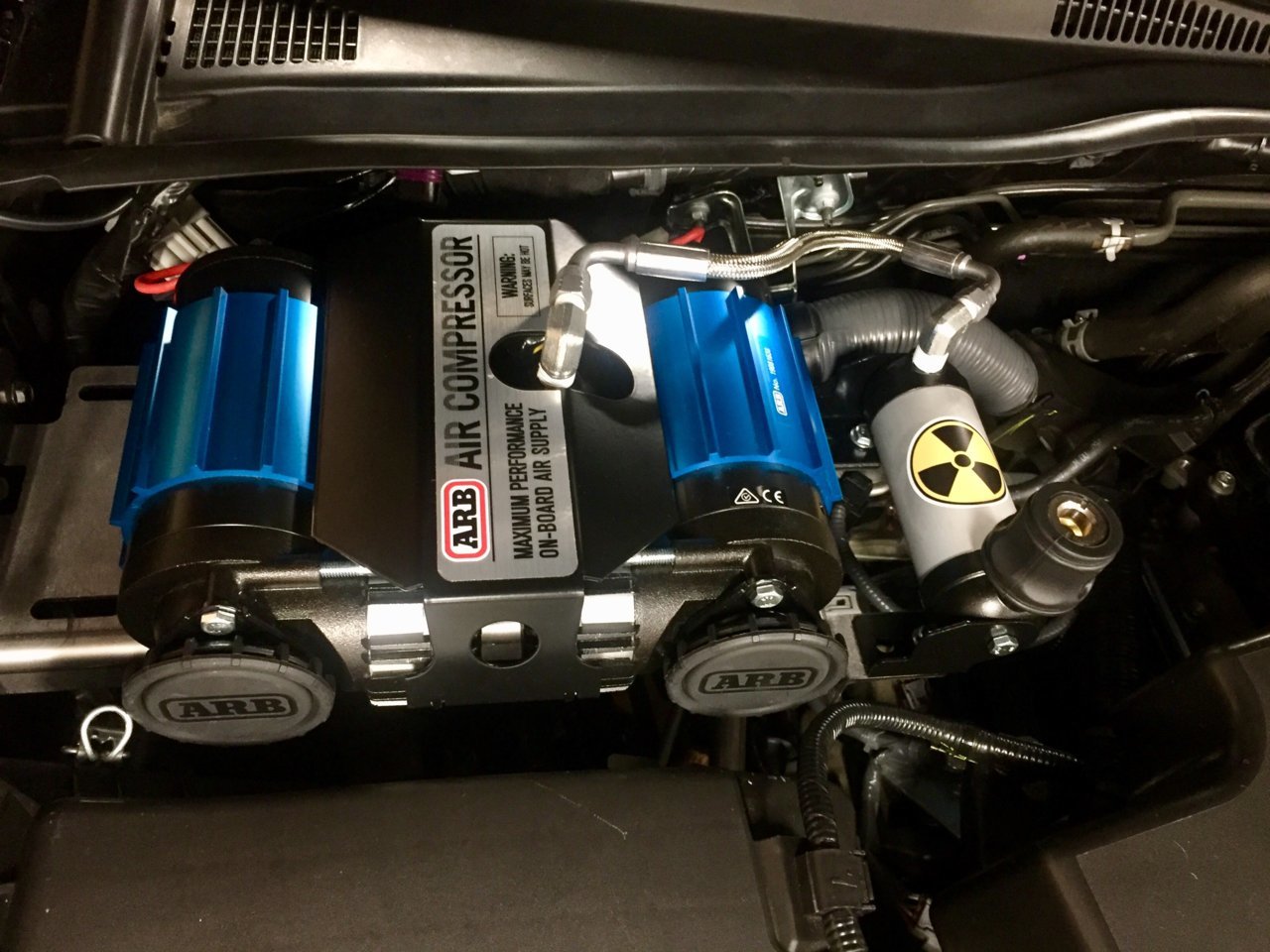

    Upgraded to a 3rd gen
    Never ending......$$$
    Im running a arb single compressor on a slee mount. The mount is made for a 2nd gen but works perfect for my 3rd gen. I originally had the compressor mounted in front of the passenger firewall under the hood. I went dual batteries so i had to move the compressor to make room for the 2nd battery.
    Im going to extend the air chuck and either mount it on the fronr bumper or behind the grill.

    That fallout logo is an awesome (yet pointless) idea. Maybe I need a biohazard sticker on mine...

    Where did you get the air chuck "plug"? That's a pretty good idea, given the mud and grime that can get in there.

    what chuck did you use at the bumper?
