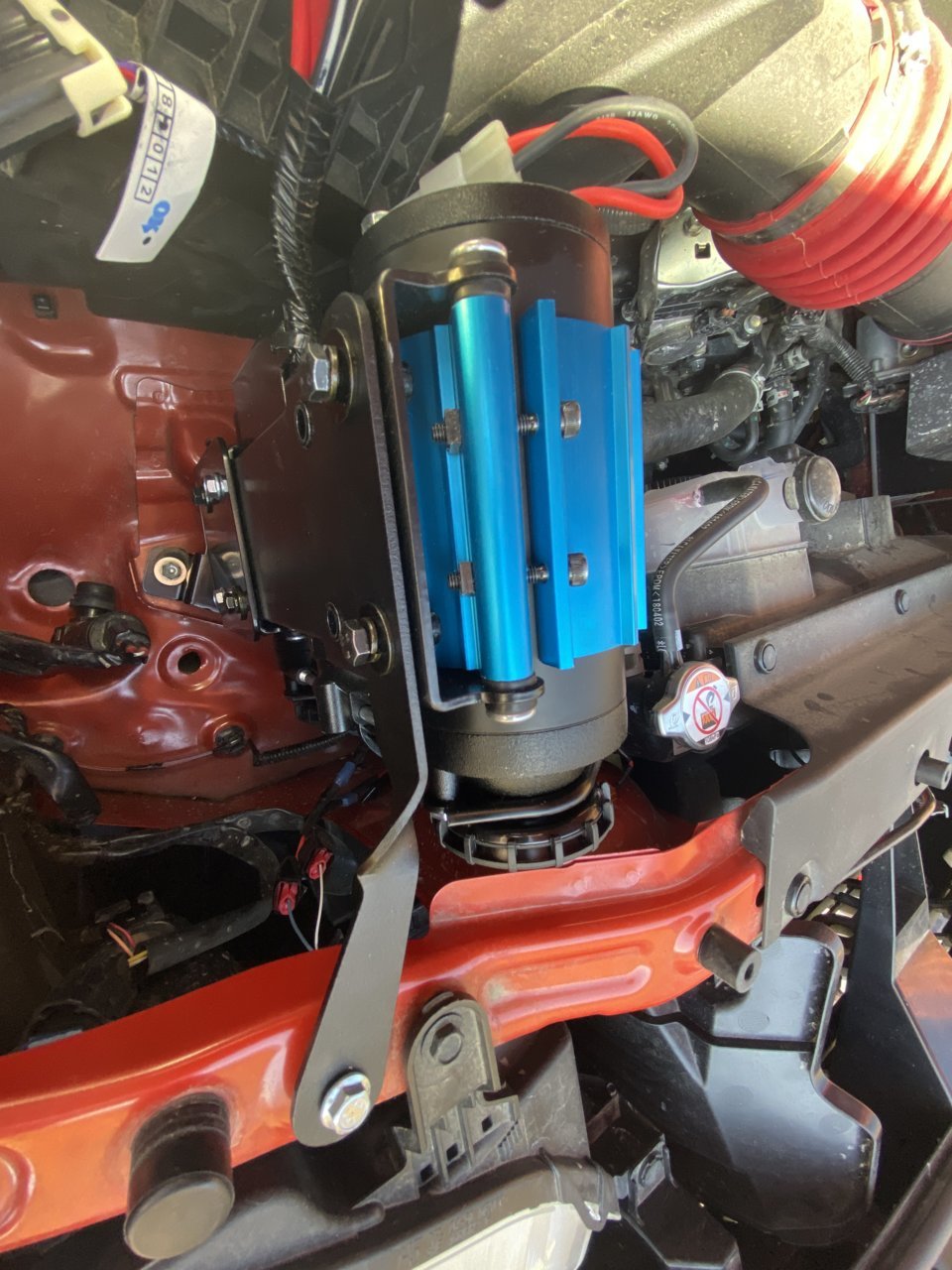

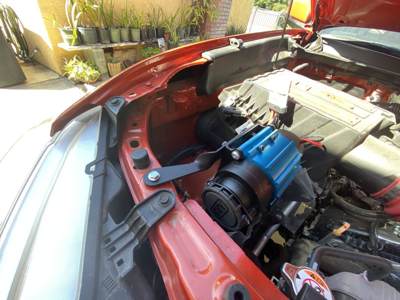

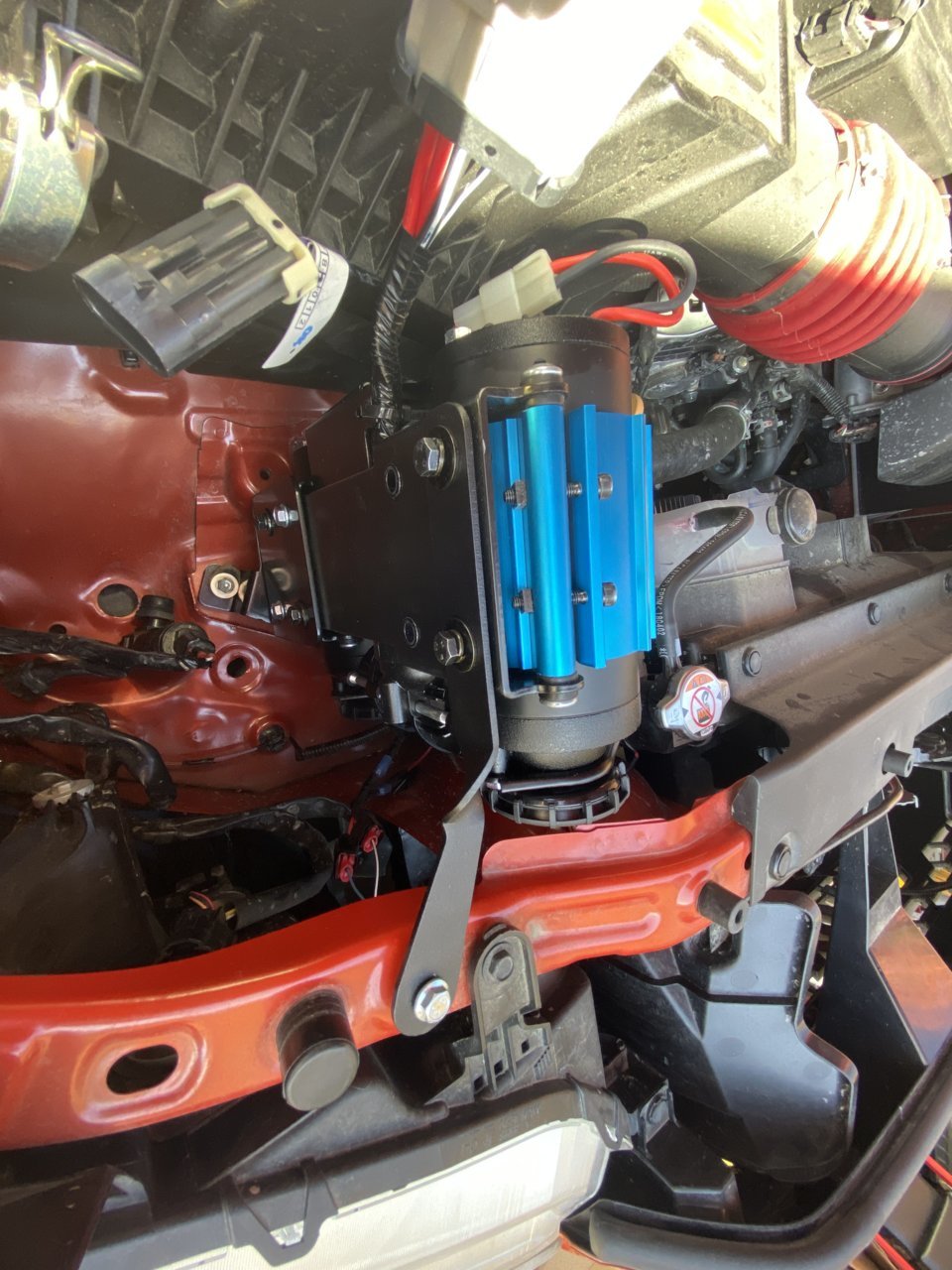

    I love how easy it was to install the compressor and with @MJ_PDX bracket it looks really clean. These photos were taken before I put the windshield washer fluid tank back in. Don’t forget to reconnect the wiring to the tank like I did.
    :annoyed:
