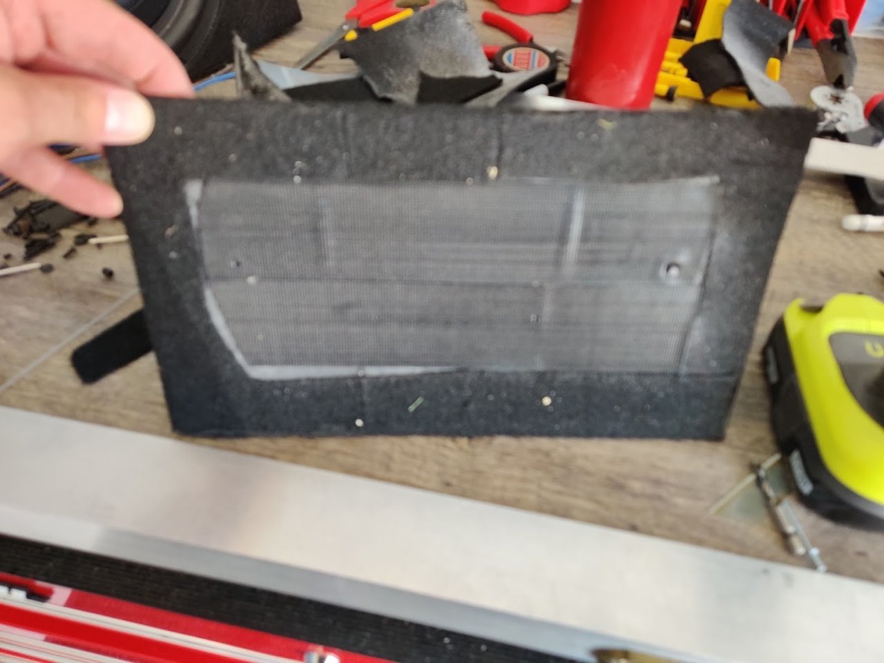

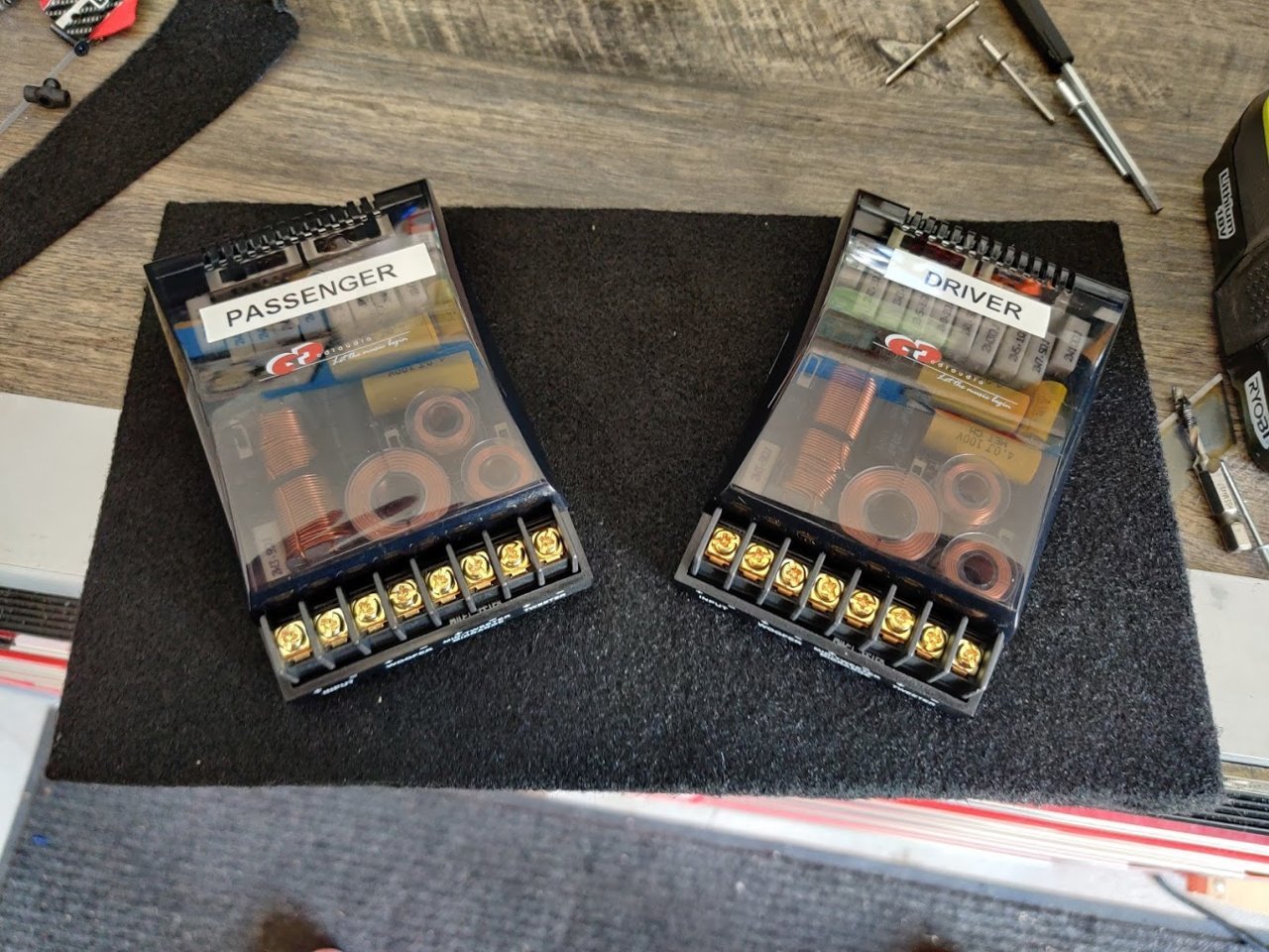

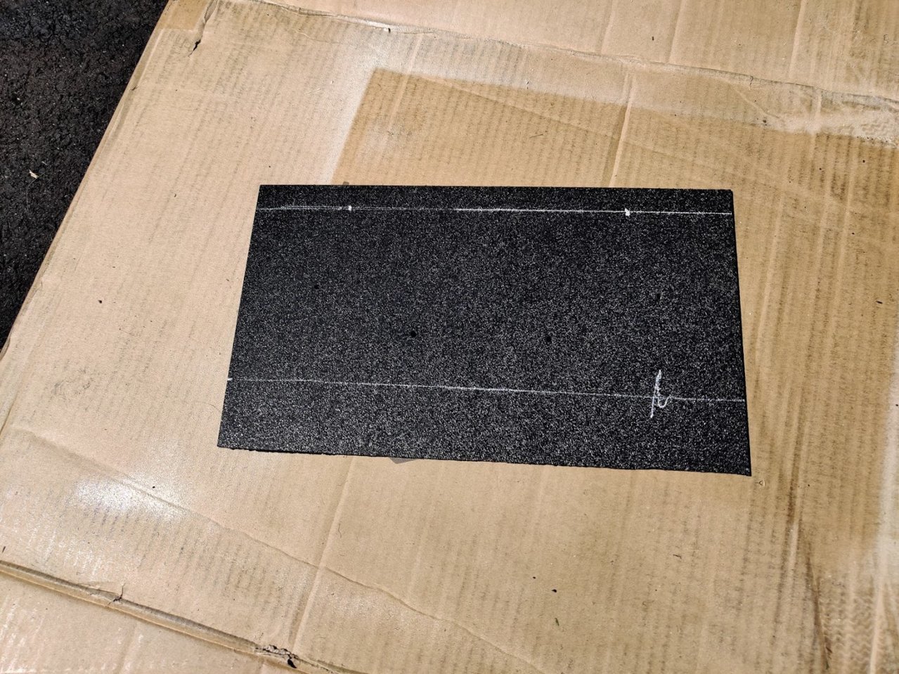

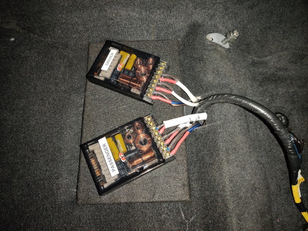

    I've used them before for specific items - but in the end, I had a piece of left over ABS from another project, and made my own.
    I actually tapped the holes for M4 screws and used some leftover screws from an RC Car project I just wrapped up on. Then I carpeted it
    On the backside I put some industrial hook
    Here it is mounted

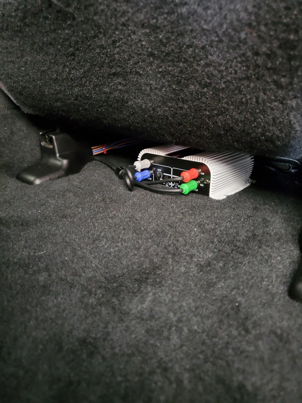

    I zip tied my alpine 5’channel to drivers side underseat of 2021 no jbl very similiar to
    audio plus setup
    minus the $200. secure and plenty of clearance with lots of room to breathe
