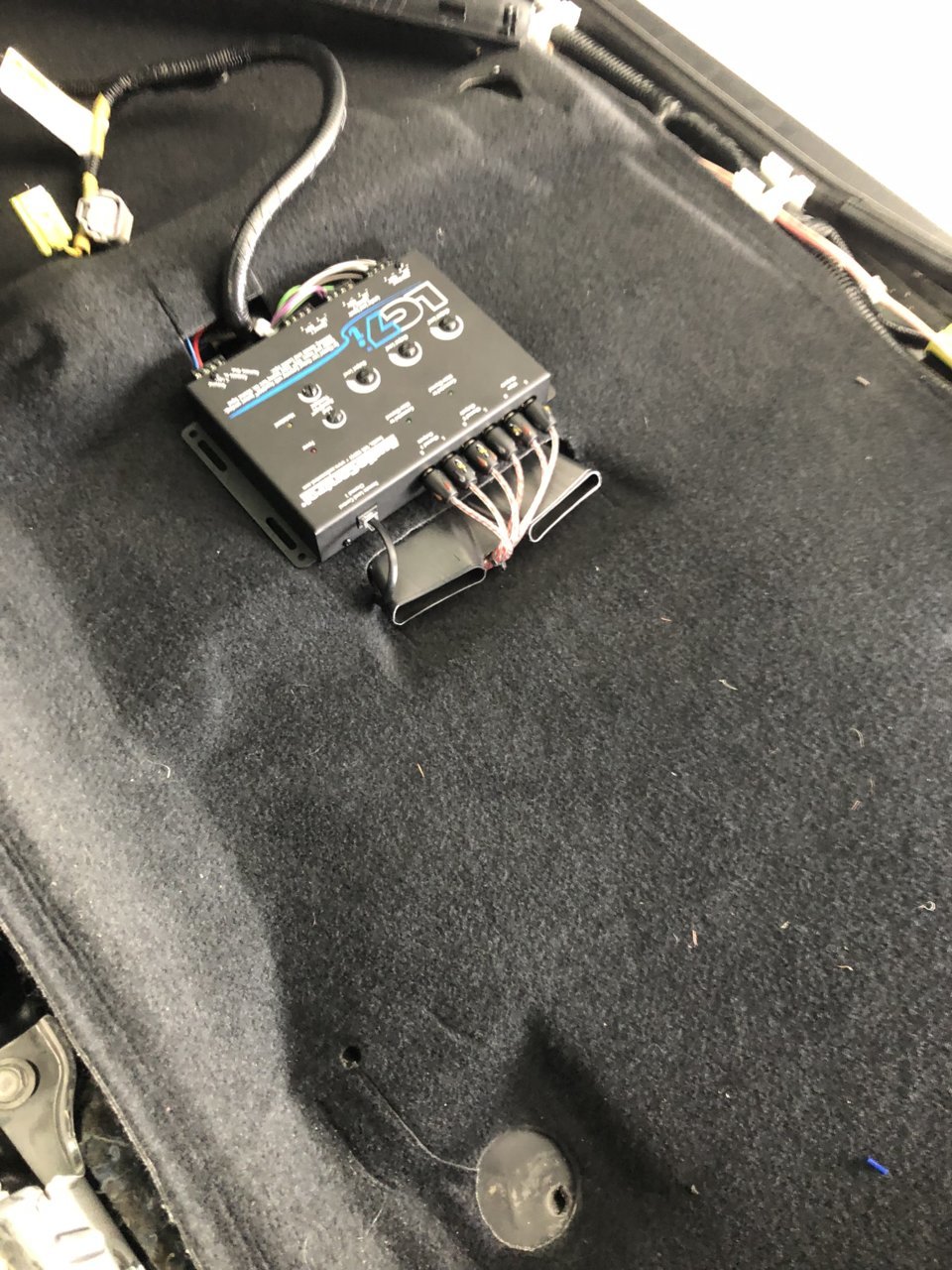

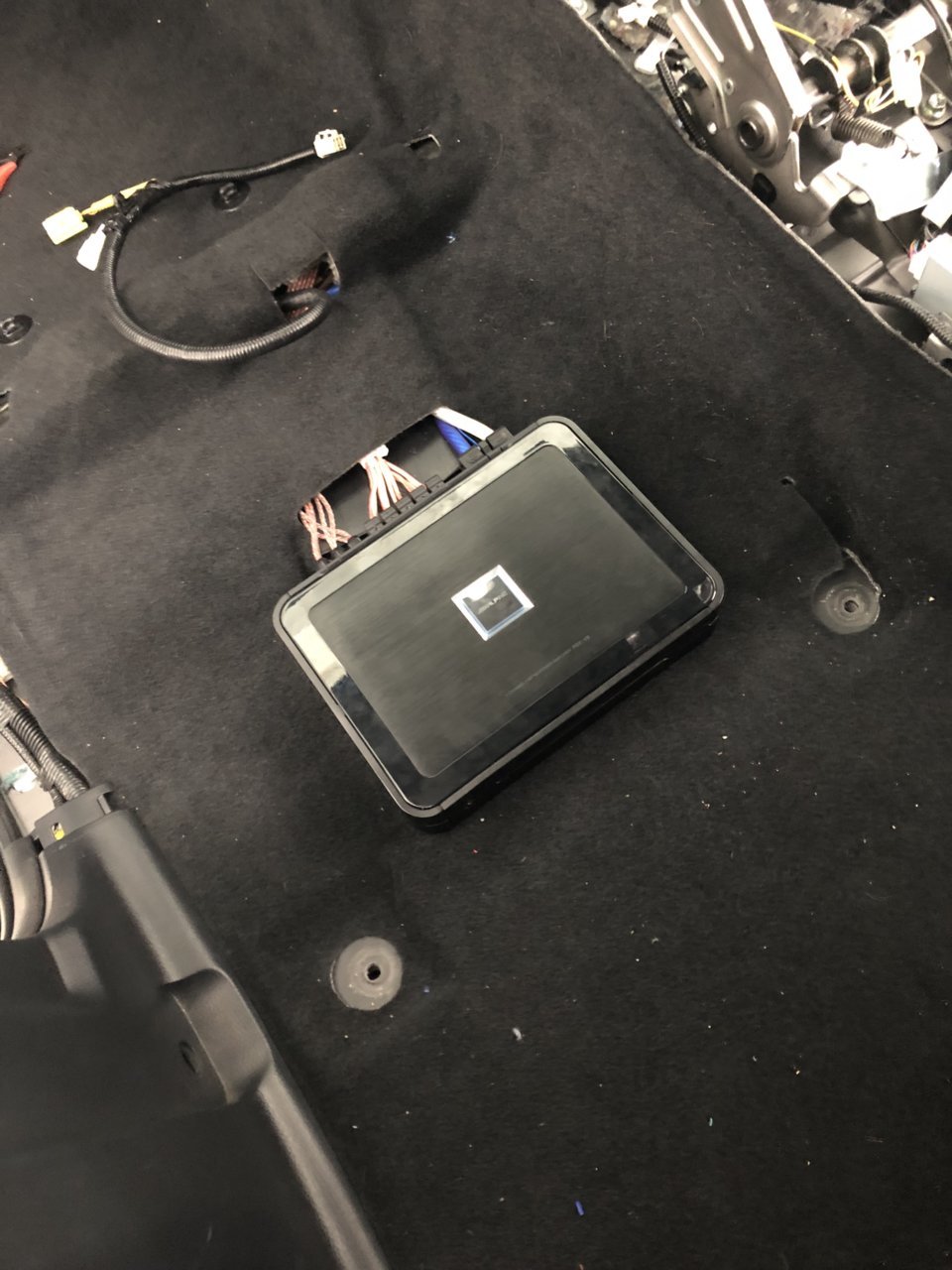

    can you show up your amp setup? im sure its just as clean and the subs under the seat.

    Put amp under driver (more height available) and lc7 under passenger. All wiring was ran when I had carpet out for dynomat and MLV

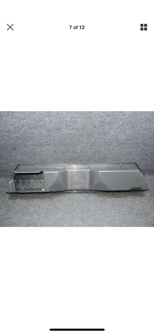

    I did some thinking for the people asking for a mold. In reality we have a mold just flip the plastics bins over and figure out a way to cover the whole where the jack was. I would be using vinyl to first cover the plastics. Use a release and then fiberglass the tub. Does anyone else think this is doable outside of the truck? @Ridescrf450 what are your thoughts on this?

    Using the plastic bin might work. I wanted to get the most possible volume and I believe the bin is smaller then they actual hole it sits in. Let me know if it works!!
