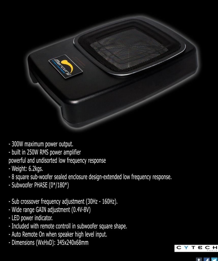

    1891505_620255288104832_3921288197219127_27a1e41e899c7710d68961aeb4407666efd6f68b.jpg
    This unit performs fantastic, and produced a rather good amount of bass
    Internally Powered 10.5 Inch
    RMS Power Handling: 350Watts
    Subwoofer phase: 0*/180*
    Sensitivity: 90dB
    Frequency adjustment: 30Hz-130Hz
    Impedance: 4x4 Ohm
    370mm x 270mmx 78mm
    14.5inch x 10.63inch x 3inch

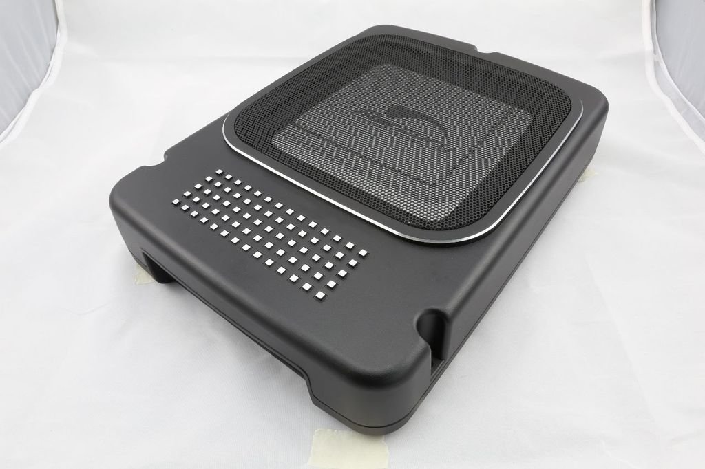

    8 inch
    Screen%20Shot%202015-05-04%20at%201.39.4_ff820d6d0408fda9845602860f682844ba305b7c.jpg
