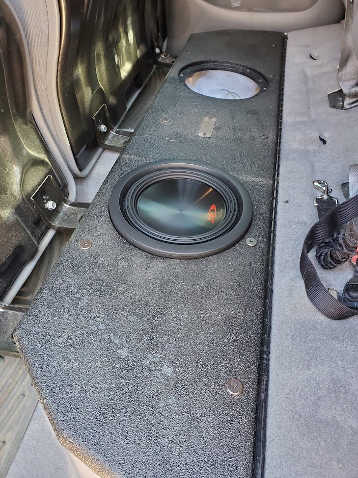

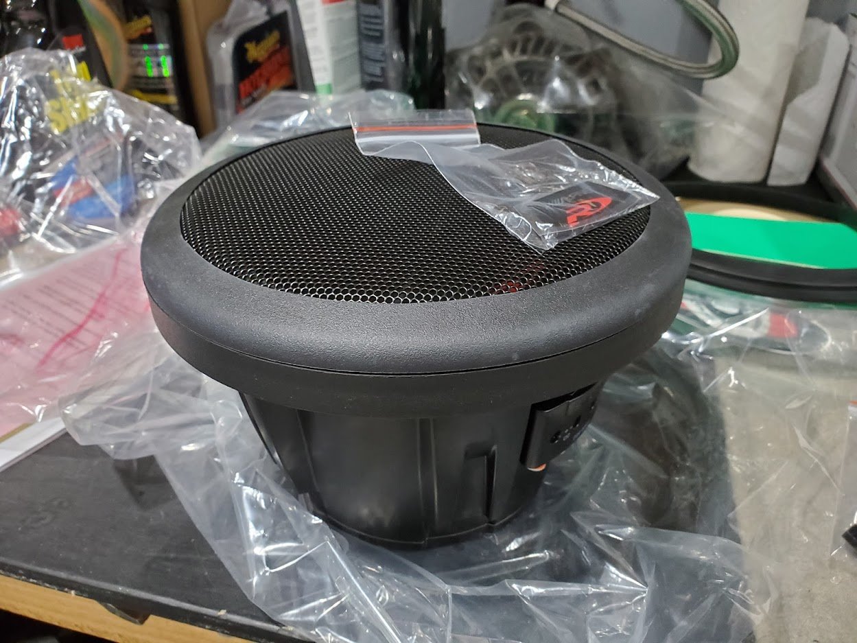

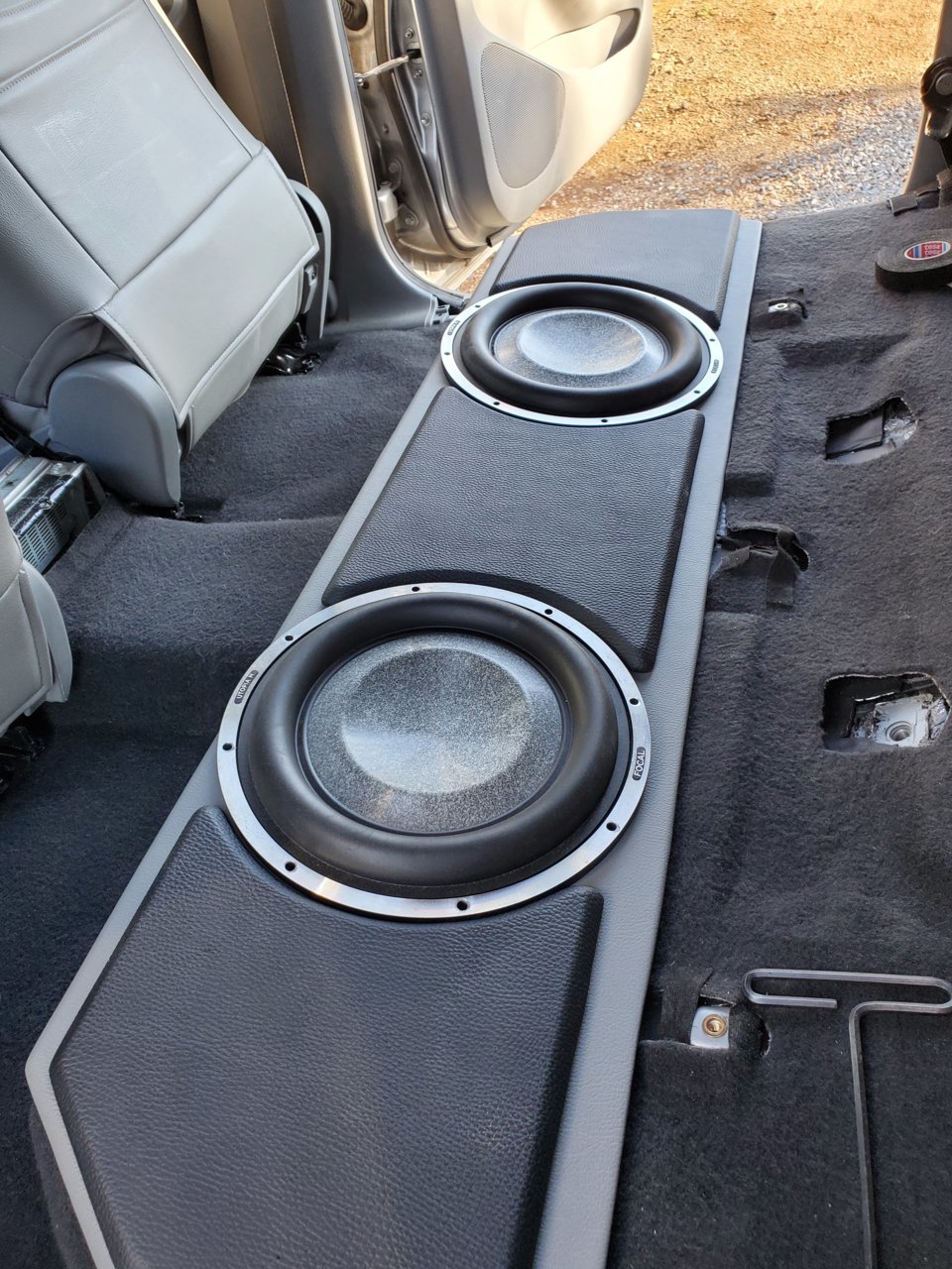

    I recently upgraded my aging 8" subs (CSS Trio 8s) to Alpine Type R 8s with the integrated grills. I've been very happy with them. I should have tried them years ago. Sorry I don't have a finished product picture and it's filthy but you get the idea. I've been running this enclosure style since I started this thread years and years ago.
    Check the depth on the Kicker's and see if it's the same or less than the Type Rs and if so, you can make it work. Just make sure your not sitting too tall on top of the enclosure because it will hit the seat bottoms.

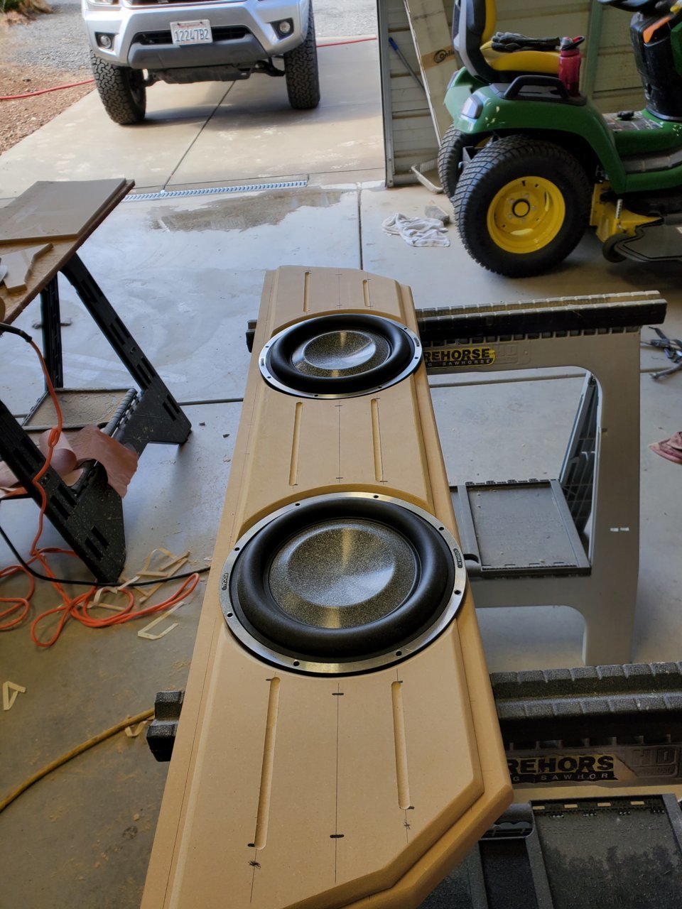

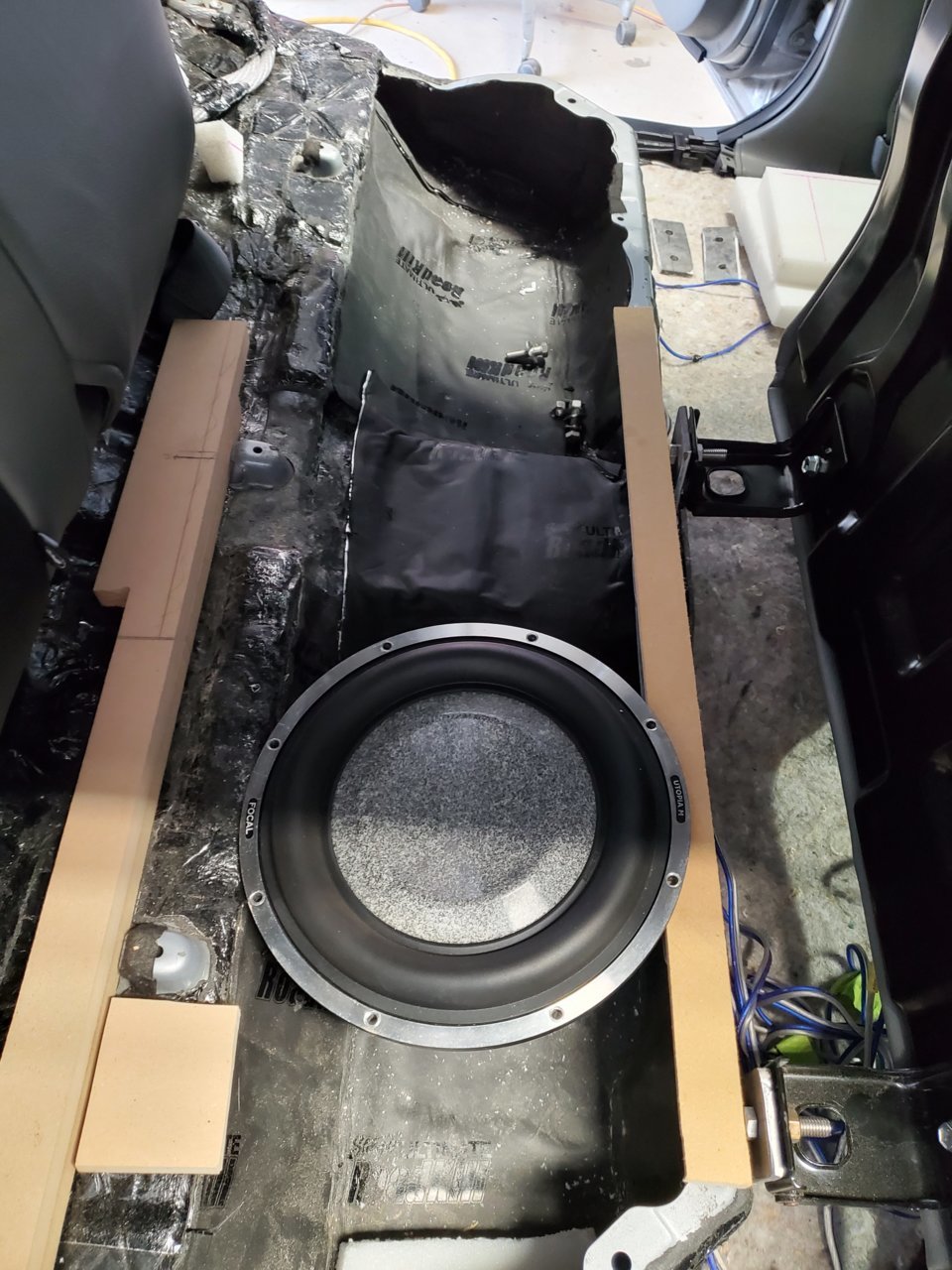

    Hi folks
    I recently decided to give it a shot, i am fitting the focal 10wm woofers. Ive been running them behind the seat , but im adding two more amps and will useing the area behind the seat for the amp rack.
    Its still a wip!

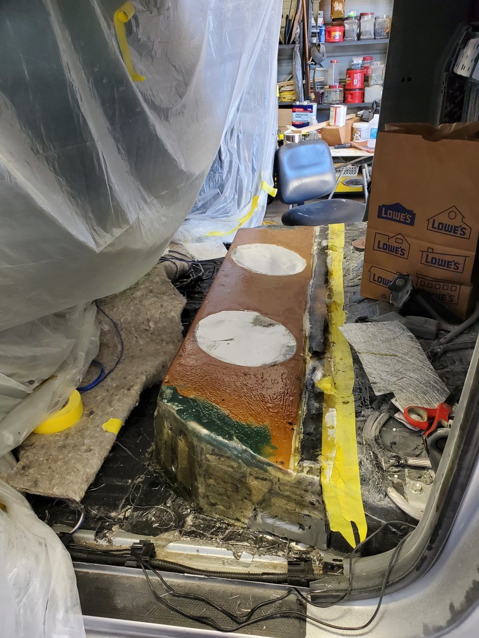

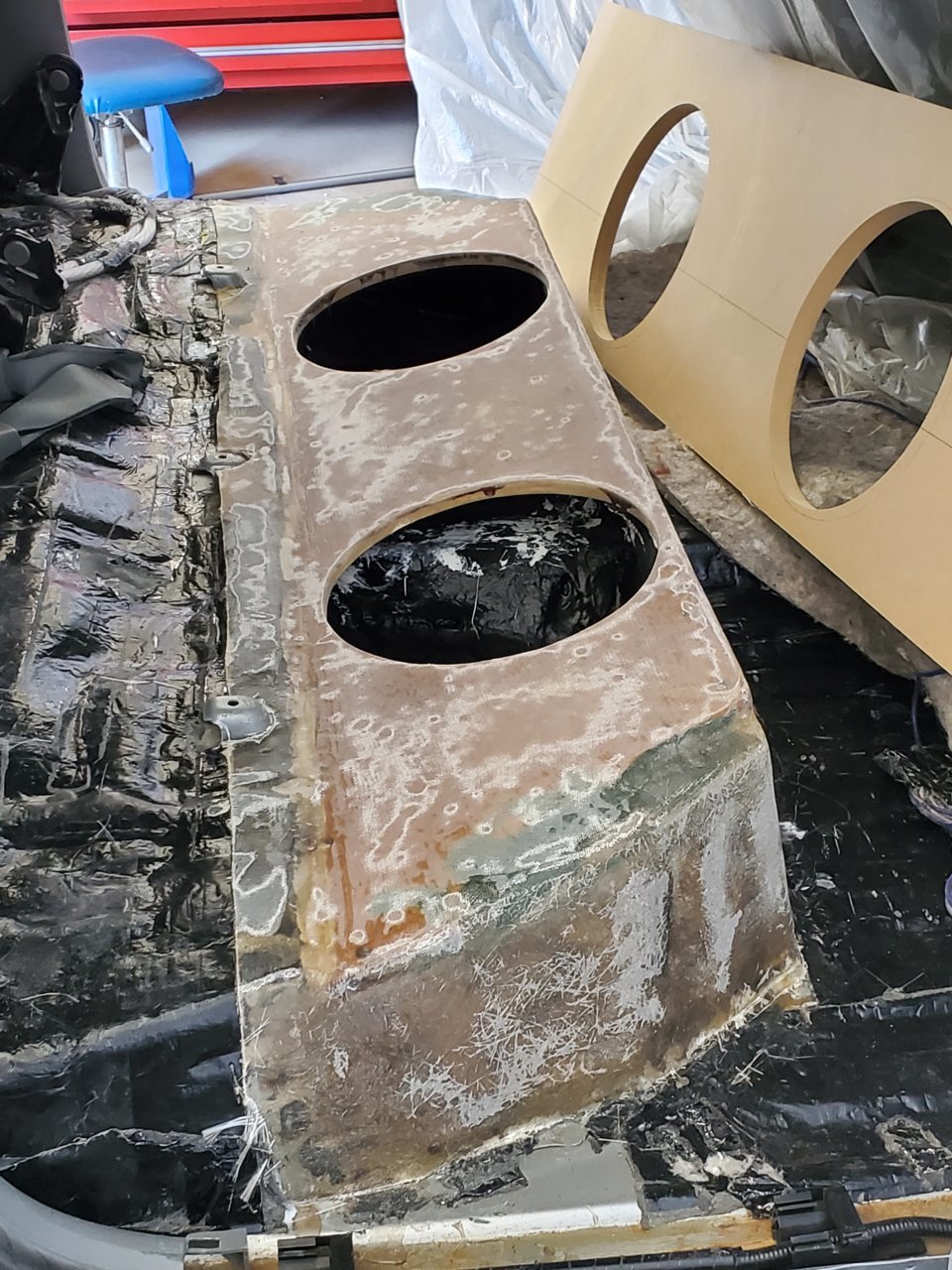

    After a bit of surgery with a cut off wheel, i ended up with .47cf, per side with the woofers in place, spec is .70-.35 , i rechecked useing styrofoam beads, , i raised the seat by 2inchs, at 6.2 i can still sit in the back, but i have about 1/2 inch of clearance, i never really have anyone in the back seat.
    the plan is lots of fiberglass, lots of swearing , it will be sealed , at the end of the today, the cutting , divider , and 3 plus layers of glass are done. Ive made a baffle that i will be glassing in place permanently, and a second , if all goes well, baffle that will bolt to the first,

    2014 trd dc
    Sealed , will install the base plate tomorrow, then shape the outside edge of the baffle, then on to amp rack20220226_112510.jpg

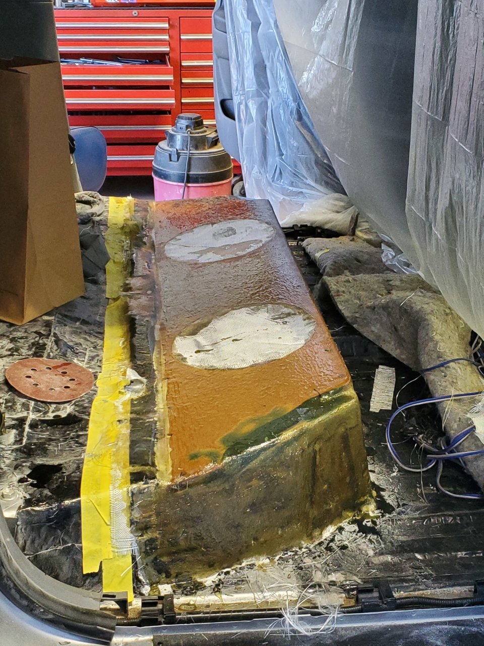

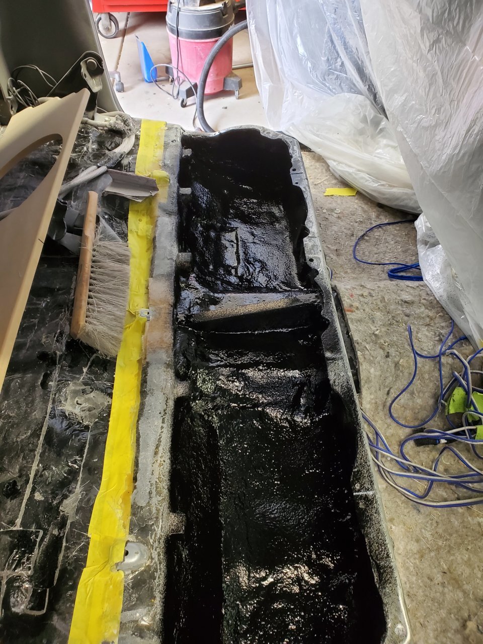

    Done with the fiberglass, inside and out , its solid as a rock, if it ever comes out it will take alot of Cussing , and cutting..20220227_132907.jpg

    Nice work. I wasn't willing to make mine 100% permanent. The lower portion of mine is glassed but just the interior. My baffle/top plate is removable so I can switch up the subwoofer size if needed (which I've done twice over the last 12 years). It's a bit more involved on the baffle creation but still worth it I think.

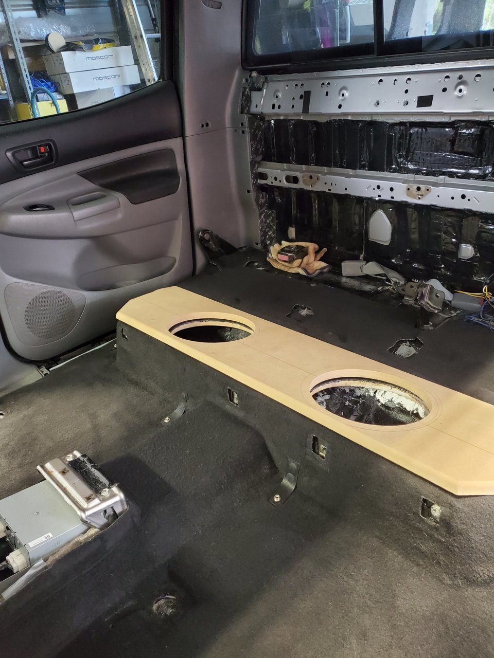

    20220228_115641.jpg Ive made the woofer baffle removable, the base plate wont be, so if the change drivers, i will just have to make a new baffle. Plus i really wanted to use the focal 10wm, and they just barely fit

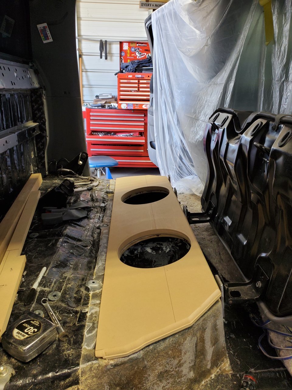

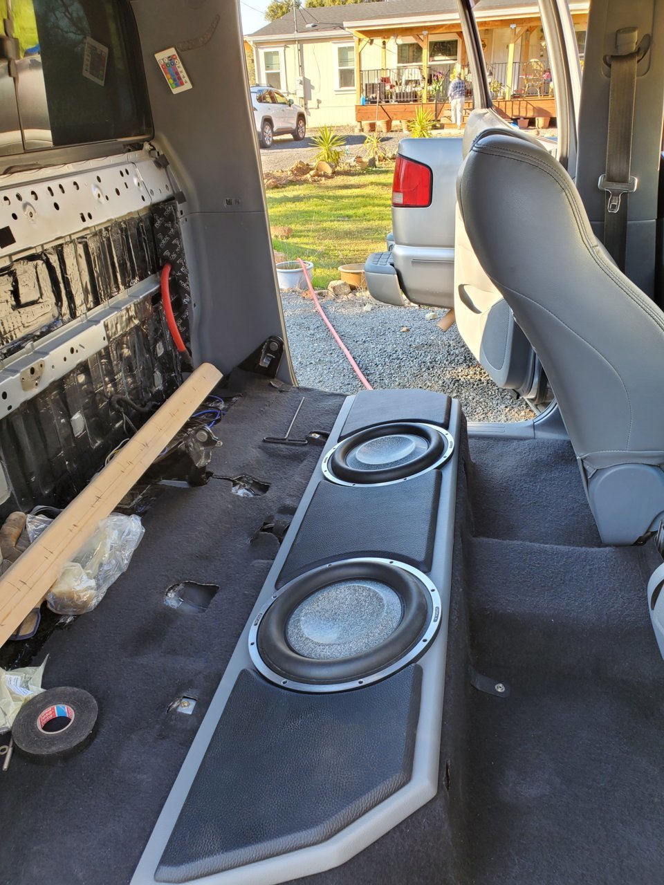

    Very pretty! Inquiring minds would like to know....what happened to the horizontal channels routed into the top bits? I thought that looked kinda cool! Too tough to wrap?
  17. Mar 7, 2022 at 6:33 PM
    #237
    epiman500
    epiman500 Well-Known Member
    May 25, 2014
    #130566
    111
    ken
    LA grange cal
    2014 trd dc
    The vinyl didnt want to stay in place, so i filled them, ver, 3.3
