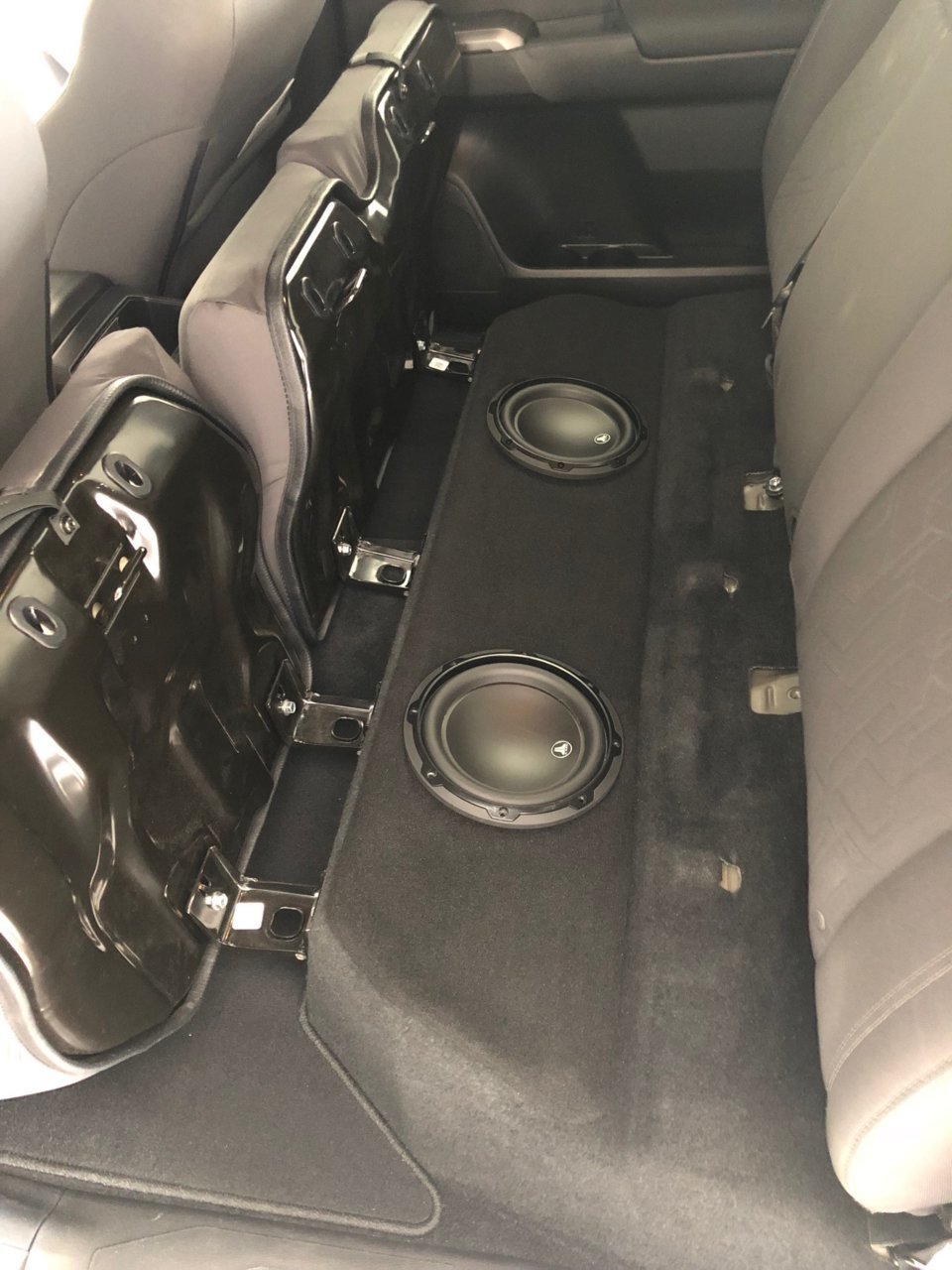

    Build thread coming soon! .60 cu ft fiberglass enclosure with two JL Audio W3V3 in the works.

    Very nice! I like it with carpet more than I thought I would!

    Why does it seem like almost every post I see from you is you trying to sell something to someone? This thread is discussing fully custom sub woofer solutions, yet here you are promoting a cheap, off-the-shelf amplified under-seat sub like you'd get at WalMart?

    Looks good, I`ll have to try this at some point.
