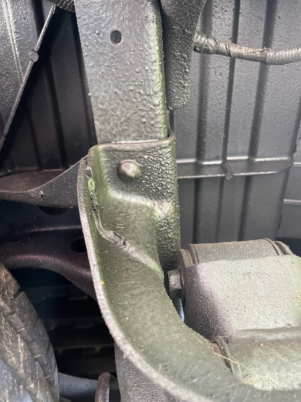

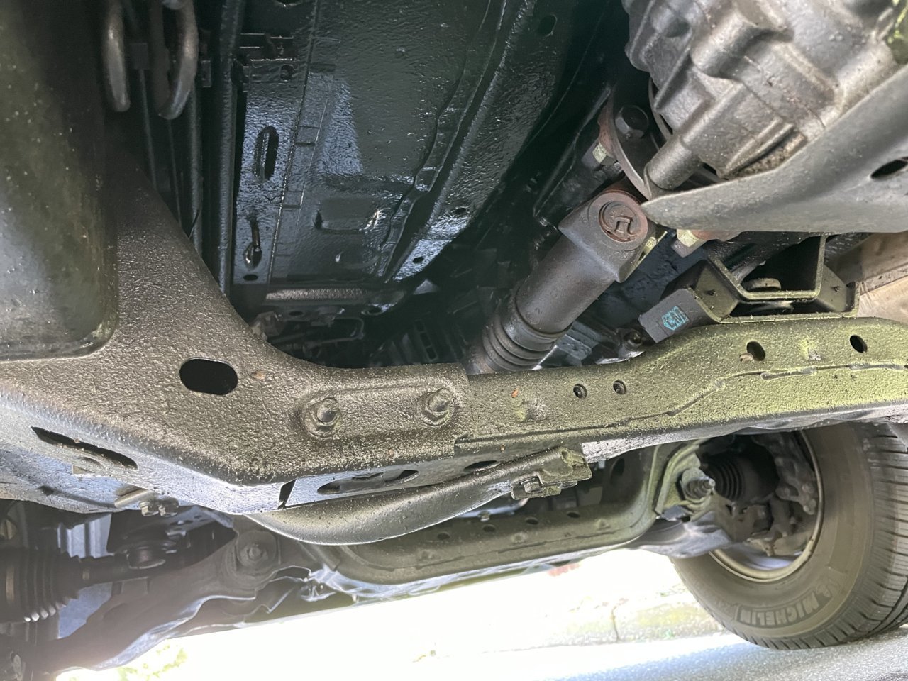

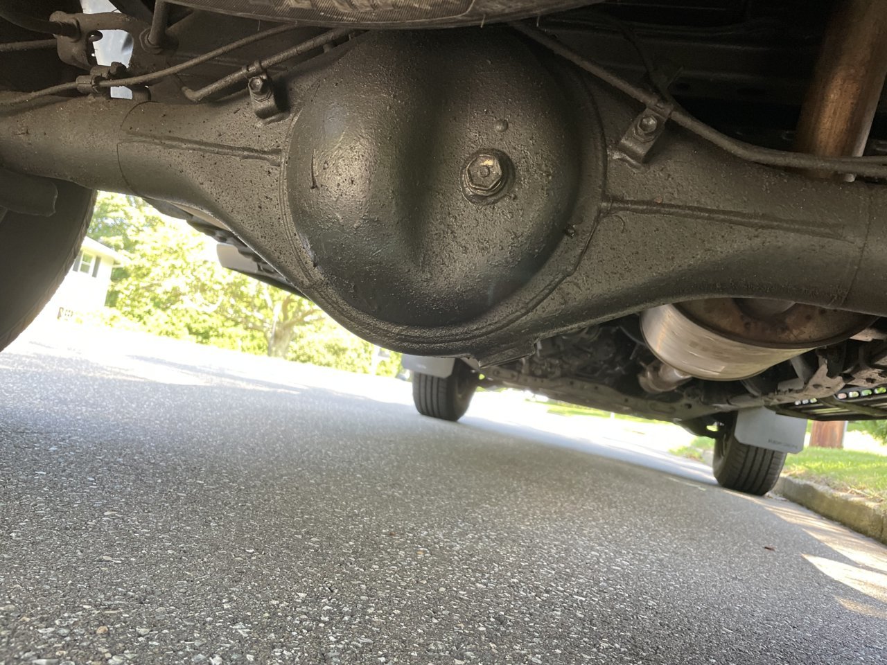

    Wool Wax. Five harsh, salty New England winters. Annual coating of Wool Wax. No rust.
    Here’s my undercarriage. 6B30CFC9-BD58-4539-ACE5-4078CD37F552.jpg 0C928911-5E1B-49C3-B577-4E96AA5AC8D7.jpg
