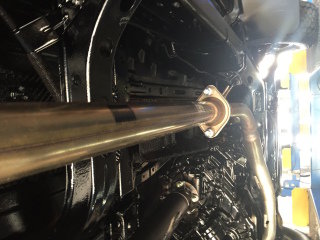

    Edit:
    Sorry about the sideway picture upload:

    Updated my reply with a picture!
