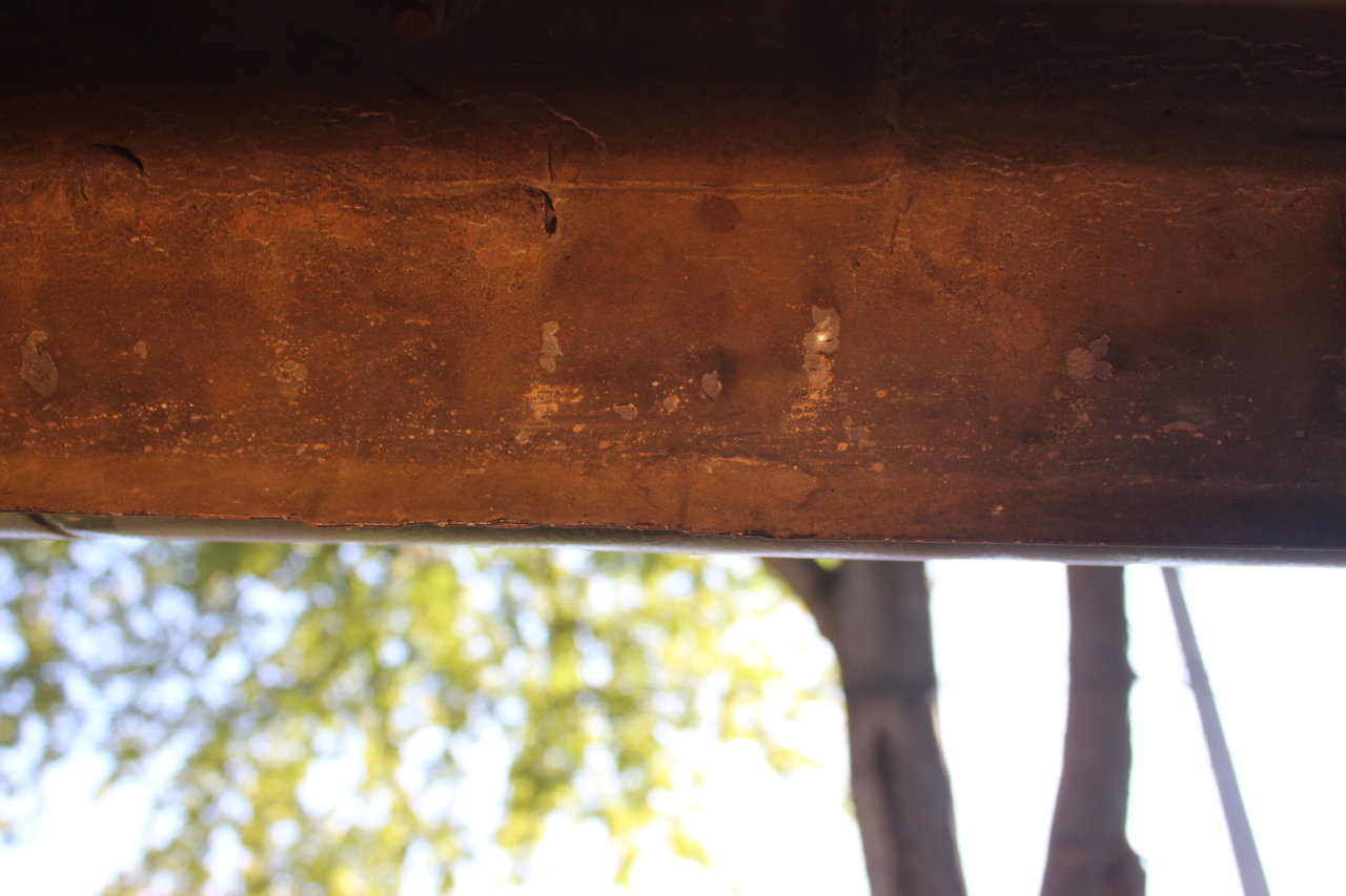

    this is my rockers on passenger side under halogen light
    can you see the chipped spots?
    i really don't know what to do about this
