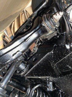

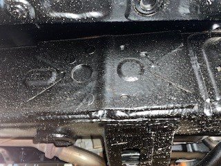

    So.... I bought a 2020 TRD Offroad about six months ago. It looked in great shape and had just about 10K miles on it. The truck came with an underbody rust protection already applied. After reading through this thread, I looked under the truck more in-depth than I have in the past, and it looks like the treatment applied is the hardened rubberized crap, not something like Fluid Film or Cosmoline. (I've been focusing more in the engine bay with electrical projects than under the truck at this point)
    A couple of pics (granted not great pics) are below. The light brown "specs" are from driving through a mud puddle over the weekend and not having time to do a full wash-down yet.
    The question is how f'ed-up is the frame with this crap on it? Should I be looking at a process of spending hours under the truck (I don't have a lift) scraping / wire-brushing that shit off and doing a proper rust proofing?

    Idk, i've seen some shops using those bed coatings on the frame for rust proofing which could be bad to. I would think you'd have to sand blast this stuff if you need to remove it. I really wouldn't know what to do if i saw a chassis that had be coated with that rubberized crap.

    This is purely my opinion, and with mine or anyone else I'd talk to at least 1-2 people who work in the industry before you make a move. First thing I would expect is that the rubberized stuff is only on the outside and easy to spray areas. Not in the frame tubes sections, or body cavities which is where it's perhaps the most susceptible to corossion. Those areas are commonly treated with cavity wax that will creep into the nooks and crannies. Even with rust it's not going to hurt and will slow it tremendously, and prevent acceleration. Next, I'd look for areas that look compromised and only scrape those off to get to the metal, and treat it from there. Product of your preference.
    By the way, what I can see in the photos looks fine. I wouldn't be super concerned about there being anything serious going on at this point. But if you live in the rust belt sates you may want to look into this more if you have long term intentions for keeping the truck.

    Thanks for the response! I'm leaning towards keeping an eye on things and if it looks like there is something going on, then breaking out the wire brushes and sandpaper to cleanup an area. It looks like the previous owner barely drove it (less than 10K miles in almost three years) and from the condition of the paint / exterior, had it garaged and not parked out in the elements. Will plan on spending some more time under the truck this weekend to do a lot more detailed visual inspection.

    Michigan is as bad as any rust belt state. They get winters similar to ours. Op will probably be a slave to that trucks underside repairing chips in the coating. Maybe this type of coating wasn't applied to everything like all the components in, and around the front end. That would not be good.
