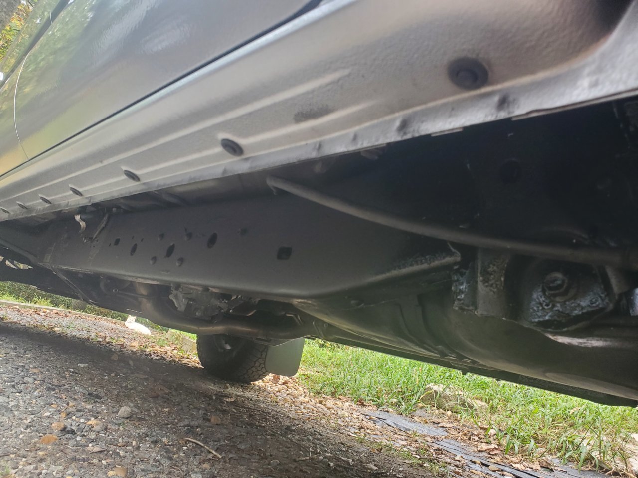

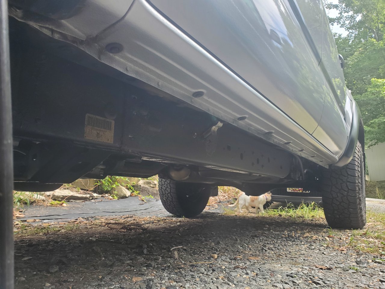

    Applied two cans as much as I could just from sliding under the truck, this stuff smells god awful.

    2 cans? I used 4 for just the hood, tailgate, and 4 doors. then another 3 quarts of a gallon can, on the underside with the pro applicator gun, my first year application. every year after 2 cans for touch up to the aforementioned panels, and 1/2 gallon on the rest . it is your investment, spray it like you dont want to pay another 40k for another vehicle due to rust, ever... or you may be one of those disappointed in the result of your application, and choice of protectant. Ski

    2 cans will not cut it. My tacoma took 6 cans of cosmoline just to coat the outside of the undercarriage. Don't forget to do the insides of the frame sections that are boxed in, and the insides of the rockers.
