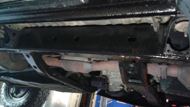

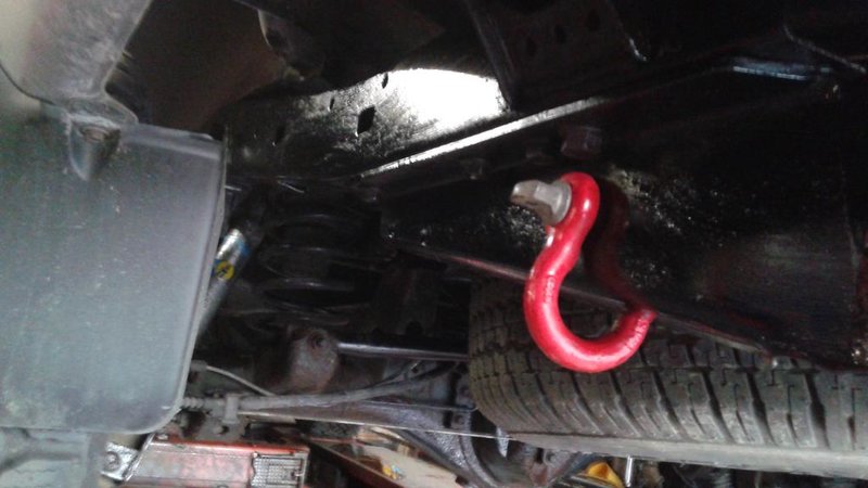

    Anybody here use regular oil on and in their frames? I shoot oil in the frame then i take a oil saturated rag and wipe down the frame by hand. I do this to both my 3rd gen 4runners and my tacoma. I also take a long extension with a oily rag and push it thru the rear crossmember so the inside is totally coated. I pretty much coat everything while i'm under there. I have a lift at work so it's alot easier with the vehicles in the air. So far no rust issues (except some normal surface rust) and even in the summer, after a long winter, i can still feel a oily residue on and in my frames.

    It's illegal, toxic, will wash off and it doesn't "creep" into small areas. Nothing beats a spray if you want to cover every thing.

    Today it was slightly above freezing so i squirted the salt off of both my 4runner's undercarriages and frames with a high pressure hose at work. After i let them sit a while i took my finger and wiped the frames and i'm happy to say i still have oily residue on the frames. The tacoma hasn't been out of the garage since october so i don't have to worry about that one. I love the snow but i can't stand it when they salt the roads!
