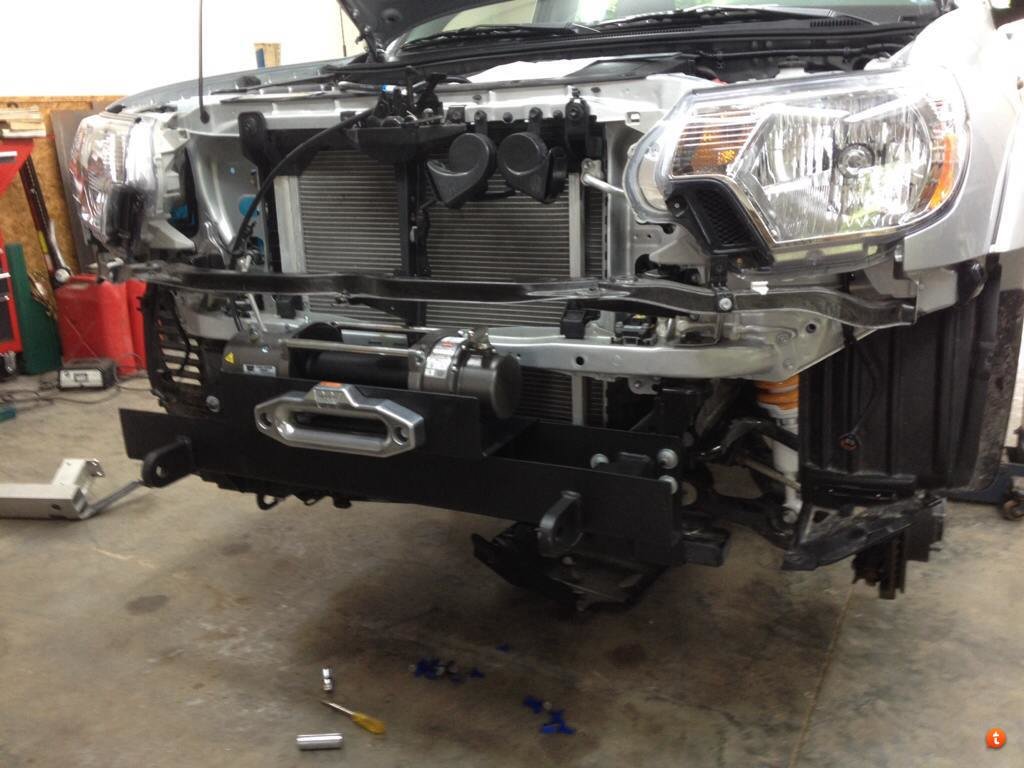

    Factory bumper off
    Undercover mount on

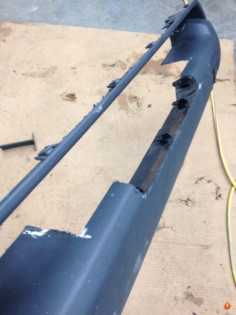

    The many bits cut off the cover and then the grill, in the order they came off

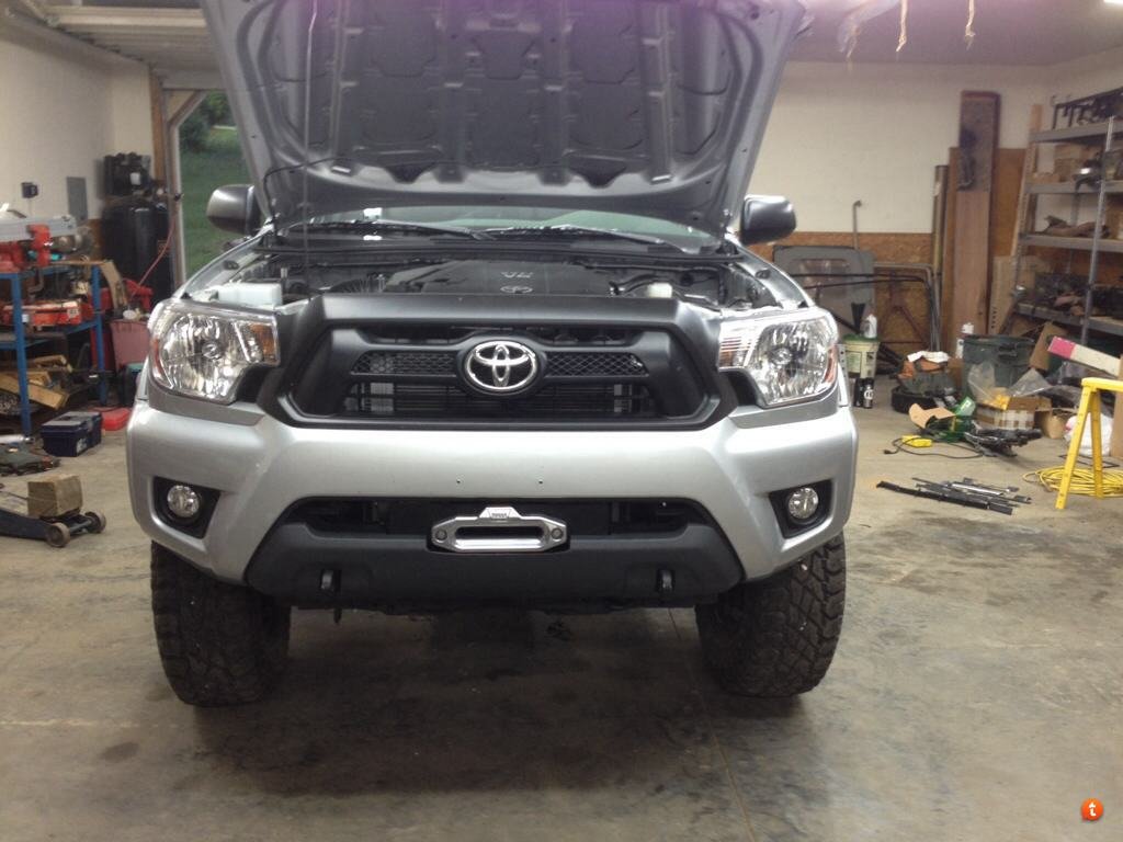

    Finished front end shot

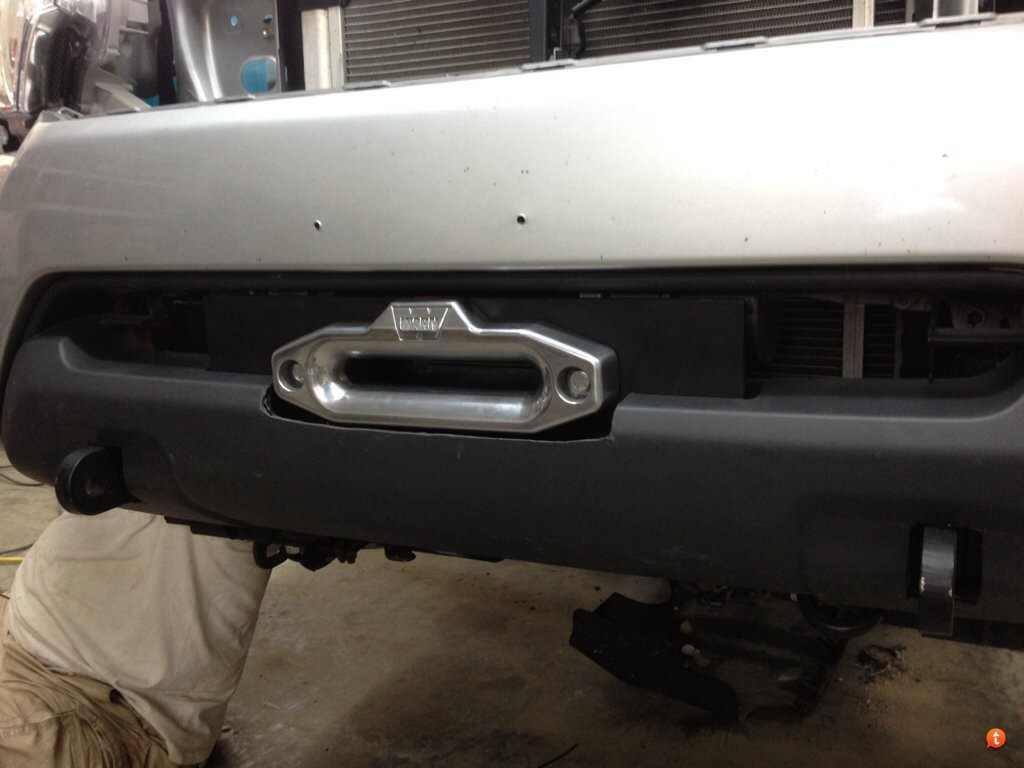

    2013 Tacoma Double Cab 4x4
    Hawse fair lead fit

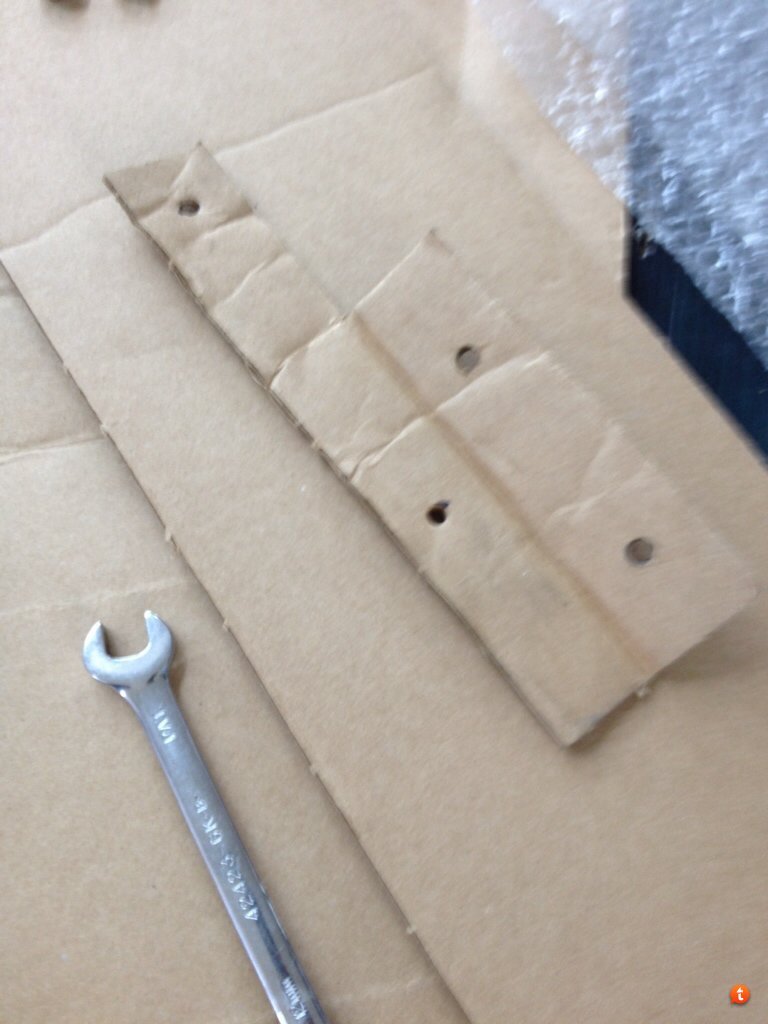

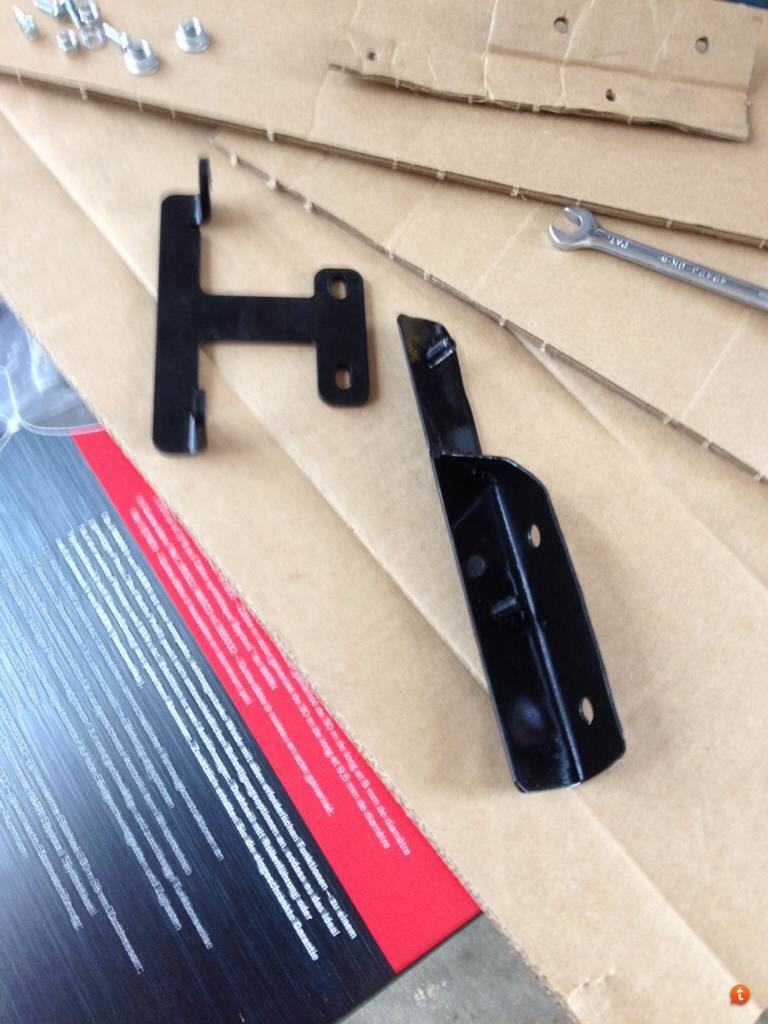

    Template for bracket

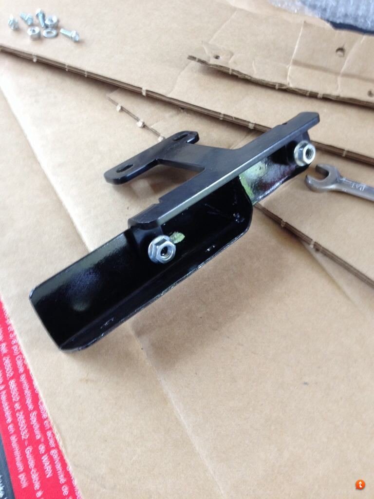

    sazyhe2e_32a2cab402af22c4f76cc5486fb0acdf62de33ae.jpgfinished bracket and warn bracket...note bolts welded to bracket....

    Joined brackets

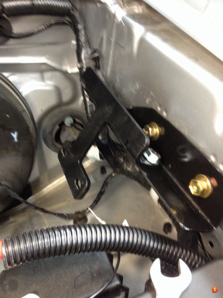

    Brackets on firewall

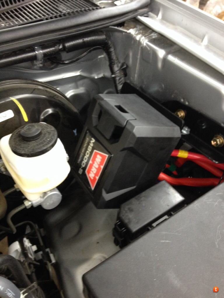

    Control mounted
