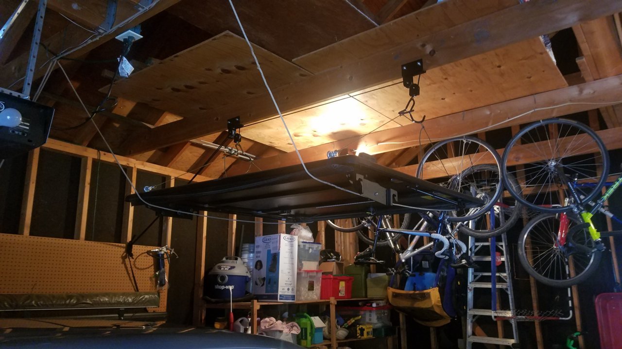

    I am still very happy with mine. I've been meaning to follow up on this one with some more info on what I have found works for mounts, etc.
    First of all, I put in a hoist in my garage to allow me to attach and remove the cover by myself. I used this kayak hoist for this: https://www.amazon.com/gp/product/B001EUL2DO/ref=ppx_yo_dt_b_asin_title_o00_s00?ie=UTF8&psc=1
    The white rope is my back up retention in case something breaks loose with the hoist.
    To attach the hoist to the cover, I used these: https://www.amazon.com/Rhino-Rack-S...keywords=rhino+rack+eye&qid=1574960824&sr=8-8

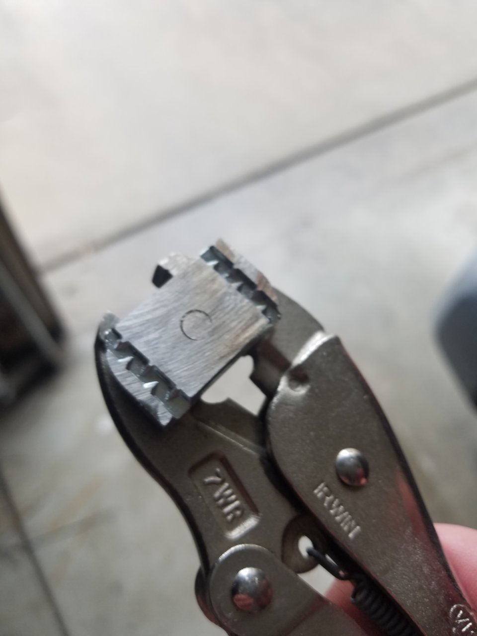

    I have fashioned my own groove blocks for the bed rails using these: https://www.mcmaster.com/3259T31
    If you search the website, you can find the above blocks for other bolt threads. These will fit lengthwise in the vortex bars, but are too thick to fit in the cover and bed rails as they come. I had to grind them down with an angle grinder to get them to fit in the bed rails:

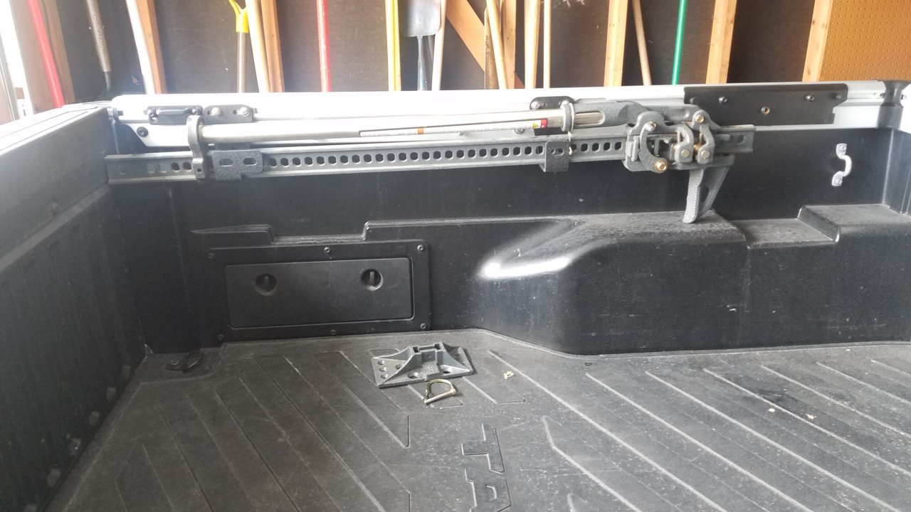

    I was able to attach a Hi-lift jack to the side of the bed using the above blocks, some hardware from the store and these: https://www.amazon.com/gp/product/B07CKL8H16/ref=ppx_yo_dt_b_asin_title_o01_s00?ie=UTF8&psc=1

    2018 TRDOR DCSB AT
    Here is a photo of my jack in the mounts. This was the only way to attach the jack to the side of the bed and still be able to close the cover. To do so, I have to take off the jack foot. The cover is obviously not attached in the photo, but take my word for it, you can attach the cover and close it with this setup.

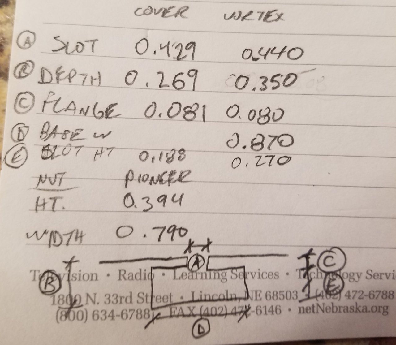

    2018 TRDOR DCSB AT
    To maybe clear up some confusion, on groove/t-slot sizes, see below for my measurements on the vortex bar and the cover slots. I also measured the nut block for the pioneer tray eye bolt I had bought before I realize they wouldn't fit.
    Vin829 likes this.
