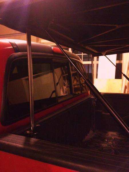

  15. Mar 8, 2014 at 10:10 PM
    Toyota Tacoma
    Toyota Tacoma [OP] Well-Known Member
    Aug 9, 2010
    #41439
    729
    Brady
    Kelowna, bc
    dbl cab long box
    Suspension: -Bilistien 5100's all around -Add a leaf -Firestone ride rite air bags Performance: -K&N cold air -Borla cat back Stereo: -Pioneer AVH-X2500BT head unit -Kenwood 1400 shallow mount 12'' sub in custom box -Alpine 1100 amp -Alpine 400 4 channel -4 energy component 6.5's Wheels/tires: -17x9 with 4.5 backspacing XD hoss rims with 33'' bfTreadwright gaurd dogs and spidertrax spacers Looks: -Satoshi grille made by myself -Hood, front bumper, grille, roof, tailgate and rear bumper plasti-dipped. -BHLM -eyelids -matted out tailights -Tacoma bed mat Small mods : -Trailer 7 pin replaced and moved into bumper beside licence plate -Removed mud flaps -Repainted frame/lower a-arms, skid and rear diff/housing with por15 -Led bulbs -Interior lights replaced with blue led's -Beep on lock added
    Frame/lift mechanism is done weoo
    Once the struts reach full length I use the ratchet bars to tighten everything up.
    Only issue I'm having is its a bit tough to get down cause its got no rack/weight on the top yet.
    Looking forward to getting the canvas on. Going to start framing the bed/storage tomorrow.
    (this is extended a bit, fits right down against bed rails when lowered)

  16. Mar 8, 2014 at 10:38 PM
    #16
    LuckyCharms
    LuckyCharms Knows a little about a lot
    Apr 4, 2013
    #101360
    182
    Socal
    '13 PreRunner TRD dclb
    Dude, That's badass. Good job so far! Is it stable at the rear?

    Thanks guys, yea its stable once I ratchet tighten it up. I can lean pretty hard into it without any sign of failing.
